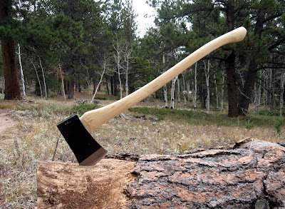

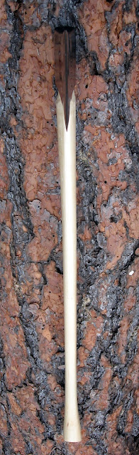

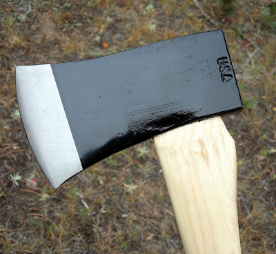

While pondering purchasing another Swedish axe purchase and doing some more online reading and research,
I came across a Council Tool Boy's Axe US Forest Service Edition and at $29., I just had to snatch it up.
First, since they are supposedly now discontinued and going for $40. everywhere else, it was a no-brainer.
It'll buy me some time until I can find another axe for bushcrafting work. Opinions on it?
http://rockymountainbushcraft.blogspot.com/2012/11/quick-review-council-tool-boys-axe-us.html
http://outdoorenvy.blogspot.com/2013/03/comparison-council-tool-fss-boys-axe.html
Yes, If those are your choices it should be a no-brainer. I know it would be for me, at least.

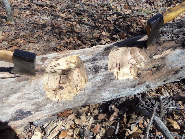

When and why, besides carving, is a flat cheek better than a convex? Im starting to form my own opinion but I have seen precious little actual testing.
I think the convex cheeks really shine when it comes to real chopping with full strokes (splitting also). Out side of that, the first 1/4" to 3/4" of the bit is the most important part. I've put "scandi" type grinds on American hatchets with thick high centerlines, and they make fine carvers. At the same time, a flat cheeked European axe with a thin profile but a thick final bit (think Wetterlings) can be a pain in the ass. There are other interesting things you can do with the final edge. One of my favorite carvers is a fairly thick Kent pattern hatchet from England. I put a long, slightly convex bevel on the "inside" edge and a short, steep, flat bevel on the "outside" edge. It's fantastic.
Well that's by far the main advantage. You could argue that the biggest use of an axe is for wood processing (chopping and splitting) and since a high centerline convex helps with that, it's automatically superior. But in all honesty, I haven't found a flat faced boy's axe (my GB Scandi) to be very lacking for the wood processing that I do (I know its limits) and haven't found the sticking all too terrible. The GBs also have a pretty thin bit and I've found that it penetrates very well into softwoods (the majority of what I use for firewood whilst camping). I also use my smaller axes (boys axe and under) just as much for carving/shaping as for wood processing and their lighter weight, thin bit and flat face really help with that. I'd say that this is why the GB SFA and Scandi appeals to the bushcraft crowd so much - pretty good jack of all trades design in a lightweight package.

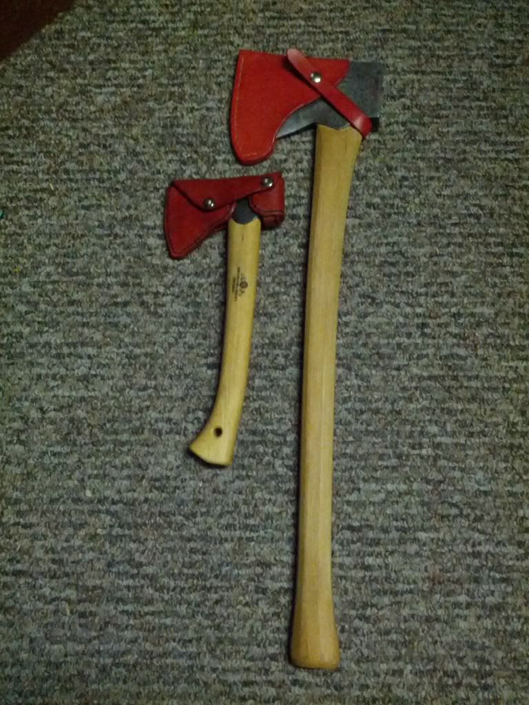

As for me, I finally admitted to myself that one axe wasn't sufficient for my needs. So I actually bring along two: one for the belt (a flat faced GB wildlife hatchet) and one for the pack (a USA made Keen Kutter Jersey with a slight convex centerline).
KK,
I came to that same conclusion myself this afternoon while ordering the 2nd axe.
If I can't find something like that Wett Fine Forester's Axe, then I'm just going to
go ahead and get a Carpenter's Hatchet for carving and something for bigger work.
Two separate tools, two specialties. And that's it. The Council with a 27.5" handle and @ supposedly 54-58RC
is probably going to be the ticket as my workhorse while the "other" axe (whether I get lucky and get my hands
on a Wett FFA or a GB or Husky Carpenter's Hatchet) will be for the bushcrafting tasks.
