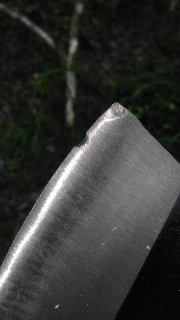

It looks like that edge chipped, Is that correct?
Definitely chipped. In fact, the edge is jagged. Wow. It looks like I tore into some white oak. :o
I think I lost at least 1/32th of an inch from the one section where the edge is still in an original state.
Ninja Edit:
Turns out that my suspicions were correct. Wetterlings ships them sharp, but not for hardwoods.
So, after a little research, it seems that this isn't uncommon for their smaller axes to nick with a factory edge.
Anyway, I'll hit it with the file and puck and see how it turns out. I'll get it back to sharp again, but I'll save
the brutal work for the Council for sure.
Update:
Stropped it against an old belt to get the major burrs off. Ran the file against it about a dozen times each side.
Boom...nicks gone. I worked it a little with the puck and finally the DMT 1200 block, but only to clean up the edge a bit.
Better than factory now. I still would have some more work to do to it to get it "perfect", but as is, she's making curls and
I'm sure it has a much sturdier edge now for splitting & light chopping.

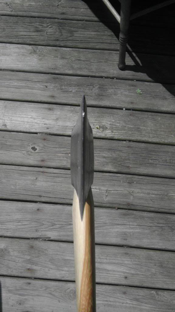

I dont know what a realistic edge is but that looks pretty fat to me and I would say its more fragile than it should be so I assume it was burned while sharpening at the factory. I would cut away the edge put a fresh one on and keep the angle it came with, test it and if it dont hold up for the work then maybe increase the angle.
I'd have to disagree - to me it looks a bit too thinned out from factory. I'm talking about the actual edge, not the thickness in the checks. If you look at the actual profile, it looks to have a very flat, only ever so slightly convex grind that terminates at something like 15-20 degrees. Too fragile to hold up to real chopping without a more substantial convex. I know people had the same issue with the Les Stroud bushman axe which is fairly similar in design.
Either way though, the answer would still be the same: sharpen it up at higher angle, forming either a secondary bevel or a thicker, more convexed edge.
Disagree with what? My assumption would be that the edge was burned at the factory. To test this I would remove the factory edge, sharpen it at the factory angle and do some work. If it behaves the same after what I assumed was overheated steel is removed I would consider the possibility that the edge is to thin.

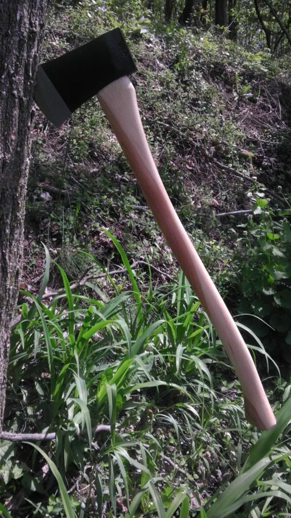

The Council came in. Had a nick in the edge, but that was really about it.
Overall, in decent shape (especially for $29.). I worked the nick out of it
already and it's fine now. I think it was a good deal. And I got one of those
nice two-tone handles. I don't know if that makes it a weaker handle or not,
but it's going to look nice once I stain it (maybe with a dark walnut stain).
Good lookin' axe. That's a shame about the nick but it wouldn't be a big deal to hone out. And for $29 I'd sure keep it.
