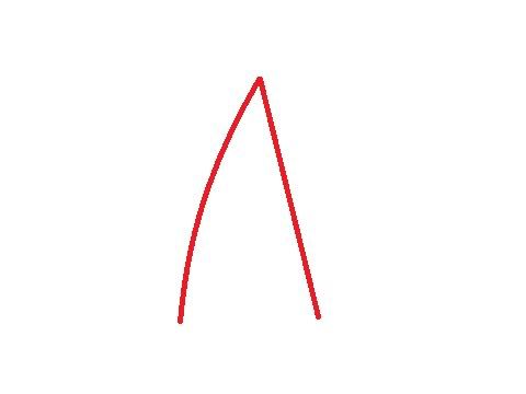

..I put a long, slightly convex bevel on the "inside" edge and a short, steep, flat bevel on the "outside" edge. It's fantastic.

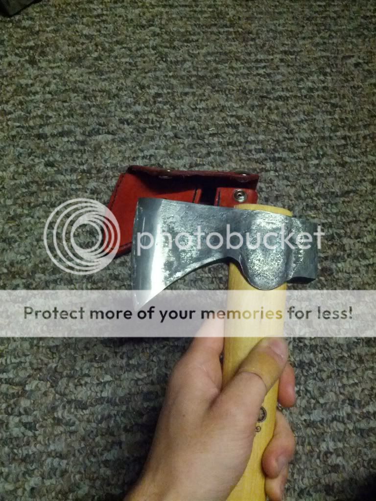

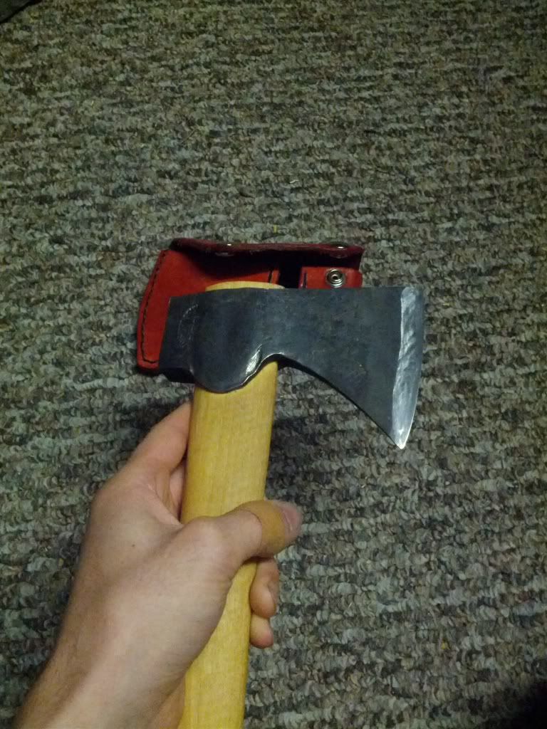

I completely forgot to reply to this. I'm not sure if this is what you meant, but it's actually the type of edge I put on both my SFA, my Wildlife hatchet and what I'll do with my Mini when I get around to it. A flat scandi grind on the working side and a convex on the other to offset the thinned bit (I'm left handed btw, so the sides would be switched for a righty). Makes for an amazing carver that is still capable of lighter axe chores:
Working side:
Opposing side:

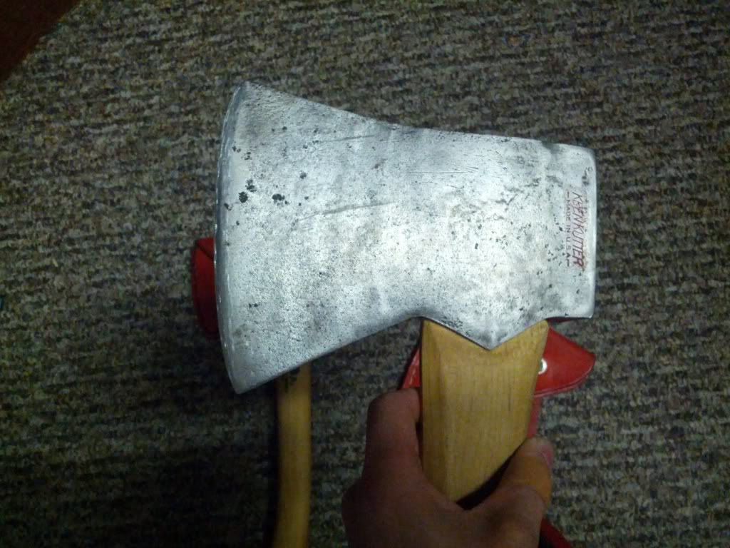

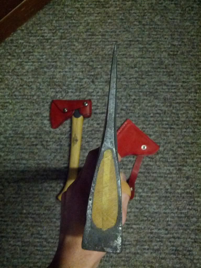

High center line?
Just got this hung a few minutes ago, I think it is around 4lbs, I have its little brother(hatchet) around some where.
High center line?
What brand axe is that? Got a pic of the little brother?
I have a house axe with similar cheeks which I've never been able to identify.
High center line?
Oh man, I'd love a Jersey with those sort of bevels. IMO, looks nicer than the True Temper or Council type bevels - not so blatant a transition in the depth and a better overall shape.
