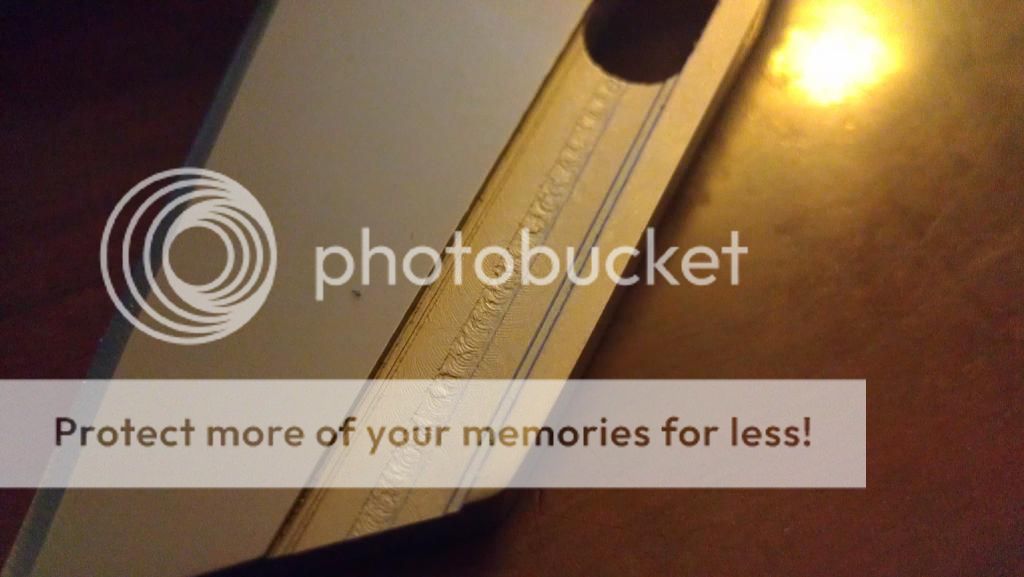

Seven Mill lines and what ever you call the skid mark down the middle
Something pressed texture into the milled flat area

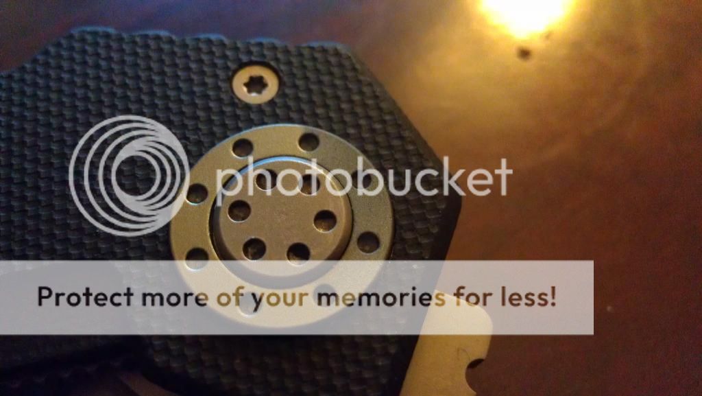

Washer is discolored and has black stuff in the pivot holes

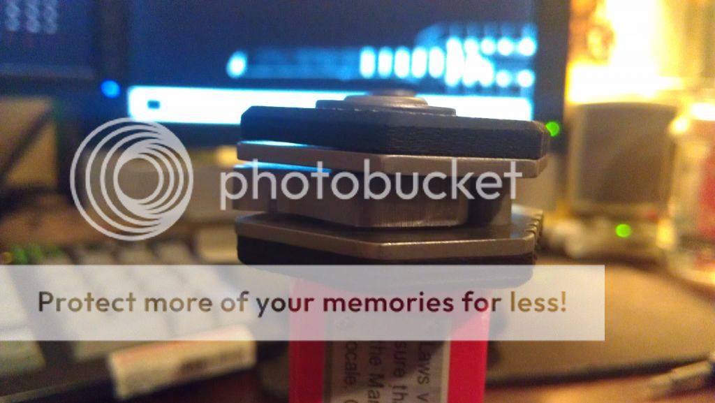

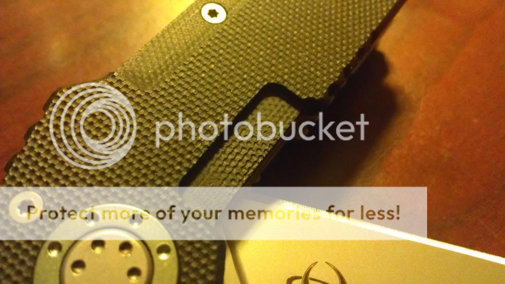

I could live will all that, but the liner and scales have gaps and are not straight
You can see at the top the washer is higher on one side on the pivot than the other

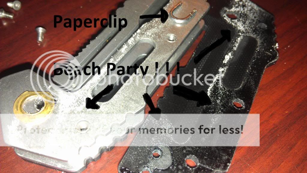

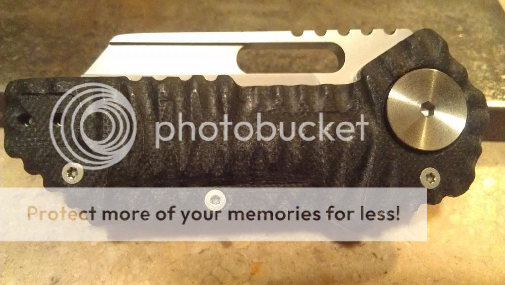

I use a paperclip and pliers to remove the 6 pin pivot screw.
There is a small gap around the pivot screw, where the washer was a little bigger. Makes it look off center in the pics but in person, you see it is perfectly centered.

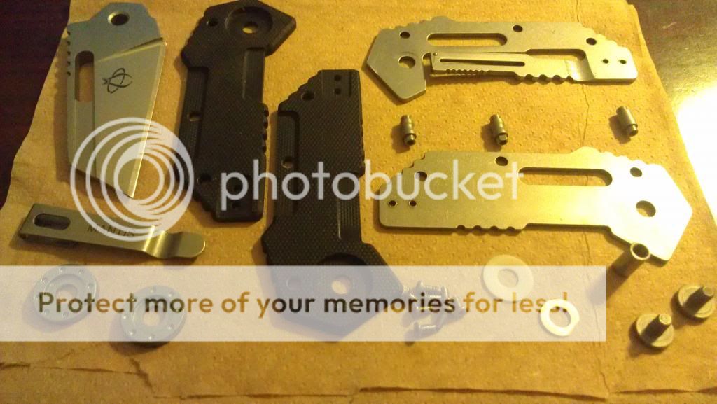

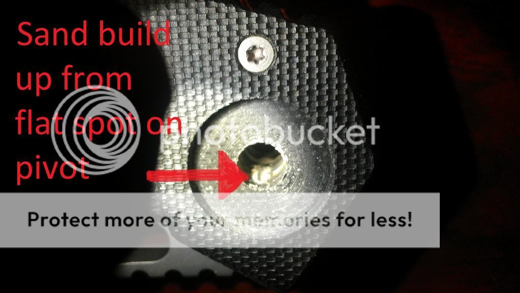

Guess I got someones return, it came in a plastic bag in a box.........filled with sand. So with the help of some screws I took out of an old Emac G4 pc, a bunch of cleaning off locktite and my trusty dremel I made it MINE. It's well built for the $42.99 I paid, it's a TANK, non-lock side has flat spot holes that hold the spacers, pivot and stop pins in place. At the end of the video you see how smooth it is now. It free falls open with some help of shaking even though it's a little heavy for it's size but yet I can still flick it open with my middle finger using the milled out area. Just feels smoother in the hand and you don't have those damn washers that spin !

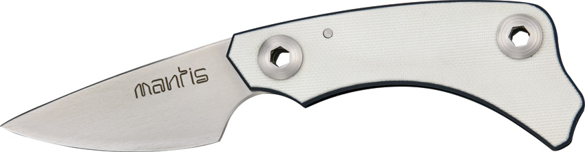

Well, boy did I f**k up! I bought the Mantis MSR-3.
I thought I'd give Mantis/Famous Trails the benefit of the doubt. I gave them $40 for this knife, and I'm pretty sure at this point that I wouldn't even take it for free if someone offered it to me. It was good to me for the first 5 minutes of owning it, and now I just hate it. I will never buy a Mantis as long as I live, and I pray that they go out of business. Let's go over the list of pro's and con's for this knife...

- There is no friction in this friction folder, the blade just swings all over the place
- Blade play
- Pocket clip moves around
- White "G-100" handles get dirty really fast
- The bolt pivot is stripped from trying to tighten it (according to Mantis's customer service instructions)
- I paid for it
Here are the stripped bolts, they are much worse now.
Have you taken a magnet to those bolts? Many chainring bolts are aluminum and the heads strip out if you even look at them wrong. If the factory ones are alum., assuming you can get them out, measure them (I'd assume metric) and get yourself some stainless ones.
FWIW, those aren't really chainring bolts/nuts. They're two chainring bolts that thread in either side to a threaded bushing. The bolts are usually too long (they were on mine), which means they bottom out against each other before they can get tight enough for the friction to engage.
I'll have to try to get some pics of mine tonight... I got the CF-scaled one, which came with a red anodized spacer. I took out the crappy bolts, and replaced them with matching red anodized *real* chainring bolts and it's awesome now. The length of bolt is for a double-crankset (I'm a cyclist so I had a few lying around to test).
So my advice would be to strip off those bolts, go to your local bike store to get some cheap double-crankset-length chainring bolts and install those properly and you'll be gold.
