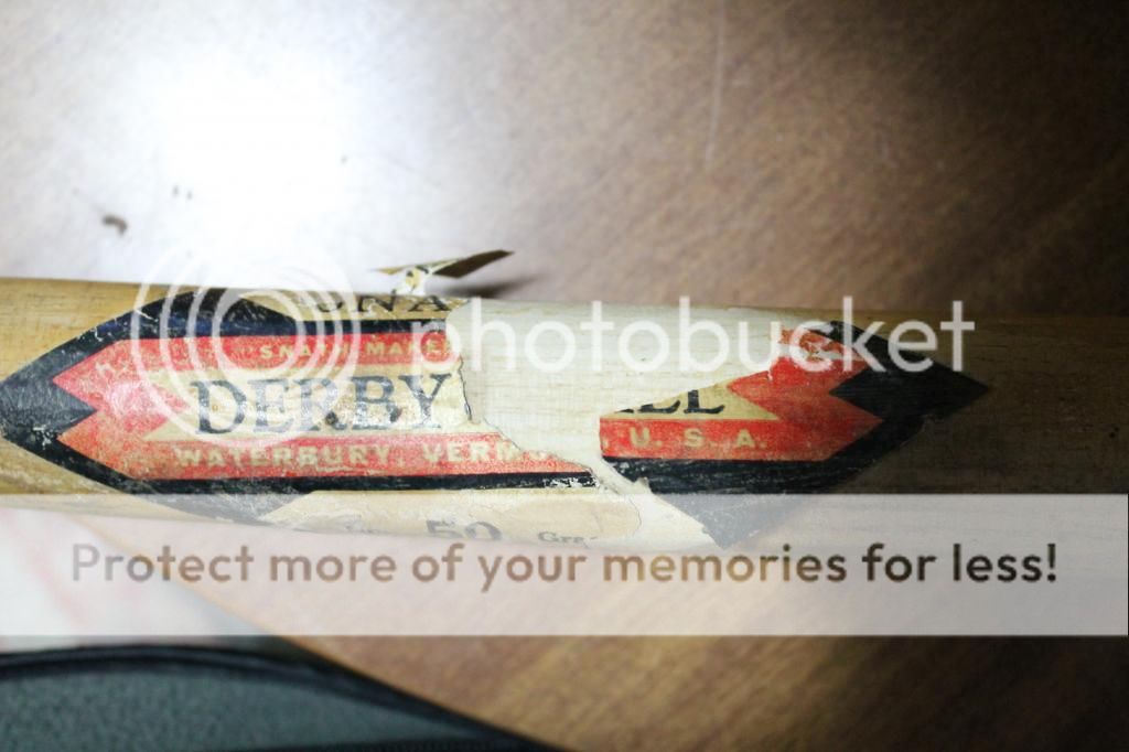

I think I may have finally solved the mystery of who made my snath. I suspect it to be a Derby & Ball. I just picked up a scythe from a fellow for $25 that has a badly warped blade (probably not fixable, but I'll try!) but the snath is quite solid still and I think it'll clean up nicely. The really nice thing about it is it has most of the original paper label on it, identifying it as a Derby & Ball #50 snath. The mounting collar and nib hardware are a little different than what's on mine, but the adjustment mechanism for the set of the tang is identical. I think that this new snath is probably later production than mine is, but of the same lineage.
Finally managed to snap the photos of my new old snath. :D
The original paper label. It was flaking off badly and was very brittle. I carefully removed it after snapping these photos for possible preservation.
The mounting collar. Note the absence of a shelf or lip to brace the blade and the fact that the collar is a formed and welded piece of sheet metal rather than a steel casting. Cheaper to make this way. The overall more crude manner of construction leads me to believe this is fairly "recent" production all things considered.
I didn't snap photos of the nibs, but they feature a square embedded bolt, aluminum collars, and the steel of the loop is rectangular in cross section rather than the rounded "D" shape of most older production nibs.
All in all this is still a fine quality snath but seems to me to be an economy model from around the time of Derby and Ball's sunset years. I plan on sanding off the ugly yellowed varnish and giving it a good liberal dousing of Ballistol, as well as scrubbing the rust and dirt off of the steel components.
The blade that came on it was moderately rusted but severely twisted and arced. It's a soft enough blade that I was able to bend it back straight and angle the tang by locking the blade in my vice and sliding a pipe over the tang. There's a very faint maker's mark on it but I haven't had the chance to clean the dirt and paint off of it yet to see if I can make the stamping out. Might make a good beater blade around rocks and stuff given how soft it seems to be. Well formed toe to the blade but it's otherwise unremarkable.
