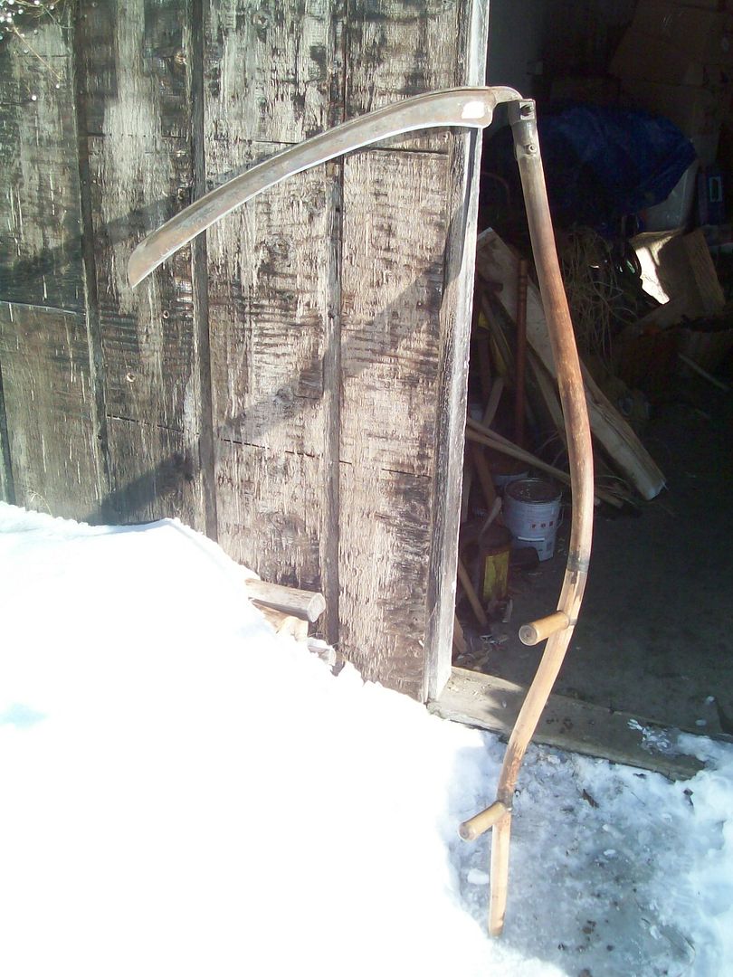

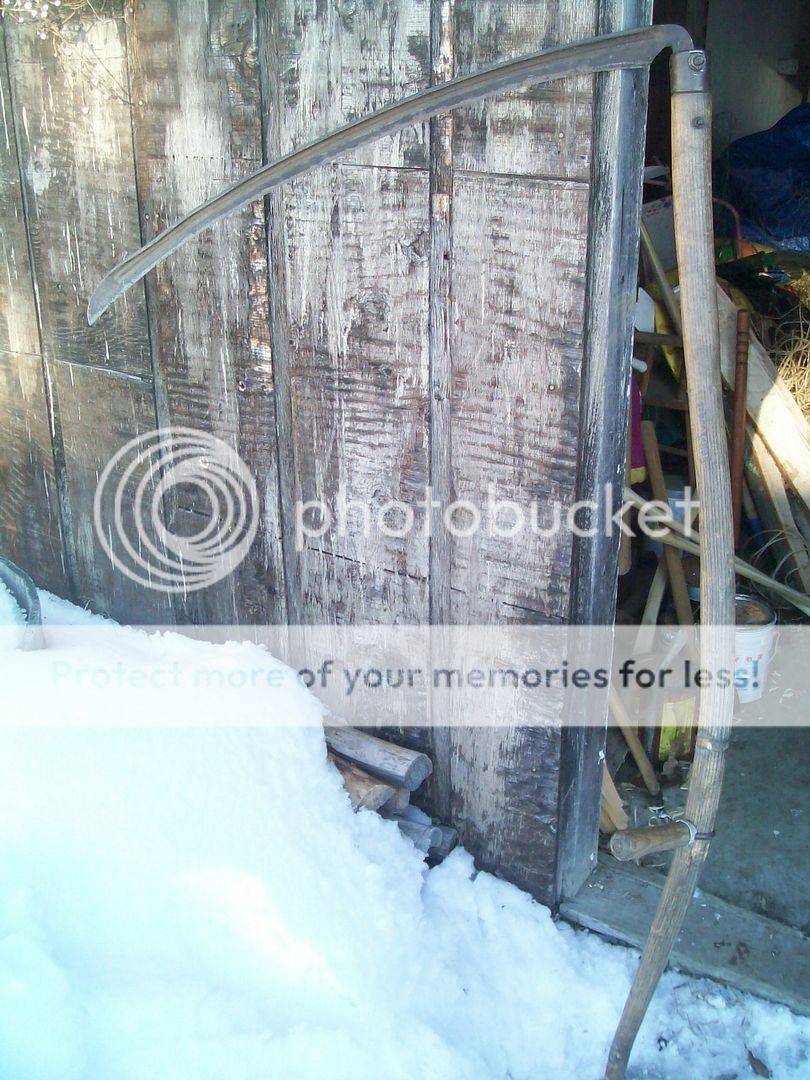

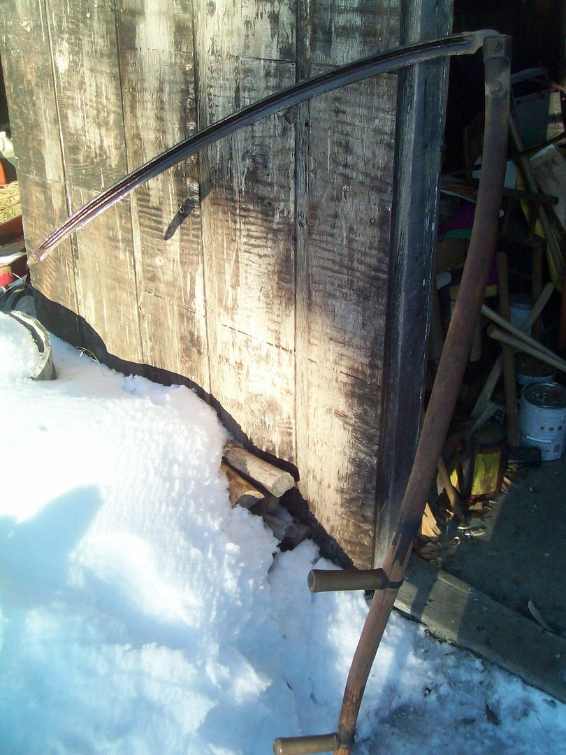

These are the scythes and some of the blades I picked up yesterday in a craigslist deal. Usually dont use CL but this guy was a good irishman and courteous so it all worked out.
this is the one I was most excited about;
Thats a later Kelly Dutch pattern blade on a Derby & Ball snath, I think. The snath is super, despite needing a bit of sanding and oiling and some new nibs. Its very light, as opposed to my Seymour which is well made but a lot heavier.

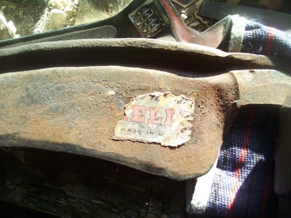

42 asked for a label pic, so I snapped this pic of what remains of the label;

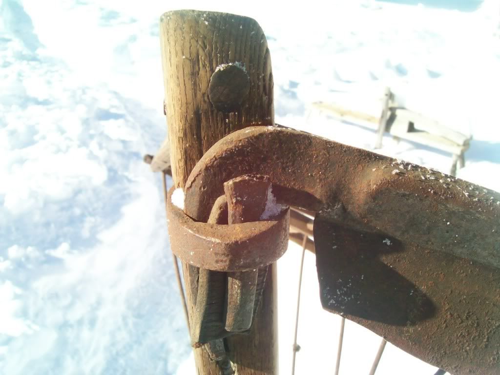

Heres there swivel attachment mechanism, which is sweet. I think these are probably the gold standard and I yelped when my hopes were realized that it would have this very set up (I never saw a picture of the attachment rig when I bought them).

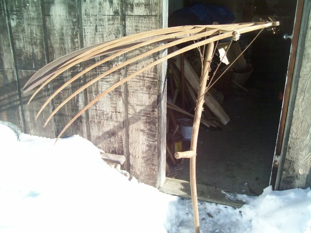

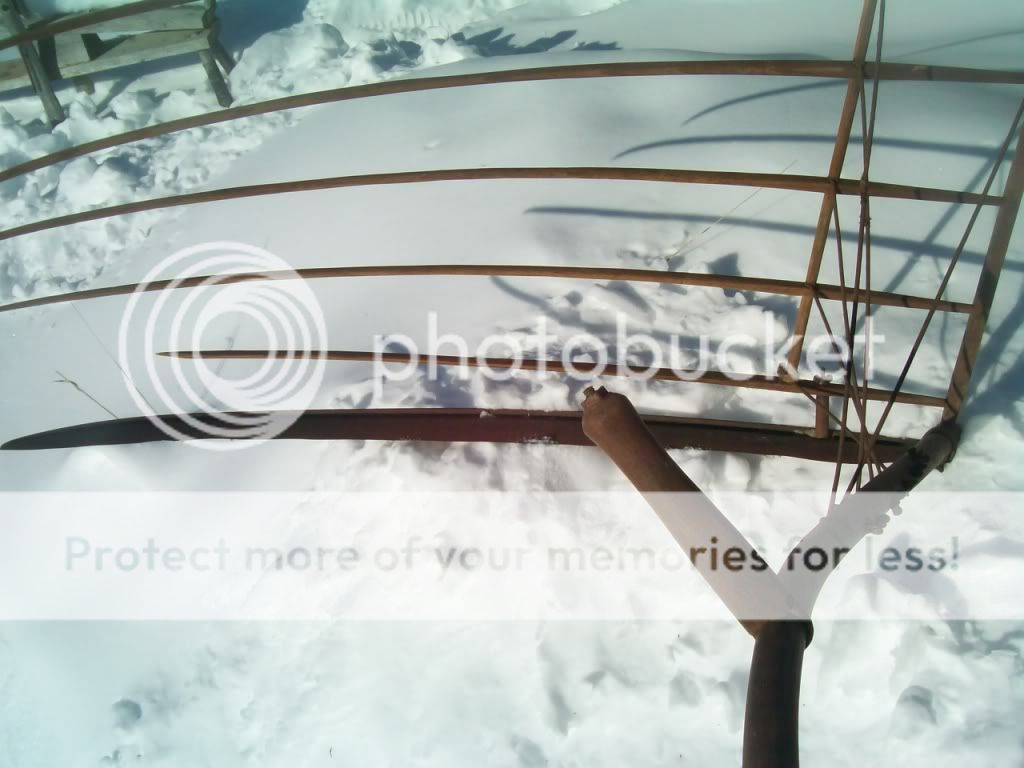

I also got 2 grain cradle scythes, although I only pic'd the one in better shape. My brother is into no till no machinery farming, so these may see use harvesting grain some day. mostly for posterity though. Its really beautiful with most of the original work. weighs about 10 pounds it feels like.
Really pretty to look at

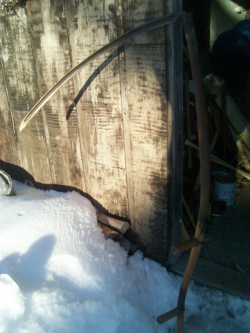

Old style hafting rig, which really hit home with me. I love this.

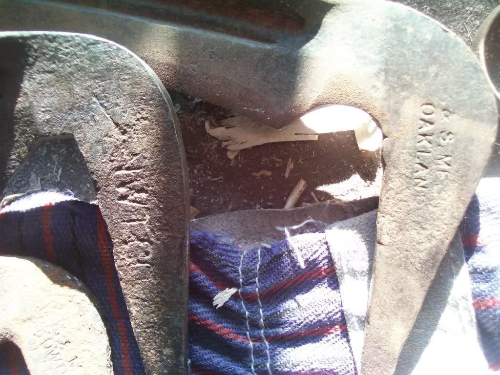

The biggest thing I got out of this deal though was a better understanding of scythe blades in general. there was an Emerson & Stevens grass blade that was bent, as was the kelly. These are not names to scoff at. I have a North Wayne Tool co blade that was bent when I found it. I thought there was something wrong with the blades, not looking at my own skill and know how and not changing my cutting practices. I think its all about when we cut the grass, if we let it get tall and woody and bent over it goes from a joy to a sweaty drudgery. Most of the blades cut fine. The video I posted a while back was mowing fresher lush greenery with a blade I would have considered "bad". Its a lot more refreshing to realize that I am at fault, rather than not being able to find any good scythe blades. These will suffice.
Emerson & Stevens and NWT CO (found in my shed an didnt recognize until I looked at it again today)

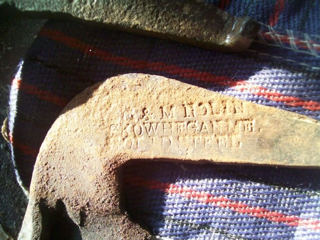

This blade is marked Skowhegan, and a bunch of other stuff I cant read. Maybe someone else can recognize it?

Nolin, G. & N. Skowhegan -1879-1899-
Tools Made: Farm Tools, Scythes and Sickles
Remarks: It is not known if G. Nolin and N. Nolin worked together, however they were both listed as scythe makers in 1879 and 1885. A 23 Feb. 1886 patent for a grass hook was held by G. Nolin, who may have also made that tool which was listed in 1899 for sale. In 1901, a Nolin Mfg. Co. made scythes, grass hooks, hay knives, etc. in Skowhegan, but what involvement (if any) either Nolin had in this company is not known, as a George Underwood was listed as its president. (DATM, 1999). G & N Nolin is listed in the 1879 Maine Business Directory. G. & M. Nolin is listed in the 1881 and 1882 Maine Business Directory; possibly the M is a typo?
Awesome snags! The North Wayne Tool Co. was the maker of the famous "Little Giant" line of scythe blades, and that Derby & Ball snath is one of the older ones like my nicer one is (not the recent one I restored recently, which is a more recent example.) The Kelly blade has a beautiful shape and the toe of the blade is still nice and crisp! Looks like the Skowhegan blade was by G&M Nolan. Doing a quick search on Skowhegan history I've stumbled across several excerpts like this one:
and the Davistown Museum has this entry in their Maine Toolmakers index:
It would seem by the stamp on the blade that the M was not a typo. They weren't around a very long time--take good care of that one.
