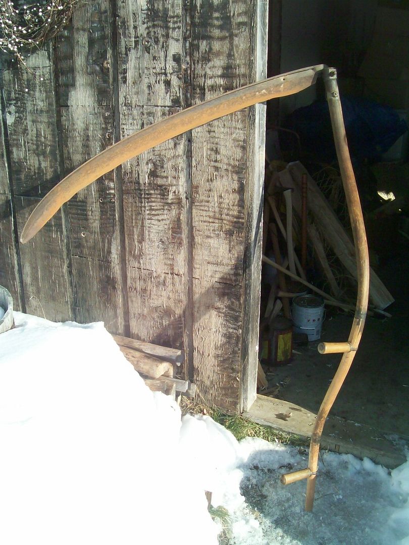

Wow that's quite the long English blade! Not a big fan of English blades in general since they have weak tangs, over-long shanks, plain webs, and "true taper" profiles. That being said, they do look exceptionally cool!I think that the longer TrueTemper weed blades have an almost ideal shape to my eye. A nicely proportioned and tapered Dutch pattern. I've seen a few Dutch pattern grass blades by various makers as well and they all have a very pleasing form to them from a practical standpoint. That flare at the heel does a wonderful job when finishing the stroke.
This is great, I think that Peter Vido would be happy to see this. The offset of the blade look good. How about a photo showing the side profile curvature?

I started another snath today out of Cherry that has more curve like some of the photos you posted. do I need an S bend towards the end of the snath to accommodate the tang? I know it depends on the angle of the tang. A steeper tang probably takes less recurve at the end right? That Birch snath didn't have much curve toward the end and it still fit the shallower tang relatively well, with a little beveling on the end. Not sure how well it will work in use, we'll see I guess.
As shown in this photo, the snath curves downward to the right of the right grip (which helps to level the two grips in use).
Is it kosher to obtain this levelness by elongating the shank of the lower grip so it rises up higher?
The shank (or "stem") of the lower grip helps make the grips level in use, but if the stem gets too long then it causes problems with control during the stroke.
A stem on the left grip, though, is not recommended, because it would make the two grips less level, and it would not give as good control as "zero stem" (direct attachment of the left grip to the snath).

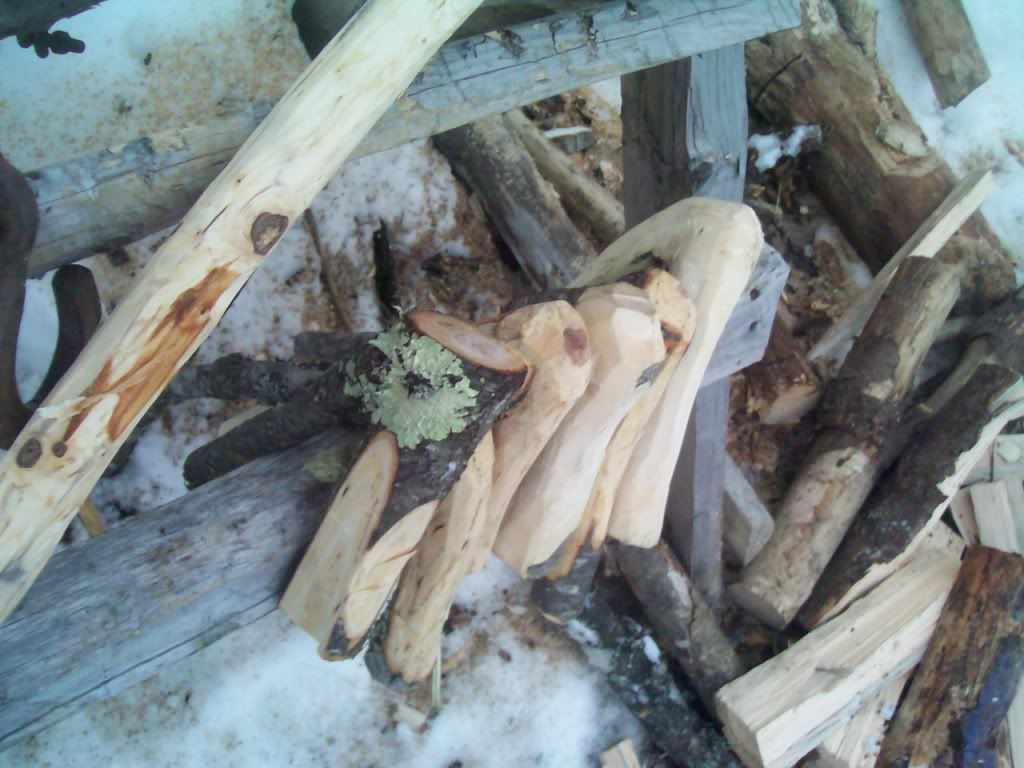

...Made a few trips out in the woods cutting grips off of blow down trees. These is so fun to make...
I'm going to have to start offering free snaths to people with blades and crappy production snaths to get these things out of here. got some staves cut for snaths and more grips out in the woods I need to go get.
Can't beat free material. :thumbup:
As you find good materials for wildwood snaths, just stockpile them until ready to custom size them, like Peter Vido does.
