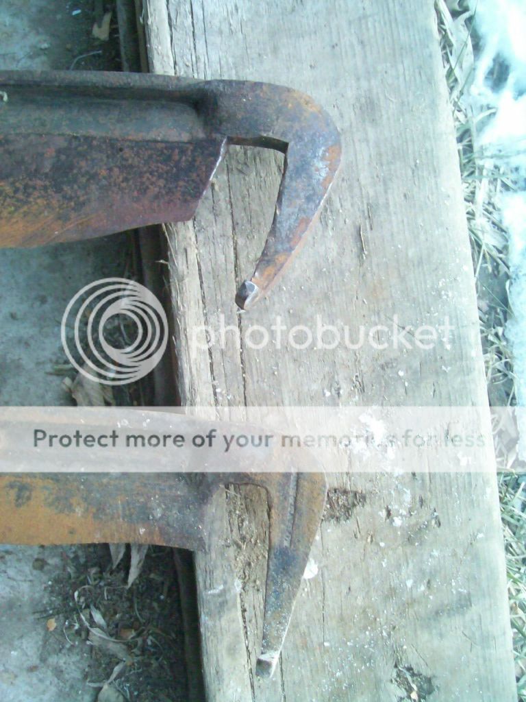

Here's the tangs of the two English blade I got. They look stouter than yours 42. They are fairly thick as well. the 46" one is the one with the closed in tang, for obvious reasons. That thing with require a seriously closed hang to cut easy.
Yeah--looks like the original owner actually ground away the heel of the blade just for snath clearance because of how closed they modified the tang! :eek:
