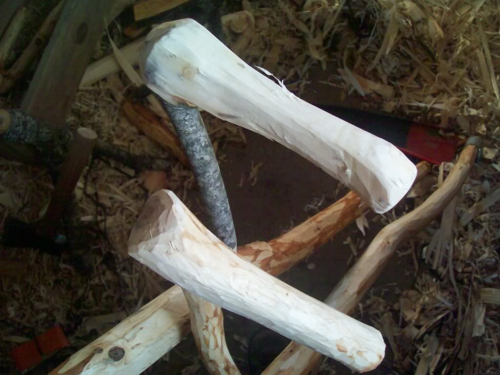

The bottom one is a cherry grip, I find it a little too round and will shape it accordingly once it dries more. The Maple grip is more ergonomic despite not being finished yet. Its too wet to rasp or get any sort of finish on without fuzzing up or tearing out.

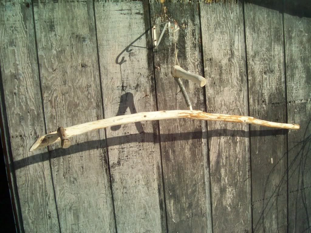

Steve (or anyone for that matter), would you say this snath is too top heavy or just right? I told myself I had to wait until I got more blades before making more snaths, but I caved last night. I think this one might need a blade with a steeper tang? not much opposite curve towards the end of this one. Should be pretty when it dries more, Cherry snath with Maple and Apple for grips.

Thanks for the tip on the grips. I've been cutting more with a regular sized shank and way oversized grip so I can shape the grip with more flexibility.

That looks good to me. Yes, the "opposite curve" at the bottom is subtle on this one, but it is there, and probably won't require too steep of a tang, as long as you're sizing it long enough from the right grip to the blade (depends on the height of the user).
I suggest rotating the left grip clockwise a bit (it's just a friction fit at this point, I presume) to see if it feels better while swinging. This will angle it more toward the left, which will probably feel better when pulling the snath to the left (with the grass resisting somewhat).
The view directly from the top (not shown in your photos) can indicate a potential problem if the snath curves toward the left (in the direction of the blade tip. The grips would then not line up with the blade (a line sighted from the top hand position, and passing through the lower hand position, defines a vertical plane that should ideally intersect the blade somewhere between midpoint and heel). Since European scythe blades are usually pressed down against the ground to some extent while swinging the scythe on the forward stroke, this ideal alignment would not tend to "twist" the snath in your hands and therefore would require less effort to hold and control.

In the photo, the snath was angled away from me (the small end is touching the barn wall, so as far as possible), so makes it look closer to a right angle then it is. Before the final fitting I will probably test varying amounts of splay away from the body, but the shape of the grip might somewhat limit that. I doubt it will be a problem though, this was splayed a moderate amount and I could still move it further. Further still if I re shaped the grip a little bit.
I don't grasp the physics of it, but I tried to make sure that the handles weren't exactly lined up with the tang, or worse, behind that on the opposite side of the tang from the blade. This Cherry snath doesn't have as much offset as the first Birch snath, but I tried to orient it so instead of utilizing all the curve (which was in one plane, more or less) to the downward sweep (to keep the grips more level) I could keep the forward grip a little ahead of the top grip and thus putting that "line of grip" or whatever in a more desirable lay. I knew I liked an offset axe handle, so despite the obvious differences, Peter's description of the line of grip with a snath made sense. Not necessarily in a technical way, but I could imagine the feel of it and the differences in balance.

...a line sighted from the top hand position, and passing through the lower hand postion, defines a vertical plane that should ideally intersect the blade somewhere between midpoint and heel). Since European scythe blades are usually pressed down against the ground to some extent while swinging the scythe on the forward stroke, this ideal alignment would not tend to "twist" the snath in your hands and therefore would require less effort to hold and control.

That's a good description and illuminating in terms of the differences between European and American method. Very different from an American scythe since the lower nib acts as a pivot point for a pendulum-type action and so the upper hand is positioned further away from the body to allow for greater travel as it operates the drawing (almost rowing) action of the stroke. I just went out and sighted between the nibs on my American snaths and the line created between them would intersect the arc of the swing just shy of a foot or so to the right of the end of the snath.
Don't it make a more closed hang too, aiding in the slicing motion?
By closing the hang that much, doesnt a straight pull across the body essentially equate to a pretty acutely angled slicing cut? Hence why the American scythe requires less body motion in general?
I just went out to verify it and I think you're right. A straight pull wouldn't be tremendously angled, but very little motion of the left hand generates a great deal of slicing action on the business end which, combined with the pull across the body creates a very powerful cut. When standing with the end of the snath at the 3 o'clock position and my right hand just in front of my hip my left hand sits about 3-4" forward of my right.
