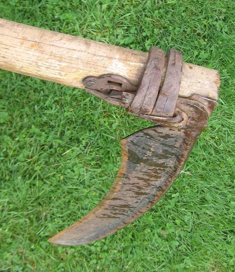

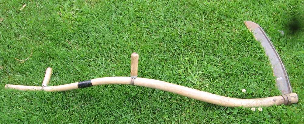

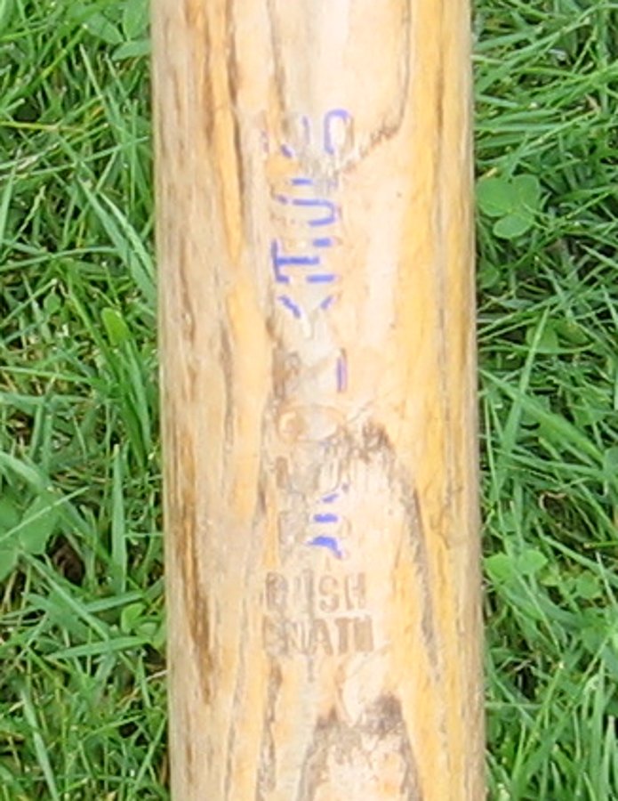

I picked up another scythe this weekend at a yard sale. It's a Seymour #100 Bush Snath. It's kind of heavy. I don't like the angle of the blade and I don't like the connection. The blade is held in the rings by 3 metal wedges that are driven in and then bent over. At least the nibs aren't frozen.
An absolute brute, that snath is! good for the hardest use, though. Not sure if those wedges are in original configuration or not but I suspect that they aren't. The wedges I usually see used for securing scythe rings (like on grain cradles) look almost like a miniature rail road spike. I imagine that the wedges were folded over to prevent loosening but it seems to me that they're driven from the wrong side.
That's what it was sort of looking like. If you wanted to remove them you could and then use wooden ones instead, if you so chose. I've heard of that being done as well.
The advantage of the double ring method of attachment is that the wood at the end of the snath is inherently strained less, which allows you to really wallop dense scrubby crap. A valuable tool to have in rotation, but obviously one that would see less use than even a grass snath outfitted with a bush blade (a combo that's good enough for most bush blade work as long as you're careful.) That would make a fine tool for ditch work, I tell you what!
