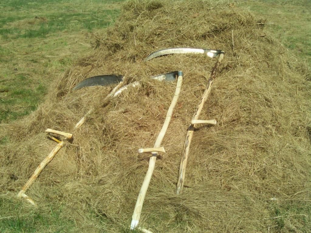

Your last three snaths are awesome, by the way. Expect for a couple of the grips, which are easy to change, I can't find anything to complain about... and neither could Peter for that matter. You passed his test, so far anyway . ;)

I wasn't really fond of any of them, to be honest. Peter wouldn't like the snath for the bearded blade (if he would even like any of them), I'm not sure if I can tweak the lay to get it appropriate for anything other than very close cutting, since the curve of the piece is not quite extreme enough. We will see, I'll get more pics of that if I can make it "work".

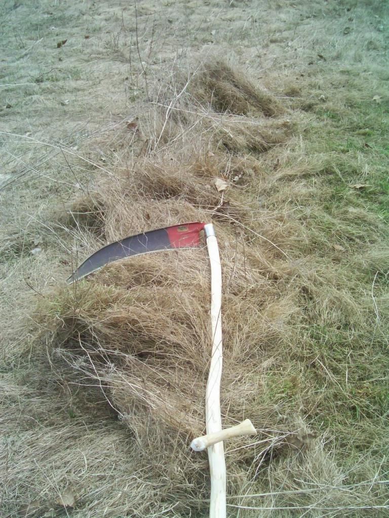

Having a little fun. Need mulch for potato beds, and need to practice mowing. Stacked functions!
Nice! Looks like the fine point did a good job getting under the bent-over stalks! :)

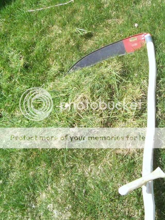

Got a little bit of mulch cut :)
Not sure the answer, really. If I use each one I get used to it, but I change the hafting angle a lot, add wedges, remove wedges, etc to alter the lay. For mowing this, there really isn't much flow to it, so the short blade on the trimming snath offers the most maneuverability and its not frustrating to not be able to utilize the extra length. They are all pretty nice, I need to tweak the luxor and snath though, The grips are a little too downward pointing, so I need to a double tapered wedge to lift the point. I think another blade with a more lifted point wouldn't have the same problem as that blade, so the non permanent wedge should be a quick fix.

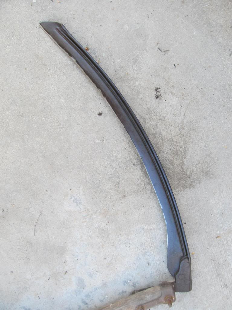

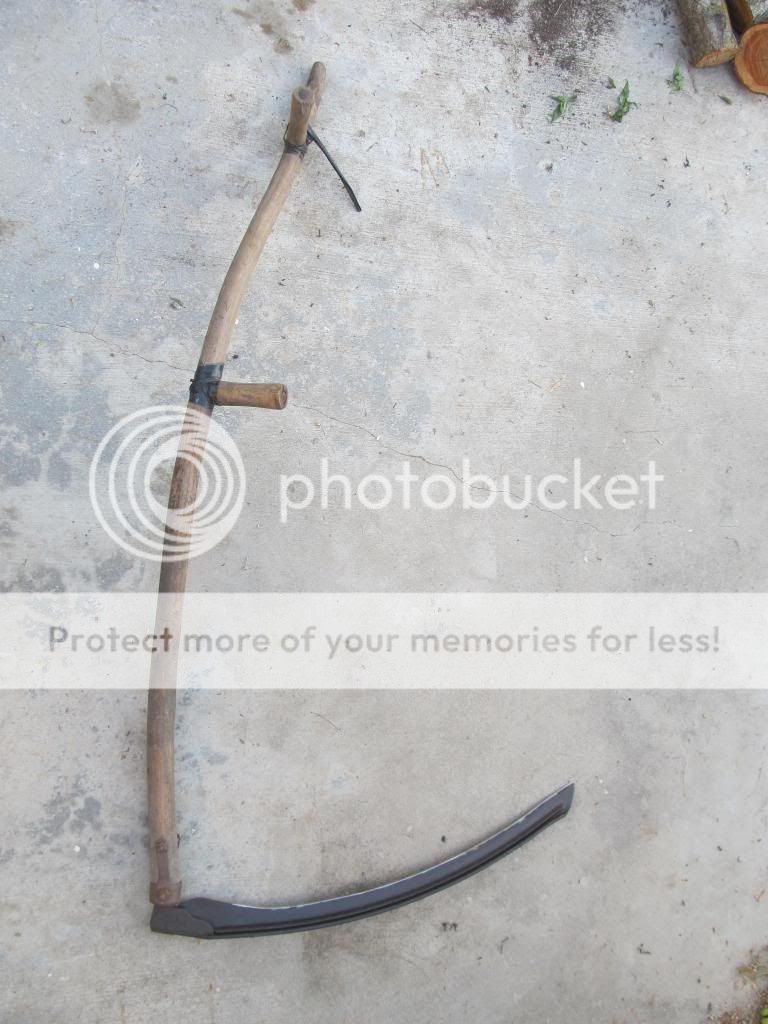

I'm new to this discussion but it falls right in with my love for all edged hand tools. I have wanted a scythe ever since the '70s when I watched an old guy use one to mow the tall grass along the edge of the road by my house in upstate NY. He made it look so effortless. Well, today I spotted this at an estate sale across the street from my house, and picked it up for $5. The surface rust cleaned up reasonably well, and it took a great edge.

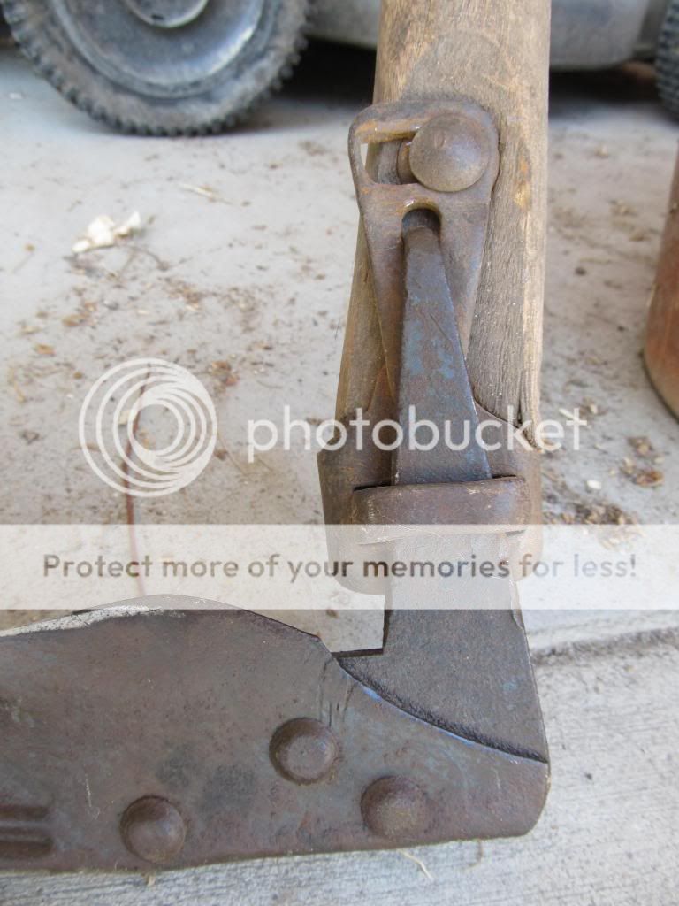

I've got a bush blade by the same maker. A very low quality blade, but a functional one. The blades seem to have been rolled out and cut from a continuous piece before having the separate massive clunky tang piece riveted on. I've not seen that snath hardware type before--do you have any photos of the underside?

Very interesting--thanks for that photo! And yes, it's hard to go wrong for only $5! I imagine you can probably rework that snath no problem as well. As far as the blade goes it'll certainly work no problem--they're just heavy for their size because the tang piece is huge and massively thick. The forging on the blades is still better than on modern American blades though. :)
If you have any questions whatsoever as you work on getting it back in working shape by all means let me know! It looks like a promising user. The hardware very strongly resembles that on my high-curvature cherry snath, though there are some key differences.
