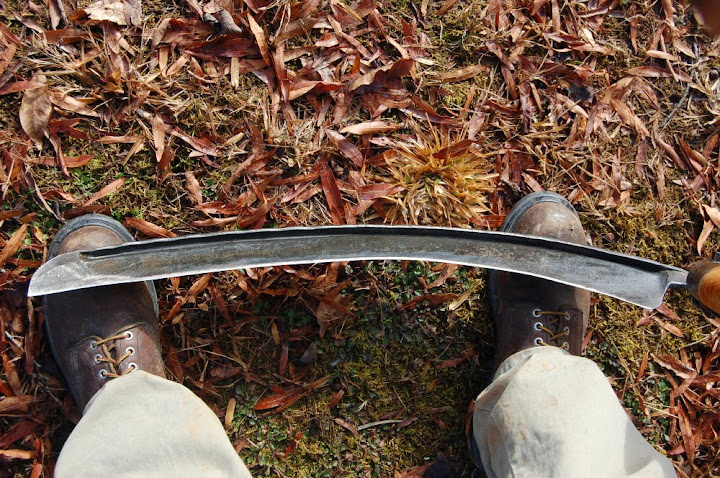

Oh nice--the tang on that one is properly pitched!:thumbup:
That secondary curve likely comes from the toe of the blade having become dulled more frequently/rapidly that the rest of the blade (thanks to it being the first part of the blade to encounter problematic obstructions like hillocks, rocks, fence wires, etc) and probably got ground down more in repair of that dulling than the rest of the blade. Preferably one would use the geometry of the curve at that point and see how it could be smoothly blended back into the arc of the rest of the blade. See what "bumps" lie between the curve at the tip and the main length of the edge and grind them down so you have a nice continuous and uninterrupted arc. The region that was "excavated" will then need to be ground thin again and honed.

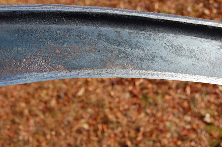

As far as the nicks go, those are little ones. Don't worry about them until you go to refresh your edge on the grindstone or 1" belt sander (but the grindstone is vastly preferred)
