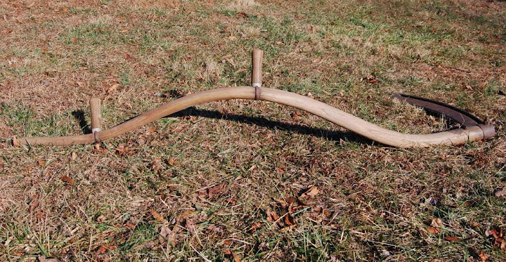

Well I guess I can post pics now, I made it through all 47 pages. :)

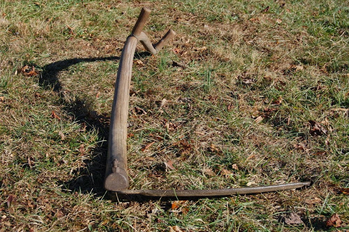

A few others, closer up...

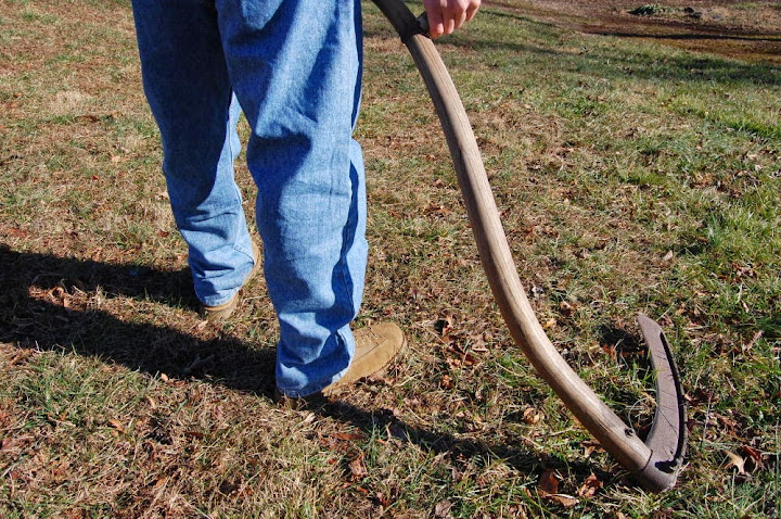

My son holding it resting on the ground, he's 3" shorter than I am, so in my hands at this setting, the blade is lifted even more.

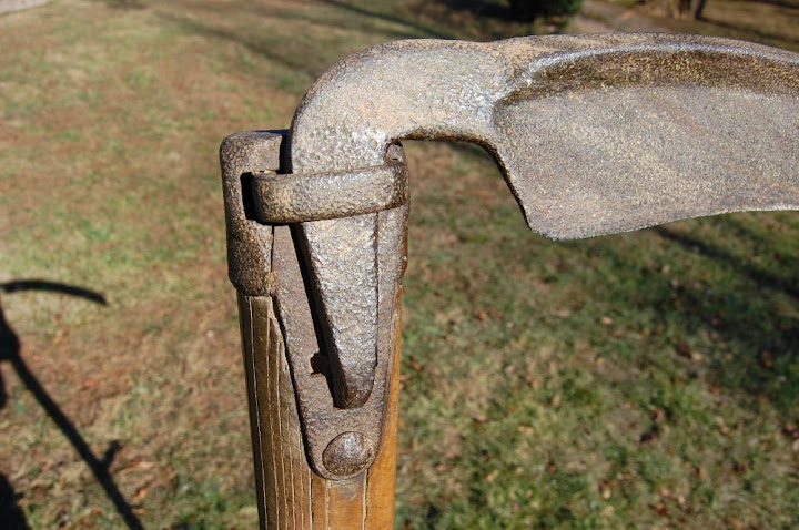

Looks to be a Seymour SN-1 or SN-2 snath (if there are 3 holes it's a No.1 and if there are 4 holes it's a No.2) and the blade is definitely a TrueTemper Briar Edge bush blade. Those blades tended to be a little roughly forged, but were very good steel and moderately thin in the web (they could be thinner, but they're thin for bush blades.) The heat treatment on them is nice and hard, and they take a screaming sharp edge with ease. For the blade type the lay isn't bad but if you want to convert it to "mulch blade" usage (which those blades are quite nice for) then you can adjust the pitch of the tang a little to bring it closer to level. Your collar looks like it's cracked, though, and that's going to need to be fixed. A local garage or machine shop should be able to weld that up no problem--doesn't have to be pretty to get it back in working order!
If you can get the nibs to adjust I'd rotate that lower one closer to between the 8-10 o'clock position. :)
I kind of like the lay for what I'm doing right now, I target the individual saplings and lop them at about 2" off the ground with an upward slice. And there's a bunch more to go.
I wondered about that crack, I've got a little wire feed welder here, (and can do 'not pretty'!), would that be suitable?

Should work fine! Just obviously remove the collar before doing the welding. You'll possibly need to squeeze that crack closed in a vise, as the gap may be widened from strain under use.
I understand what you mean by the "machete on a stick" comment, but I'd gently urge you to avoid using the term since it would inspire folks to "golf club" their strokes and try chopping or hacking with the tool instead of the shearing slice that should still be used with a bush blade. I like to outright tell folks that a good scythe makes a poor machete! It's chops and hacks that probably cracked the collar in the first place! :D

I inherited my Grandpas old Scythe and it had the same crack as in your pictures Cub Creek Forge. I took it to a local welding repair shop back in '95 and the repair is still holding. Since then I've used it to clear brush, long grass and even blackberries. I did a brief stint as a landscaper in college and the scythe went along to bring overgrown lawns down to a size where a regular mower could handle it. I'd ditto the above comment on the hacking. The tool really isn't designed for saplings. If you'd care to acquire a good brush hook though you'll be able to take down everything that's too small for an axe but too big for your scythe with one swipe.
