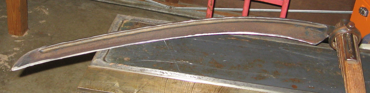

My current rough sketch of an idealized (to me) general purpose grass blade.
That's old bendy, just little shorter! Add the pitch and crown, though, not to mention some wave on the edge.. Looks good. I also like the Banco? Swedish hybrid blade. An exaggerated heel and dropped point seems to be best for fine grass. A tighter radius on the edge eliminates the need for a too closed hafting angle, which reduces the "bite" too much for my taste.
There are 4 major profile factors that affect the performance characteristics of the blade: the arc of the the edge (known as the "cutting line"), the arc of the spine, the angle of union between the spine and the edge that forms the toe, and the set of the heel. I'll be doing up some further drawings that will illustrate different more specialized forms. The above is part of a proposal piece to Seymour to change manufacturing spec. I'd personally go with just a solo rib (like the one Square_Peg posted) rather than bead-and-rib, but wouldn't want Schröckenfux to forget how to do a bead on a blade. It does help rigidity in more heavy growth but for regular grass I think just the rib--if done properly--is enough, and it increases the useful life of the blade by giving more room in the web for the edge to wear back.
Notice that the one Square_Peg posted has more drop to the point (generated mostly by the "collision point" of the radii that form the cutting line) and a little less beard at the heel. It would be a very aggressive cutter in fine grasses but would tend to hang and chatter more on heavier growth.
42,
As I said, your design looks really good. The bead will be OK, esp. if it allows thinner material. I'm sure you thought about it, but maybe they could put some halfway pitch into the tang. My thinking is that a FEW degrees would help everybody and in combination with the angle built into the snath would likely suffice in many applications. For example, I like the edge a little more upward than is optimal for lawn mowing.
Also, I've become a big fan of crown, especially in suboptimal terrain. Are you thinking about spec'g any amount of crown, and/or would the heat treat allow the user to add some? I'm not sure my S'fux grass blade can be crowned without damage.
As always, good work. Nobody has done more than you have to bring this style of scythe back.
