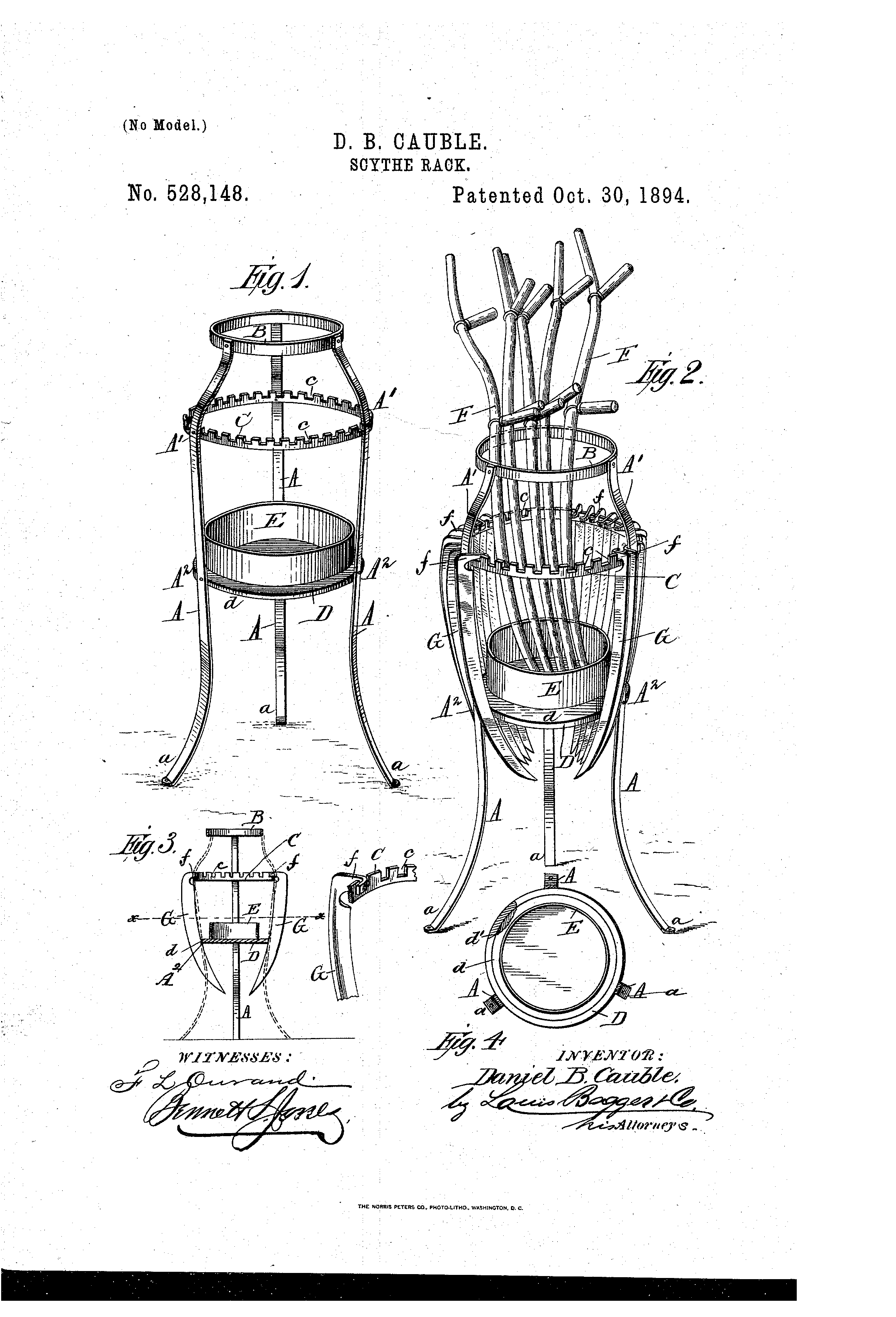

Yeah I've been tempted to try making a facsimile of that one using some of the mountains of old iron "wagon wheel" tires in the woods here.

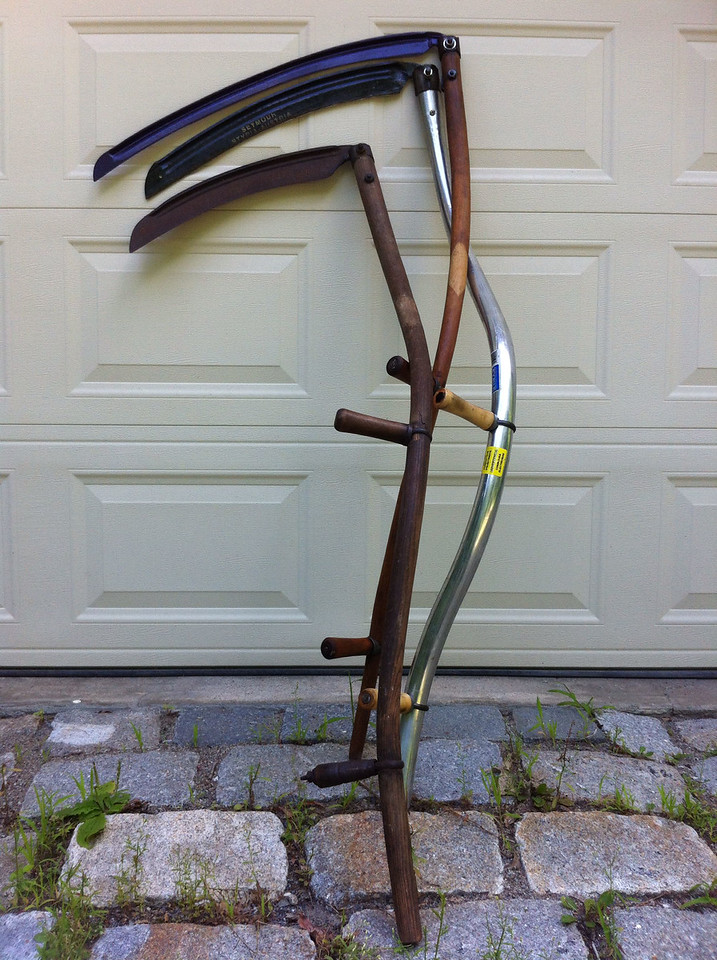

so, i got a Seymour, works really well, though "not a grass blade" quite as much as i hoped, so i hit craigslists and found a guy selling two old scythes
one of them was a pretty nice ditch blade... heavy, but as you can see, old weathered wood, rusty hardware, and one of the nibs is ... messed up - i need to make or source a new wood bit, the hardware is fine though. finding the odd yard sale with some blades is not hard - i know a guy with a barn, that has a bunch of sad ones, but he wants WAY too much money. i figure i can score some nibs if i'm patient.
the other, more the grass blade, is the restored one. took it completely apart, used handtools (esp wire brush) to remove any rust, scraped the crud off the wood, and spent a few cycles of sanding and wiping with BLO. looks nice.
was able to get the hardware readjusted and very tight. lovely stuff that.
the blade was a "wee bit off", so i got a little hammering and fixed that. cleaned up the blade fairly well, and then converted any remaining rust to black-oxide, and uh, painted it purple. slowly but surely i'm setting an edge - it's hard. yeah, it won't peen that one. saw the references to cold water wheels and how to use a file and stone to thin it out.
hopefully, i can make it a user, not just a shower.
next one my list it to get some good quality one and two man buck and cross saws. esp the kind with the nice end hardware, and deeply tined teeth :D
