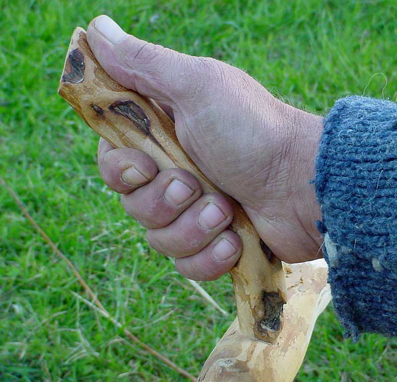

Yes, a stemmed grip for either the right hand (raised) or the left hand (dropped) is typical with straight snaths unless they're a single-grip. However, in those cases a more contoured shape to the grips is preferable since they can't exploit the shaft of the snath as a grip component. Rear-facing nibs wouldn't work so hot. The nibs on this are a less than ideal arrangement. :)
Nibs are best used facing forward, as the shaft of the snath is often used as a component of the grip. :)
Photo from ScytheConnection.com
In my opinion, a well-shaped grip that fills the hand, whether it faces forward or rearward, is preferable to simultaneously gripping a round "peg" and the round shaft to which it's attached at a 90 degree angle. :)
It's actually quite comfortable, and there are numerous ways of gripping it, of which this is just one. I don't ever find my hands complaining, personally, and I'm able to alter my grip to change the presentation of the blade a bit so I can work slightly different muscle groups at different levels of engagement over the course of the mowing session while taking swaths of equal dimension (particularly useful when cutting very dense neglected areas full of woody stuff.) It can certainly be held in manners that are unergonomic, but in the modern age we all-too-frequently think of a grip as a single isolated component when there were many tools historically where the concept of the grippable region of a tool was much looser. Many historical swords, for instance, incorporated the pommel, ricasso, and guard into the region that was intended to be gripped in use. :)
The hands, in the photo I posted, are only used to hold a consistent position and control rotation/presentation while the heel of the palm is actually bearing the greater amount of the force in use, with a pulling action. You can modulate how much you want to use the grasp of the hands vs. how much pressure from the palms, but I use more from the palms than from the fingers. It's a very relaxed hold. The nib can also be used as a stop of sorts for adjusting your rotation (and consequently the radius of your stoke.)
Also worthy of note is the difference in design parameters for a grip that is meant to be pushed vs. one meant to be pulled. A grip meant to be pushed will be transferring the force into the palm, while a grip that is pulled most commonly will want to transfer that energy into the fingers. A drawing action will be the more efficient motion in mowing because of the lever types we're dealing with (first class for pulling vs. third class for pushing) but having the force transferred to the fingers would grow tiring even with otherwise sound ergonomics. The use of the shaft of the snath as a brace allows the resistance during the drawing stroke to be born by the palm instead of the fingers.
