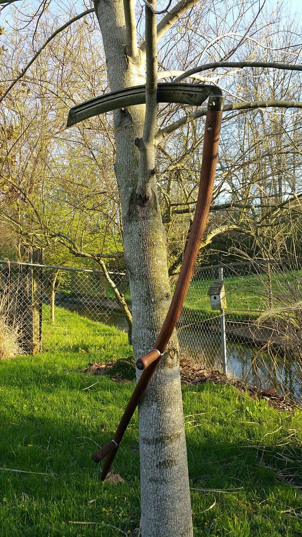

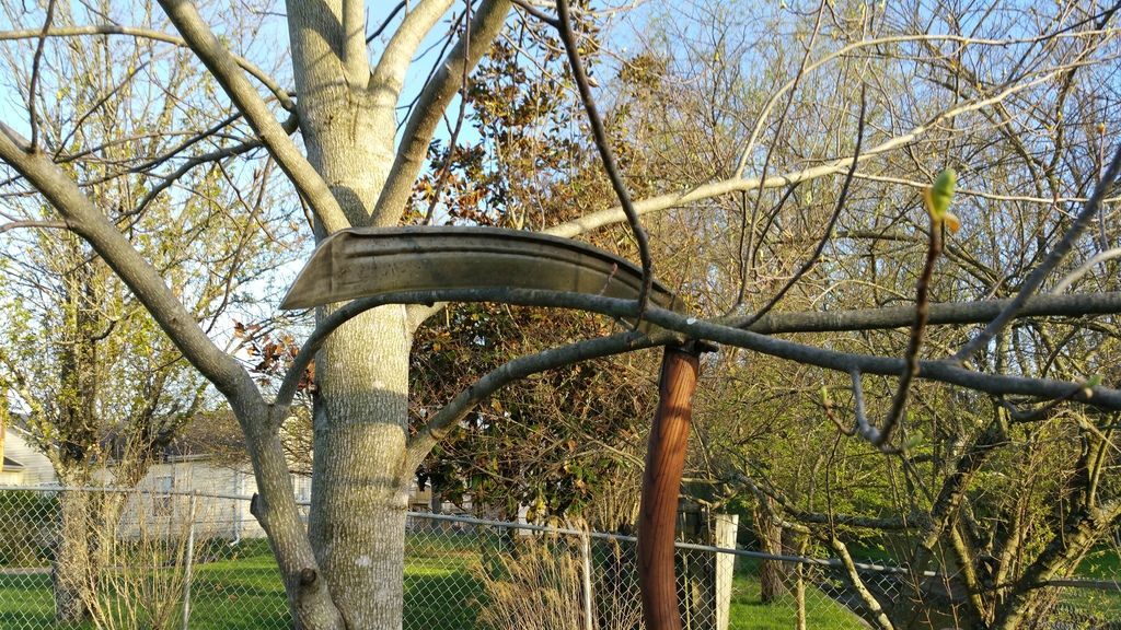

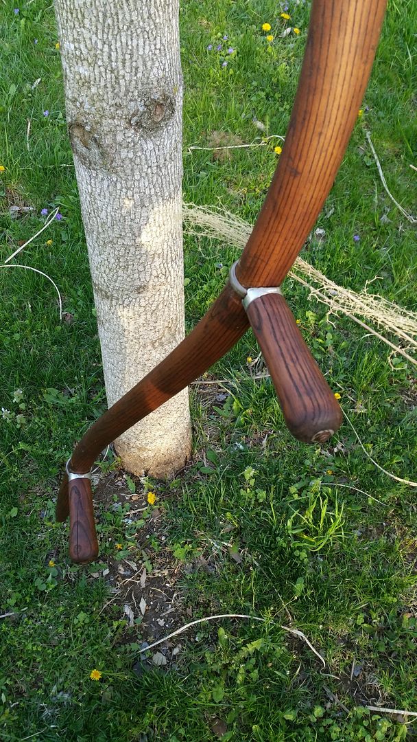

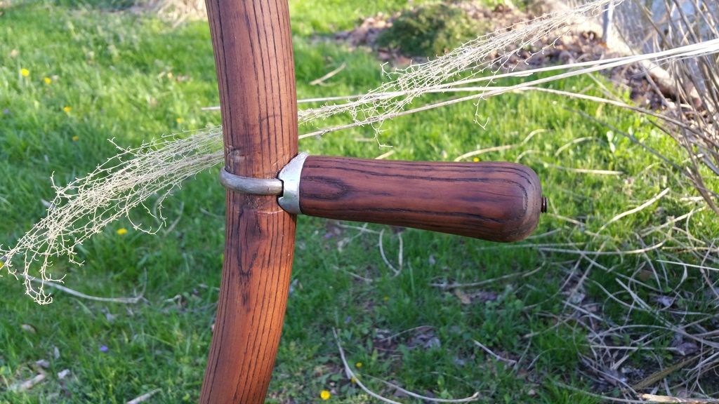

This is my first scythe restoration and I really enjoyed the process. I picked up two scythes at a flea market in eastern Kentucky, both in decent shape for what looks like not being touched in decades. Lots rust, dirt, grime, etc. Pulled the blade off and it looks, from my limited research, to be a Fux blade. It has the embossed flower/bush. Vinegar on the blade, then sanding to clean it up, followed by a couple of coats of linseed oil. Was razor sharp, which I found out after cutting myself! After alot of sanding the wood was in really nice shape and took well to the stain. This was supposed to be a really light stain but a single coat turned out a beautiful dark color.
Nice work! Looks like an ol' Seymour-sourced Austrian-made blade, probably a later production Redtenbacher based on the "stubbed" toe on it. Going out on a limb a bit but with that rivet affixing the collar I'm going to guess that the snath is a Sta-Tite. You'll probably want to rotate those nibs counterclockwise on the shaft so they point away from you in use, with the left nib tilted a little more upward than the right. The blade, though sharp enough to cut flesh, likely could still use a little thinning and honing prior to use; I say this mostly because I have yet to come across a single vintage blade that was still in ready-to-mow condition. Most will have at least a few small nicks or dulled spots or the bevels too thick and rounded over. With a blade that wide you should be able to get a low enough angle with a file without too much trouble with clearance if you work with the file's tip. :)

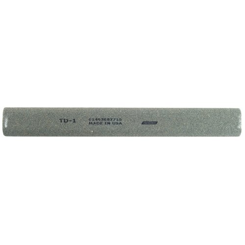

it's the season. gotta get some sharpening going on. even got some good new stones - hardware store sells Seymours... but also carries scythe specific belt stone. weird.
Have a picture of the stone? Just curious as to which one it is. Norton and Lansky are the ones usually found in the hardware stores.
87715 Features: -Alundum scythestone. -Coarse grit. -10'' x 1-5/16'' x 3/8''. -Carded. Product Type: -Sharpener. Dimensions: Overall Product Weight: -0.8 Pounds.
says Norton TD1
Ah yes--the American pattern scythe stone that Norton makes. Handy stones for a lot of edged tools but I generally prefer the canoe stone type since you can better preserve a hollow bevel with one.
