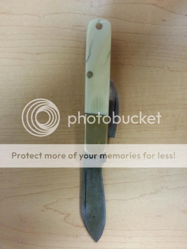

Thats the first spear bullet end I like. The blade is not overly bulbous and looks sleek. Try as I may the patina just is not forming well on my Oeser. I think its mainly due to the fact that its the nicest knife I own, so I take a little better care of it. I usually wipe it down with my shirt after every use, something I dont do with my GEC knives. Over time I am sure I will lighten up on that but for now I like the used but doesnt really show it patina. Aside from all the sweat speckle showing up on the backsprings :rolleyes: :)
