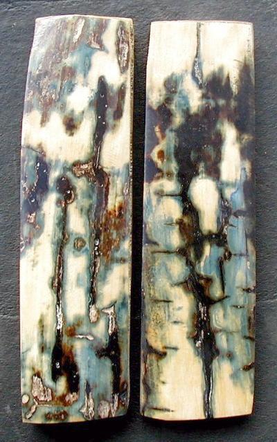

The Ivory is posted on the site and here
take a look I'm going
to have a hard time picking.:(

Roger,Gotcha! Thong hole and thong? My nickle's worth, nope on the thong/hole. Dan, hard choice on the ivory. I like the pieces on the left and right, but you guys know more about ivory than I do, by far! Your call, I have faith in your decision, Dan. Great ivory, by the way.

I can't take any credit for the Ivory just the posting it:)
Roger
is Chucks Ivory big enough? it looks like
it could be a match book piece to me

The two scales you see in the picture measure about 5 inches long by almost 1 3/8 inches wide, each. As you can see, the middle-top piece is a little tight in width for both scales but I think I can get them if that's the one you guys want.
