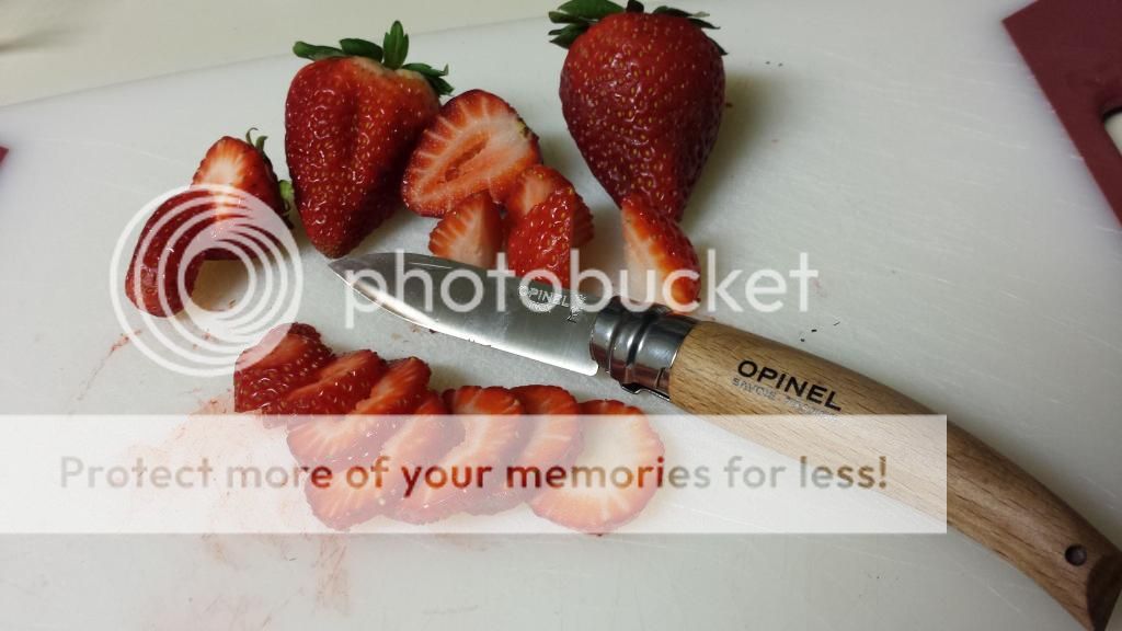

Who would have thought the lowly Opinel could inspire such intense debate? Here's a picture break: Opinel no. 8 and its companion, a Mora 511.

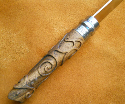

Wish I could do one like that.
