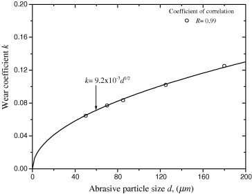

EDIT to add: here is a paper (not same authors) running the analysis: Effect of abrasive particle size on wear resistance in steels http://www.sciencedirect.com/science/article/pii/S026130690400278X
So, this last chart shows, as particle size becomes larger (think larger grit size) then wear coefficient plummets. DM

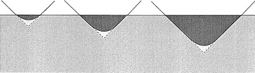

The coarse grit has more volume per grit. So if the coarse and fine are both penetrating to the same depth, it will take less force to drive the more open pack to that depth and I agree with the above. As the coarse grit penetrates deeper, the volume of displaced metal increases rapidly in both breadth and depth.
I cannot be sure, but if you were to drive both configurations to 80% (random value) of their available depth it would likely require a lot more force on the coarse arrangement.
"80% of available depth" is pretty meaningless, since 80% of the fine-grit may be only 10% of the coarse grit, and the coarse grit will reach that depth with less force than is required for the fine grit.

At low pressure they are fairly close though the coarse still has advantage. In order to drive the coarse abrasive further into the steel more force needs to be applied. Yes the fine abrasive fails to deliver even with more force and presumably a like increase in depth or even greater as a percentage of its total size (proportionately, it cannot dig deeper than it stands proud), but I never claimed otherwise. Added depth per pass = greater stock removal for a similar feed rate, it requires additional force for the coarse abrasive to distinguish itself.
The 80% figure - 80% of a 20 micron abrasive depth is 16 micron. 80% of a 100 micron potential depth is...80 microns. Again, these are random assignments - actual abrasive depth is a fraction of these numbers in most cases. In many cases with a coarse abrasive it is probably not possible to drive the abrasive to 80% depth with anything approaching normal operating pressures. Not needed in any event, 50% in this example is still 50 micron, far more than the 20 micron depth of the smaller abrasive.
