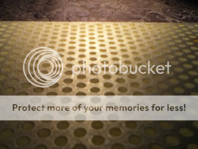

The first time I ever bought a diamond plate was solely for the purpose of flatten plane blade backs. DMT Extra, Extra, Coarse (220 or so). Sounds good doesn't it. "Diamond Grit" has a SOLID, exotic, INDUSTRIAL, quality to it. It was sooooo much better than rolly-polly-man but still was no where near up to this job in any shape or form.
The manufacture’s directions suggested to not press hard; to “let the stone do the work”.
Yah . . . after hours of gently persuading the blade backs to flatten I was desperate. I started experimenting with more pressure.
Finally out of desperation I even put the stone on the floor and really got my butt into it for long periods as you see Toshio Odate doing here.
Even some place for the swarf to go (down in the dimples) one would think this was the ideal way to flatten the backs of the plane blades.
You can see by the arc of the polished area that the areas closer to the corners of the edge were proud and the center is some what hollow. You would think that taking off such a small amount of metal would be fairly easy with an “‘Extra, Extra, Coarse” stone.
Nope the blades just laughed at me and kind of got scratched up a little bit but when polished were not flat . . . yet.
