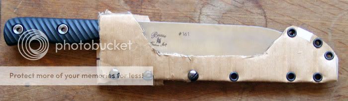

one more post, then I'll stop. I've spent a lot of time getting to where I can make a sheath that works in 45 minutes, so I'm generally interested in the subject of do-it-yourself techniques that increase speed or cost effectiveness. I'm not exactly rich myself and can't really even afford the knives I buy let alone sheath material.
this sheath:
made using this technique (plywood, used oak flooring and tools I already have)
cost me around 20$ in base materials. this is cutting the cost of the 100 pack of rivets down, and reducing the cost of the kydex because I got 2.5 sheaths out of the 12x12 piece.
