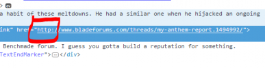

When I click on an embedded link that's just a 'www.bladeforums.com/etc...' it shows in the background code as a non-https link, which would be the reason why you're not logged in when you get to the link.
I assume there's an easy way to have the site convert any embedded link into an https link, but I'm not sure what changed to make the site into an https site.

Try putting https:// it fixed the problem. Thanks pombz

Confirmed that changing my bookmark to 'https' has fixed it, opened the page next morning, still logged in. Using a 'http' address at any point seems to log you out.
