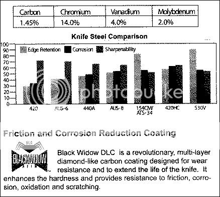

Even if you've never used 420HC, you should still notice it's been repositioned on the chart:
Namely, that 420HC has been moved above 154-CM, where the bars on the chart show it should be. I've never seen a steel site list 420HC above AUS 8. But then again a lot of sources place edge holding as more important than ease of sharpening.
I don't understand how ease of sharpening would be more desirable than higher edge holding, but judging by the number of Buck's fans, some people seem to think it's the most important attribute of a steel.
Again, that's fine, but for some customers 420HC just isn't that much of a bargain.

Even if you've never used 420HC, you should still notice something funny about this chart:
Why don't you tell me what you find funny about it?
BTW, funny haha or funny strange?
Namely, that 420HC has been moved above 154-CM, where the bars on the chart show it should be. I've never seen a steel site list 420HC above AUS 8, but then again a lot of sources place edge holding as more important than ease of sharpening.
Funny strange.
First off, S30V is not the "be all, end all, best there is" steel. It's a matter of what you're using the knife for and personal preference. Diving knives are commonly made out of 420HC for it's corrosion resistance. No D2 in salt water, no matter how well it holds an edge.
Second, what in gods name is "Sharpenability" ? Do they happen to mean "how sharp can you get the knife" ? I've seen people whittle hair and push cut toilet paper with every steel under the sun. It may not hold an edge, but it can do it once.
Funny strange.
First off, S30V is not the "be all, end all, best there is" steel. It's a matter of application and opinion.
I take that to mean how easy it is to sharpen. Easy to sharpen = lack of edge retention. Harder to sharpen = good edge retention. Or to say it another way "machinability". If it grinds easy on the stones it will grind easy and lose the edge in use. If it is hard to remove material on the sharpening stones andtakes work to sharpen then it will not loose material or be "machined" whin in use cutting and slicing various materials.
I do not think it means how sharp it can get.
Good point. I guess I hadn't thought of it that way.
Easo of sharpening and lack of edge retention does not go hand in hand. The term must refer to ease of sharpening and ability to get a sharp edge. But most importantly, to take a keen edge with a small geometry. There is a reason why coarse grades like D2, 154 CM etc is not commonly used in kitchen knives for instance. Wear resistance is a function of hardness, carbide size and carbide volume. with a fine carbide steel you get the benefits of high hardness and good carbide volume but not the "bonus" for large carbide size. instead you gain toughness, ease of sharpening and edge stability.
What is sharp? Some say shaving hair, some say push-cut tomatoes or paper. The only solid definition I have heard is that the edge radius should be no larger than 1-2 microns. This definition is used by the razor and surgical industri. This effectivle means that steels with carbides exceeding 4 microns in diameter will not take a "sharp" edge.
Anyway, for forumites I believe any martensitic steel out there is ok to sharpen. For the average person i believe it's different though.
OK fellas, I sent the chart in to Buck for a comment on its authenticity.
Some on the Buck forum thought it was fake which is my thought as well since Buck doesn't position/price 420hc ahead of its 154cm in its product line. I'll let you know when I hear back.
I can assure you the chart is from Buck. Here's the scan of the paper that came with my Buck Alaskan. This is the raw state:
Although you can argue the relative merits of 420HC, you can't argue the price. S30V is definitely more expensive than 420HC. Not only that, but Buck actually says that S30V is the "best" steel available today.
Excellent Confederate...I just bought a Stag AG110 yesterday so I went and looked in the box and the chart is there as you say. I must say I'm surprised at the positioning of 420hc ahead of 154cm on the chart. Oh, I was never attempting to argue price in any part of this discussion. I did note that Buck positions/prices 154cm knives ahead of 420hc.
Interesting that the chart supports Buck tendency to use 420hc in a lot of its expensive LE knives. I've never been in disagreement with your basic point in your original post. I will be interested in hearing what Buck says about the chart. I suspect I'll be hearing its a misprint. btw, the colored chart is your own creation from the AG paperwork? yes?

I doubt it's a misprint. I got the same chart in my ATS-34 Buck RUSH box a couple of years back. And to think I paid extra for an "inferior" steel. :rolleyes:
Look a little closer at the chart. Yes, they put 420HC ahead of 154CM for corrosion resistance and sharpenability. This is true. They do not put 420HC ahead of 154CM for edgeholding; the chart clearly shows that 154CM is superior for edgeholding. I do not see the issue with the chart.
I do see an issue with positioning on the chart. I think that anyone that looks at this chart will read it as showing improving overall desirability (as a knife steel) from left to right. Clearly S30V is the best knife steel on that chart, we all know it. I took a swag (pulled out my trusty ruler) at the total point values shown. I came up with 196-154cm, 198-HC, & 203-S30V.
So each bar is given equal weight and value. Sharpenability seems subjective. Well it is a stretch for me to rate 420HC higher than 154CM as a knife steel. Maybe the guys at Buck will shed some light on the positioning and if they are really trying to say to the world that 420HC is the second best steel on that chart.
Saw the chart in the Buck Forum. Figured out where it came from. Sigh.
Part of my job is to collect and display data. I construct charts a lot. IMO, there is nothing in the positioning of the steels that says that 420HC is superior to 154CM. It just does not read that way. And I would agree with the assessment of the properties given for those two alloys. I find the edge retention of 154CM superior to that of 420HC. I find 420HC easier to sharpen. I have no data on the corrosion resistance. But I would not disagree with what is presented.
That being said, I would disagree with the comparison between AUS8 and 420HC. When heat treated to the same hardness, AUS8 has superior edge retention compared to that of 420HC. When it is considered that AUS8 has about half again as much carbon as 420HC, this is hardly an unexpected result. If you compared a 420HC blade at 59 to an AUS8 blade at 56, you might get the result on the table. There is a fair amount of AUS8 that is so heat treated, but, I would still disagree with the table. IF the hardnesses are not provided, the assumption must be made that they are all the same.

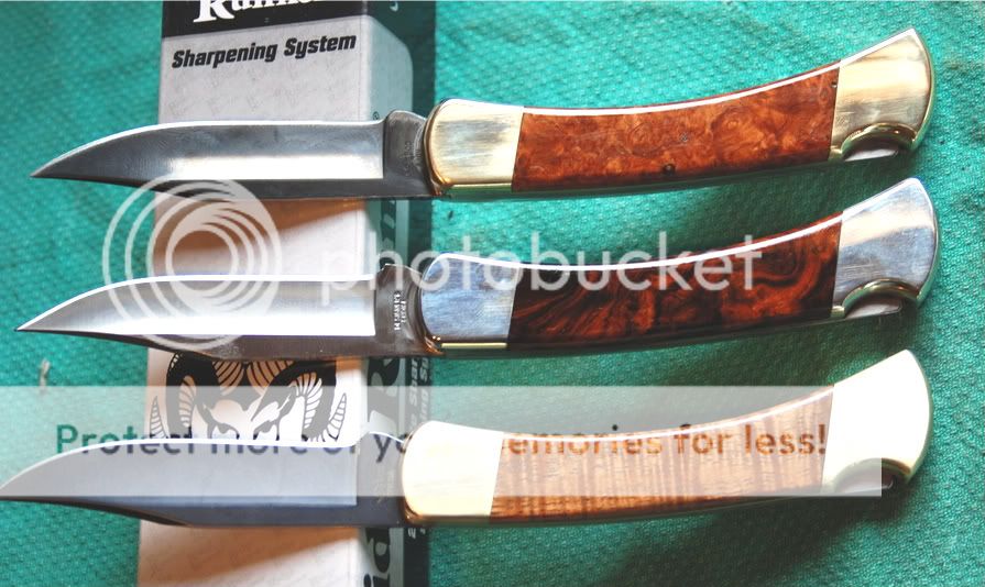

The only thing I don't like about the 110 design is the brass bolsters. I pulled one out of a box recently that I'd bought some time ago from Cabela's, and the brass had tarnished. I'd prefer stainless over brass, but it's just a minor annoyance.
As for the chart, I used an imaged editing program to colorize it.
There is the NS option but not at Wally World. Also, one thing I love about the 110 is you can change the inlay if you have a little apptitude for such things. Here's three I'm currently working on for friends. From top to bottom steels are S30V, ATS-34, & CPM-154.
Hi Knarfeng,
I agree completely. AUS-8 should get harder, have better wear resistance and lower corrosion resistance. All due to the extra carbon.
Mixing different hadnesses could present virtually any result. Either test all at the same hardness or at their maximum recommended hardness. It's unfair also but less unfair than using "random" hardness readings for different steels.
That chart doesn't mention toughness, something 420HC is superior in. AUS-8 should be pretty tough as well. The chart is obviously Buck's heat treatment of the steels. AUS-8 should have better edge retention than 420HC if heat treated harder.
