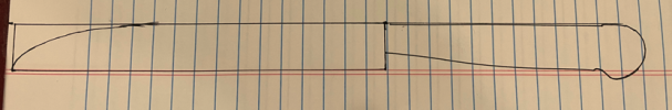

Hey Natlek. I agree - I did say this was a quick sketch, and that I would round the choil...I don t like the part where the blade extends into the handle ? Sharp and ugly transition ?
