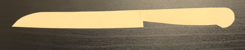

The problem that I see is your chamfer mill is likely 90˚ included angle or 45˚ per side. That's a pretty steep bevel for a knife (typically in the 20-35˚ range) and far higher than I'd want. The next option would be to tilt the knife on a fixture plate at say 25˚ so the effective angle of the cutter is 20˚. You're also going to have a lot of trouble if you do this after grinding the rough primary bevel because the steel will be too thin and lack rigidity. It will deflect away from the cutter and leave a poor finish at best. You'll need some careful fixturing to get enough rigidity to cut the serrations well.I have been aware of the o-ring around the contact wheel idea - but a couple things about it have concerned me. One, is the difficulty of getting the o-rings really accurately spaced, the second is that is strikes me that o-rings under the belt will produce pretty "washed-out" boundaries around the serrations.
It turns out that I *do* have a mini-mill, and right now am leaning towards using chamfer end mills to create the serrations. If you think about the geometry, you do not need to do this holding the blade vertically - you can just as easily clamp the blade flat on the table and come in from the side to create the serrations. With the indexing (or dro) on the mill, one should be able to get the serrations pretty consistent....

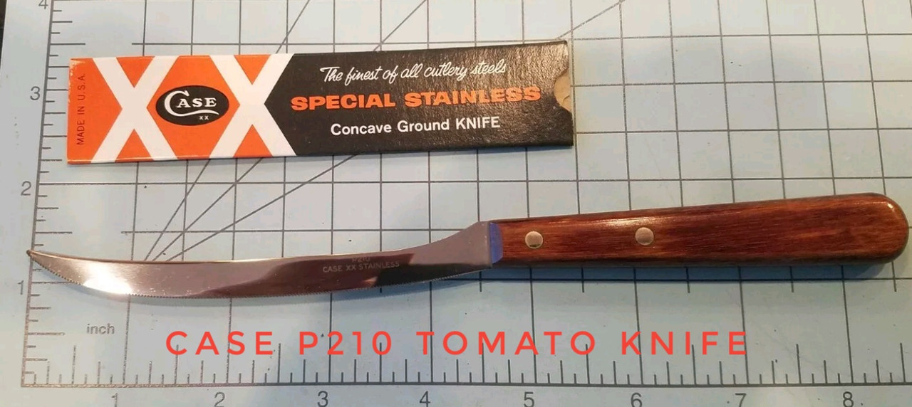

Thanks for the thoughts. I have several serrated knives here - so I took a look at all of them (one bread knife, one sold as a tomato knife, and another two 2.5" "paring knife size), and all of them seemed to have serrations whose troughs seemed to be at an angle of about 45 degrees - so the chamfer mill seemed to be just about right. But then again, I was just eyeballing it. before I cut anything on a profiled blade, I should try out techniques on annealed scraps. an angled fixture plate is also something that occurred to me. Heck - if you get a steep enough angle, one could just use the side of an ordinary end mill.....The problem that I see is your chamfer mill is likely 90˚ included angle or 45˚ per side. That's a pretty steep bevel for a knife (typically in the 20-35˚ range) and far higher than I'd want. The next option would be to tilt the knife on a fixture plate at say 25˚ so the effective angle of the cutter is 20˚. You're also going to have a lot of trouble if you do this after grinding the rough primary bevel because the steel will be too thin and lack rigidity. It will deflect away from the cutter and leave a poor finish at best. You'll need some careful fixturing to get enough rigidity to cut the serrations
I haven't watched the video, but the fixture plate in the thumbnail is exactly what I was implying when I suggested milling on a fixture plate.It is difficult for me to envision how you intend to machine the serrations with a chamfer mill. I assume you want to make scalloped serrations about 1/4" in size, not the small serrations (~1/16") you might see on a cheap steak knife set. The scallops could be made with a file at a shallow angle, filing from both sides to get a symmetric scallop. To get this type of serration on a milling machine, couldn't you just use a straight end mill and tilt your knife to ninety degrees minus the shallow angle you would have used when filing?
In either case, you have to hold the blade at an angle. If your vise opens far enough, you could just clamp a fixture plate at the correct angle and machine the serrations in the x-directions and space them using the y-axis. For a six inch knife, there should be enough travel to do this even on a mini mill. The fixture plate does not have to be anything fancy, just some scrap aluminum with a few 1/4-20 holes for securing the blade. If your vise does not open far enough, you could clamp a 1-2-3 block in the vise at the desired angle and bolt your fixture plate to it, but you'd probably have to cut away some material so the plate does not interfere with the vise. My 1-2-3 blocks have 3/8-16 holes in them, so it's easy to bolt stuff to them. Another option would be to build a mini pallet as illustrated in the video linked below. This would allow you to mill in the serrations in the y-direction and use the x-axis to space them out. The video is pretty long and I did not watch the whole thing, but watch around five minutes in to see how the mini pallet could be used for your application. Something like that could be useful for many other operations and would not take too long to make.
The chamfer mill idea was assuming that the blade is flat (parallel to the table), and the chamfer bit is then set to a known height, and the scallop then milled by translating the table in the y direction into the blade side a set amount. Disadvantage of this is that the radius of the cut will then vary by distance from the edge (the radius being smaller towards the edge - the idea is that the blade will be single bevel).It is difficult for me to envision how you intend to machine the serrations with a chamfer mill. I assume you want to make scalloped serrations about 1/4" in size, not the small serrations (~1/16") you might see on a cheap steak knife set. The scallops could be made with a file at a shallow angle, filing from both sides to get a symmetric scallop. To get this type of serration on a milling machine, couldn't you just use a straight end mill and tilt your knife to ninety degrees minus the shallow angle you would have used when filing?
