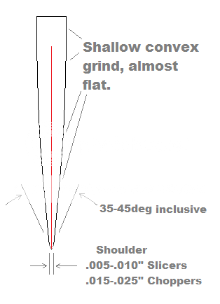

I was always afraid to show what type of grind I did for fear of being criticised about my angles. Now having done the testing myself, entering as many public contests as I could and offering up my blades for peer review, I feel confident enough to let it all hang out. Basically, I do the most shallow convex grind I can and knock the burr off at a steeper angle than the norm...
I have not conducted any testing.
Then you're flying completely blind. I would assume/hope that you've used knives a fair amount and aren't just copying what you think is most popular, and easy to build a jig for.
A point that I don't think has been mentioned is that scandi ground knives are very cheap to make. The design lends itself well to mass-production and $15 knives that are essentially disposable; re-sharpening techniques are practically moot.. (although you will see a lot of guys putting $100 of materials and mods onto a $15 Mora... but I digress...)
Make four blades of the same material and same dimensions, and grind one full convex, one scandi, one full-flat and one hollow. Use them all for whatever tasks you designed them for. Your questions will answer themselves.
Actually you could make eight, the four above with micro-bevels, and then four more with true zero grinds.
Fair enough. If you have been using knives with the same geometry for years, I would say you have the right to call it a proven design. You are using equipment that can give you repeatable results and Peter's is a reputable HT company. I guess the only variable is your profile ergonomics... they look like comfortable users. It is safe to say you have a good product Monkey-Nutz.Thanks for your great diagram that looks like an outstanding bevel for a wide range of tasks. Your design appears to be a convex bevel with reduced curvature.
I have been making knives for about 4 months now. I have not conducted any testing. I don't know what testing an 01 blade, scandi beveled and heat treated by peter's service would accomplish. I am using methods that are proven and designs that I know work based on my experience using tools.
