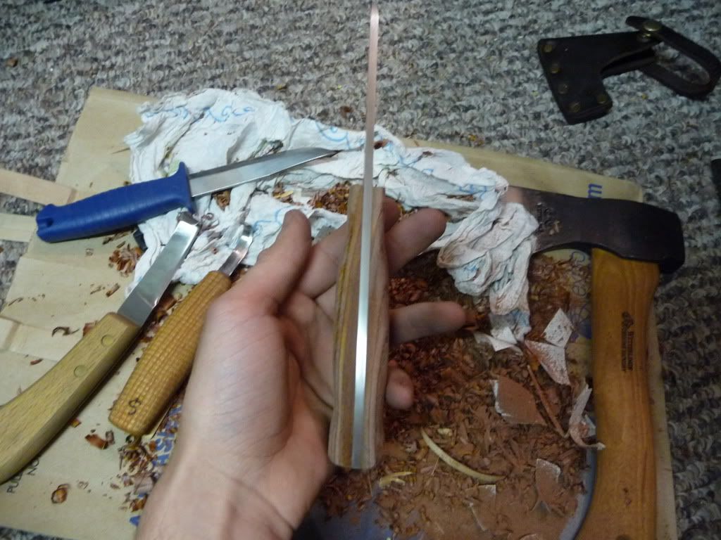

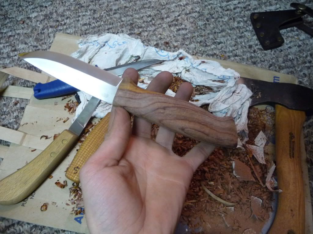

Anyways, as I said in my previous post, here's an update on the knife. I was up the whole night making the scales. I have a bad habit of not being able to put down a project once I start it:

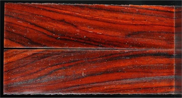

The slabs I picked up first of all:
The tools I used are in the background. 75% of the carving and work was done with the Mora. I simply did the basic shaping onto the blocks, used double sided tape to attach them onto the knife then continued the shaping:

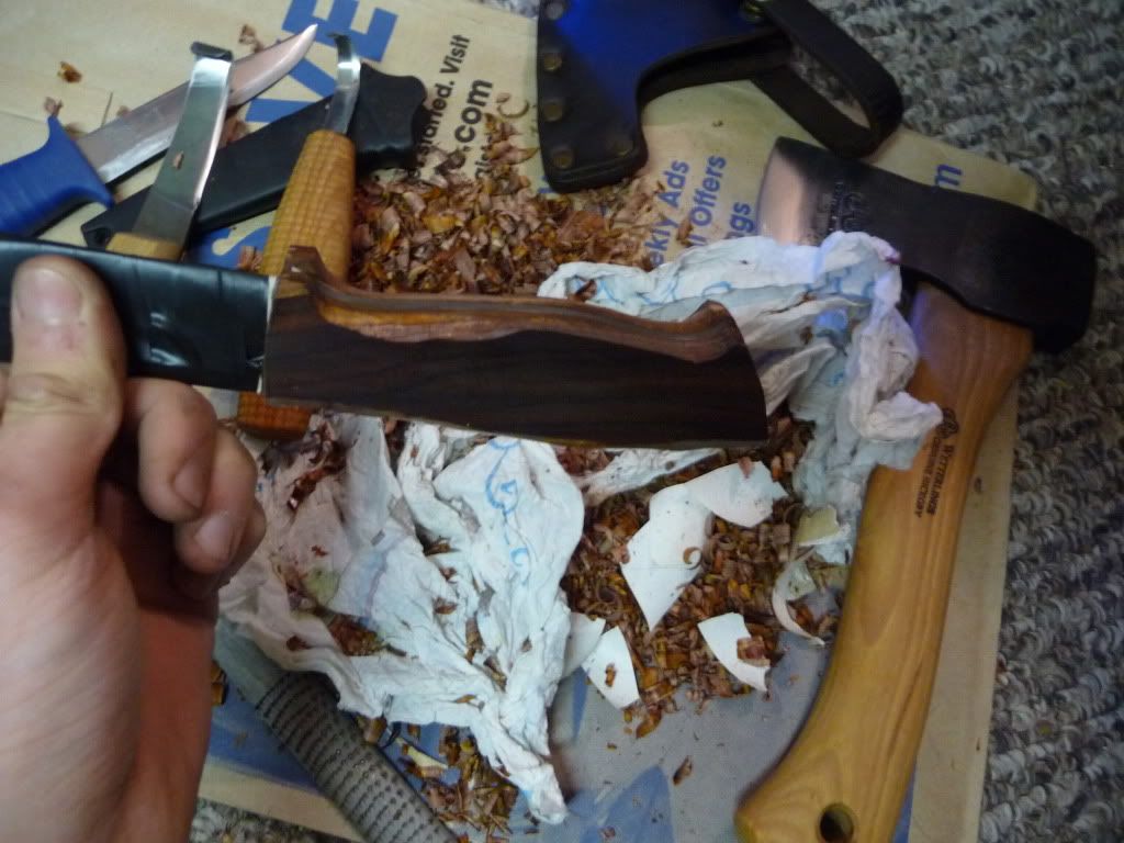

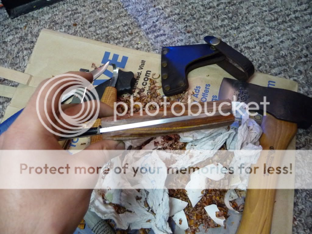

Here it is with the final shaping done, sanded with a bit of 150grit, and with a small bit of mineral oil to get a basic idea of what the color/grain would look like. Still needs the red liners, some final sanding and of course the screw holes drilled. Like I said, I wanted to keep these scales removable just in case.
Turned out nothing like what the slabs I bought looked like. Problem with most of the cocobolo slabs shown on e-pray and other sites is that they're generally coated or sealed in some manner to make them look bright red. I actually like it this way more. A lot more contrasting browns/reds/purples and such... especially like the very vivid redish-violet lines that really pop against the light orange and brown that makes up the majority of the scales. I'll eventually finish it with a few coats of Tru-Oil once all the work is complete and I'm sure it'll make it pop a bit more... for now though, I think it's coming along nicely

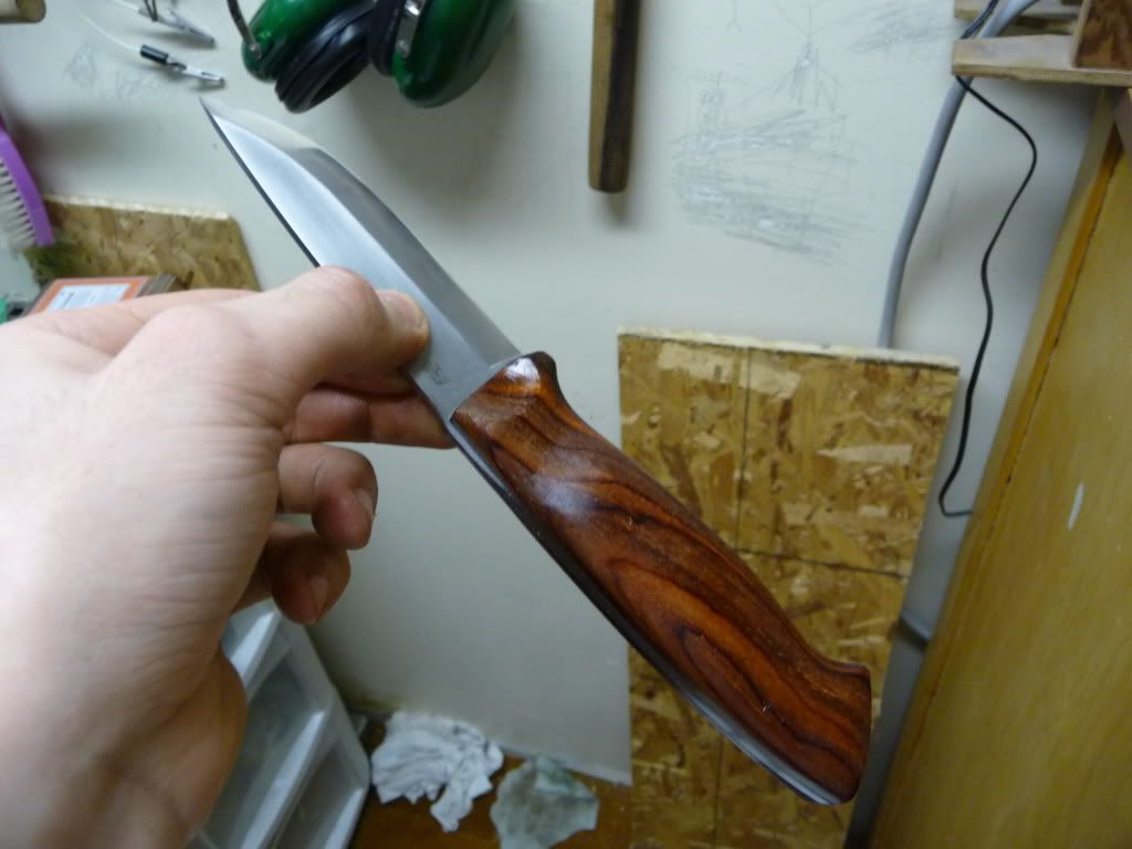

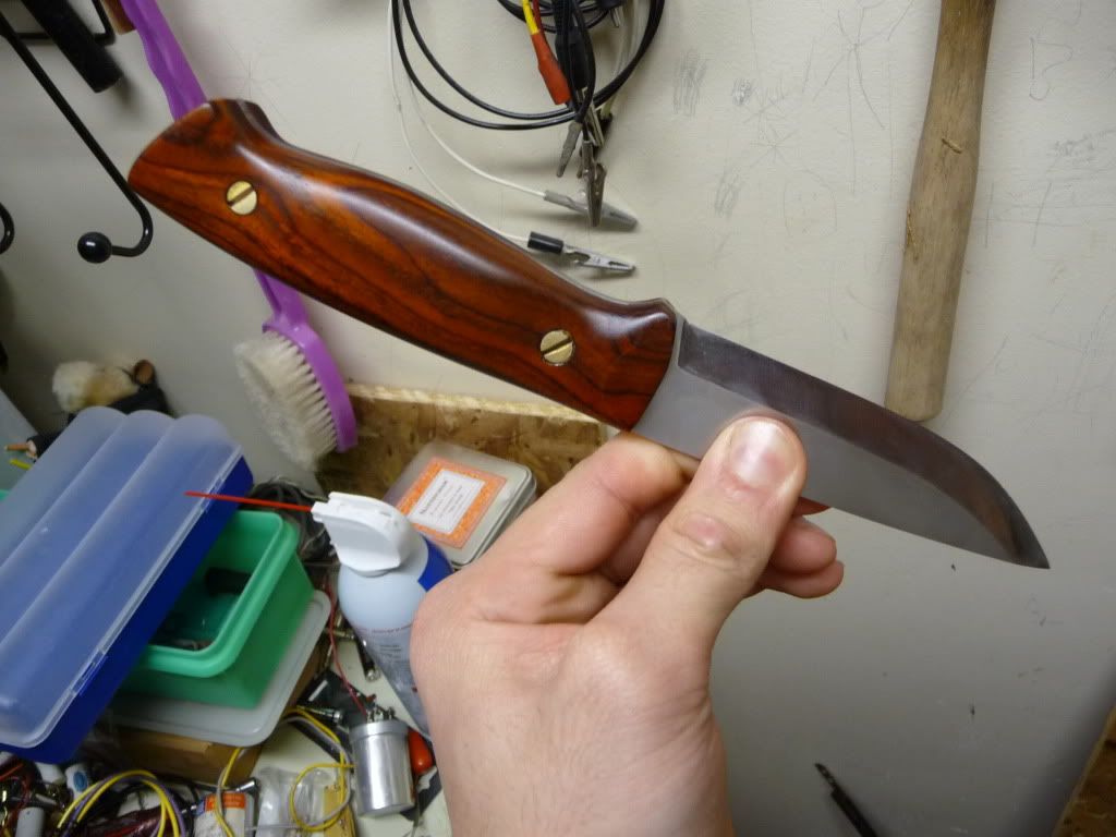

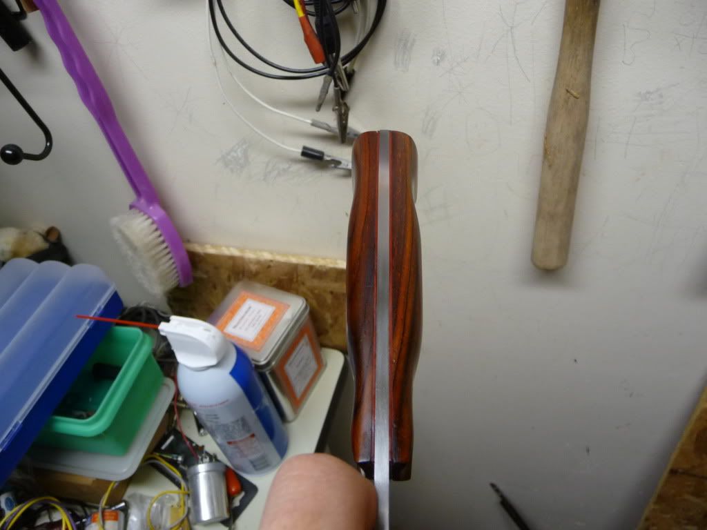

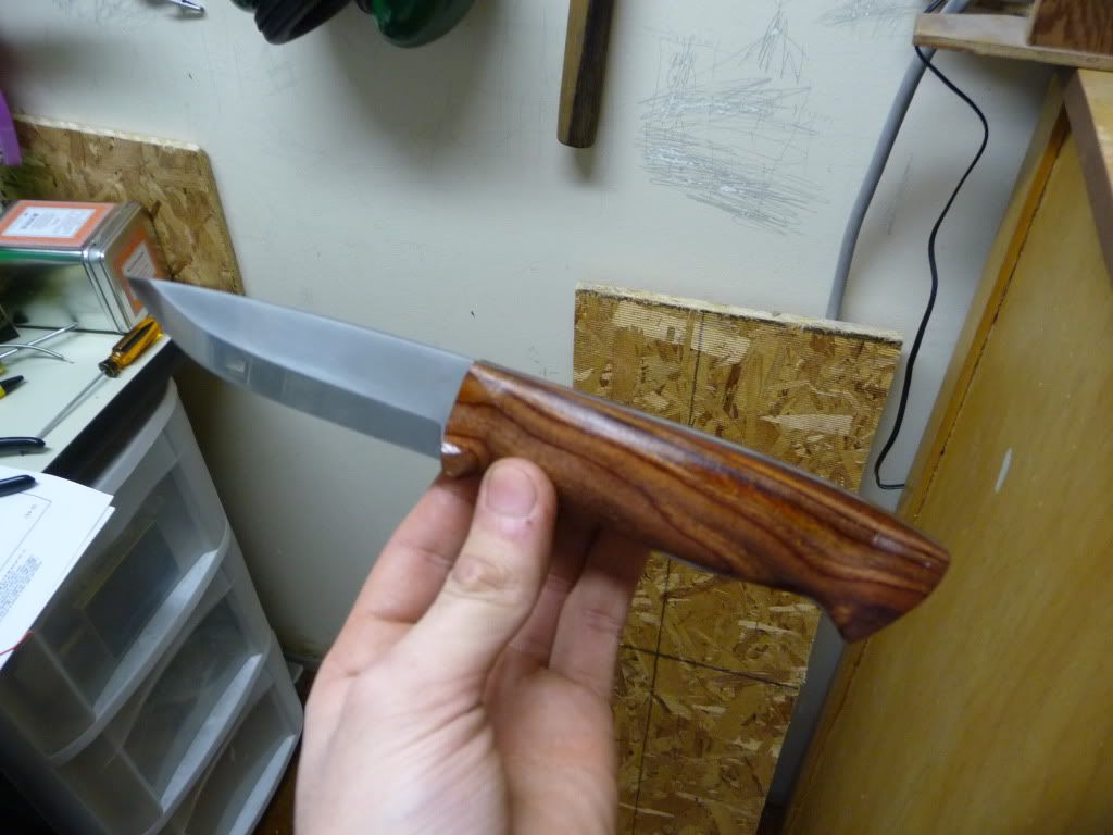

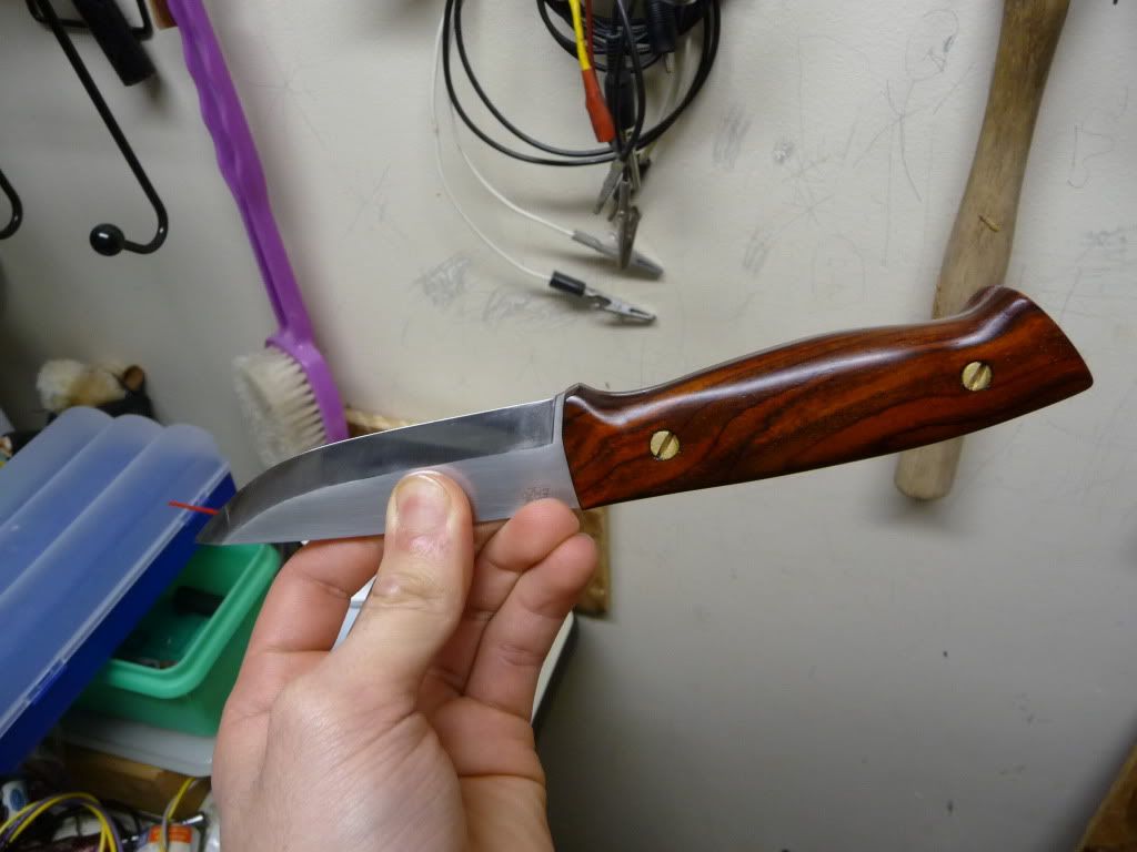

So here's the final product as far as the knife is concerned:
I added red spacers and the slabs are removable (though I doubt I'll be wanting to switch to O1 since I'm really loving this D2).
The wood was polished up to 400grit then treated with multiple coats of Tru-Oil. The knife itself has been sharpened up to 6000grit then stropped on a .3micron chrom oxide loaded leather belt to give it a polished and shaving sharp edge.

I've also used it for carving on multiple occasions now and didn't experience any chipping (as people said I might due to it being zero scandi ground to 10 degrees a side). Regardless, I decided to add a very tiny microbevel (~17 degrees a side) with the 6000grit waterstone (you can sort see it in the first picture above) after finding out that very few true scandis are actually zero-ground (upon closer inspection, brand new moras even have tiny microbevels as well!). I tried making some feather sticks and doing some other carving after the addition of the microbevel and noticed absolutely zero difference in performance. The edge is probably much tougher and less prone to chipping/rolling now though.
Admittedly, I haven't tried batoning with my Trapper. Ever since I got into kukris and (more recently) axes, my requirement that a good knife needs to be able to baton has gone down immensely. Of course I still like my knives to be full-tang and of sturdy construction just in case, which this knife is. I'm sure I'll try batoning with it sooner or later just to know it can handle it, but I've yet to encounter a realistic need to do it as I seem to always have an axe along with me...
The only potentially negative thing I'll say about the knife is that the steel is freaking HARD! I didn't realize that 60-61HRC was so much harder than the 57-58HRC I'm typically used to. It's not necessarily more difficult to sharpen, but it's definitely more time consuming if you don't have diamond sharpeners (I finally ordered my first specifically because of this knife - a 6" coarse/fine diasharp benchstone). The bright side is of course that it holds an edge like you wouldn't believe! I've been using this knife for about a month now - doing everything from carving up seasoned oak to dicing up a whole pineapple - and without having touched it up since the original sharpening session, the thing can still shave!
I still have to make a sheath and matching firesteel for the knife, but all-in-all, I'm very pleased with this blade. No longer do I feel guilty for owning a number of good blades but opting for a cheapie $15 mora just because I prefer scandis :p
