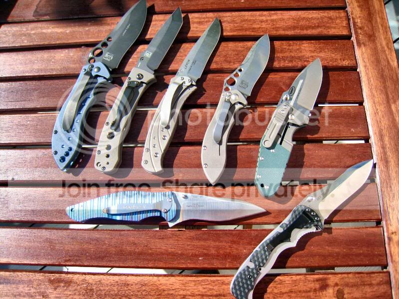

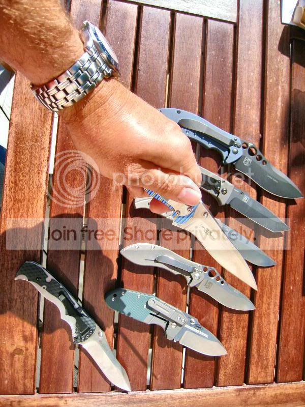

Year, there are photos anyway:
They are crap, but well, show that I am not lying - so will do.

Did you swipe those knives from your neighbor so we'd THINK you owned a framelock? More pics displaying a name tag plz!! :D
Year, I knew that would not be enough! :D
Though isn't it sort of funny that some people would imply that owning something IS experience... ;)
