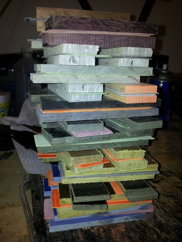

I now have all the blades heat treated. Here's what I have to do next in order:
1. Grind of the decarb and scale from heat treat, grind the edge to final thickness, grind the flats to make sure everything is nice and flat
2. Stonewash, acid etch, or scotchbrite to obtain the final finish
3. Etch my name in the blades
4. Cut all the scales and liner materials to size, match them up, rough them up with rough sandpaper so the epoxy will adhere, epoxy the scales to the liners
5. Drill out the holes for the tubes/pins and cut the tubes/pins to size. This last part takes a long time because the tubes have to be exactly the right length and deburred
6. Shape and finish the ricasso end of the scales
7. Apply epoxy to the scales and flare the tubes while epoxy is still wet. This is a messy operation. It tests my patience when a tube splits or a piece of wood cracks. Thankfully I don't have to worry about this with G10 or Micarta. Clean up the extra epoxy that oozes out and give it a few days to set
8. Shape the handles with the sander then hand sand to 400-600 grit. Buff with pink polishing compound. This is also when I polish the spines.
9. Give them to my wife to inspect. This is when I'd love to hear her say, "ooh, these are perfect!" Unfortunately I usually hear, "These aren't done yet" and "this one needs more handle work"
10. Cut out the kydex to size, heat up, press, drill, rivet, shape, and work on the "snap" as needed
11. Take pictures and post
12. Sharpen, package, and ship.

Just got the logo etched in all of them and a few stone washed. I'll acid etch tomorrow and start on the handles.
I promised pictures so here is one of all the neckers on my desk. They are covered in oil to keep them from rusting.
