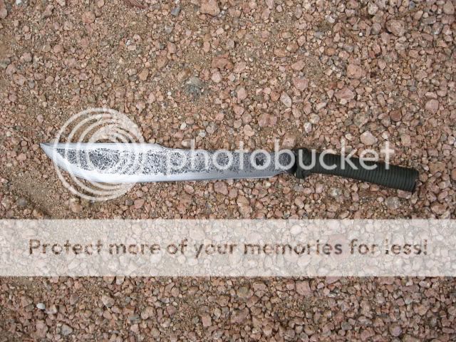

Here's where my first go ended up:
I went and beat around on some hackberry and a pecan log with it and am pleased with how it handles. I think it'll be on my table at Blade. In the meantime, version #2 is out of the vinegar and ready for stock removal.

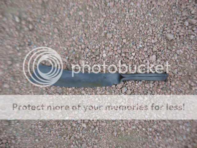

Looks like all the cool kids are going with blunt-ended choppers. Maybe I should jump on the bandwagon and field this instead:
Nahhhhhh.... :D
Blasted camera is doing weird stuff with its focus. I'll take the big camera down to the shop.
OK, this is kind of funny -- I was helping a friend break in his new baby propane forge this weekend and we bashed out machetes from lawn mower blades that look suspiciously like those last 2 pics...
It's a very utilitarian shape that is easy to forge out. Downfalls are drilling and tip penetration, obviously. All designs have their strengths and weaknesses. That's what is fun about these types of challenges. It is cool to see how each of the makers' interpretations work out.

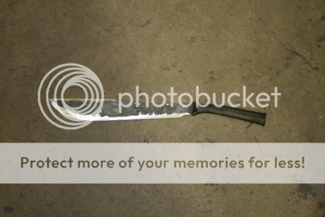

The Mk II version is now ready for heat treatment.
I need to do the stock removal on four more big blades for the Blade Show and then I'll heat treat them as a batch, including the Mk II.
Notice that the false edge isn't as well defined on this one. I wanted to just even it up a bit and not thin down that section much, leaving it plenty thick for hammering.
