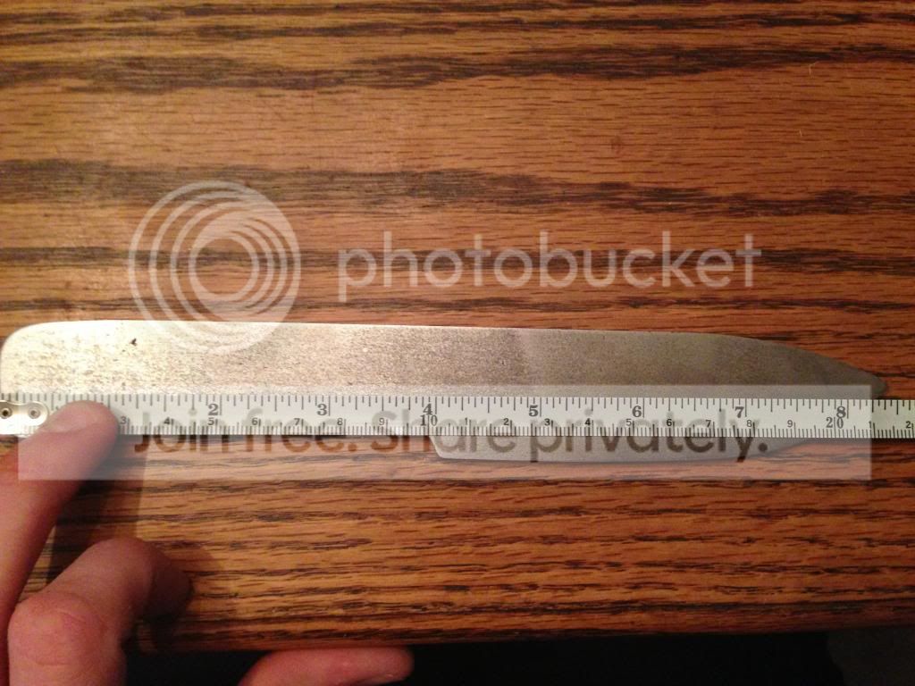

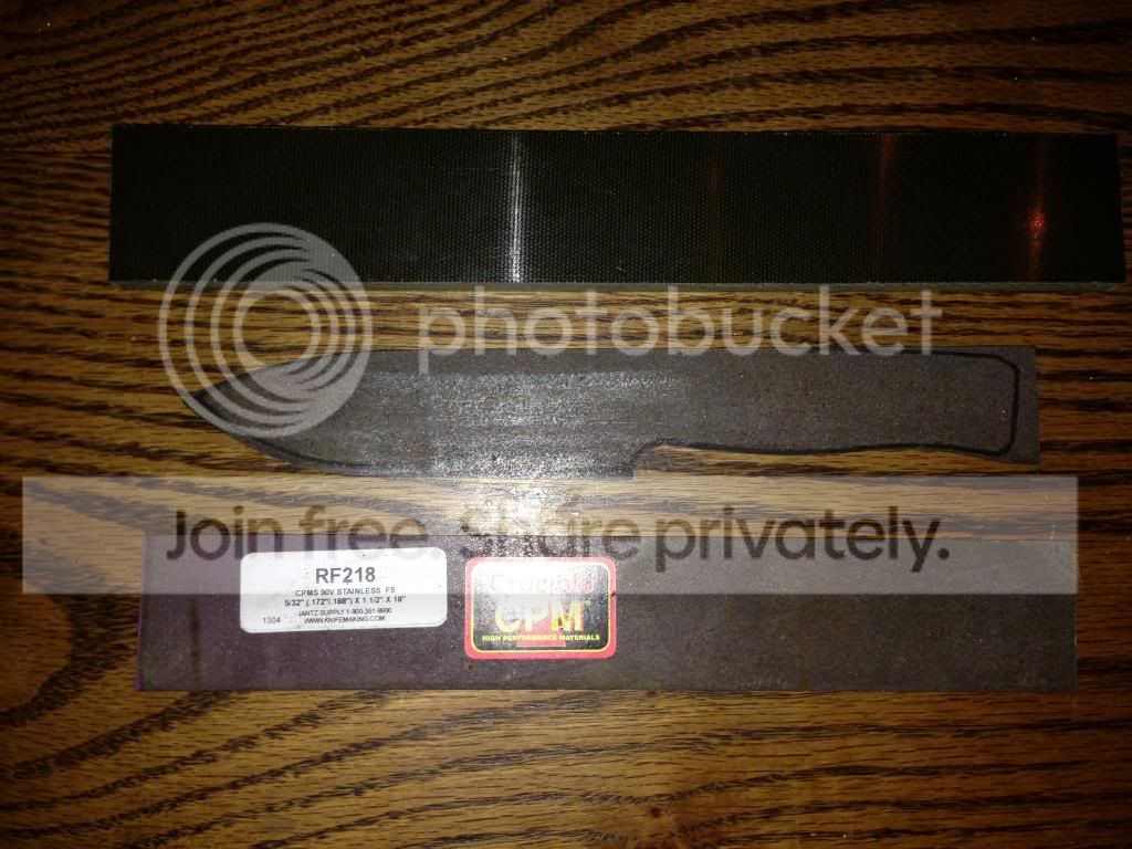

Started a thread a few days ago about wanting to make a fixed blade. I decided to make a WIP because I enjoy looking at the them myself.
Info:
Full flat grind
3/16" (.188) CPM S90V
3/8" Olive Canvas Micarta scales
White G10 liners
1/4" Satin Chain Ring Bolts
Also will be making a gray Kydex sheath

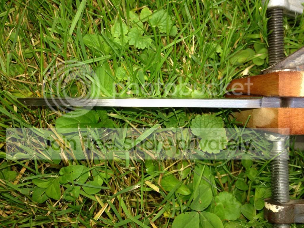

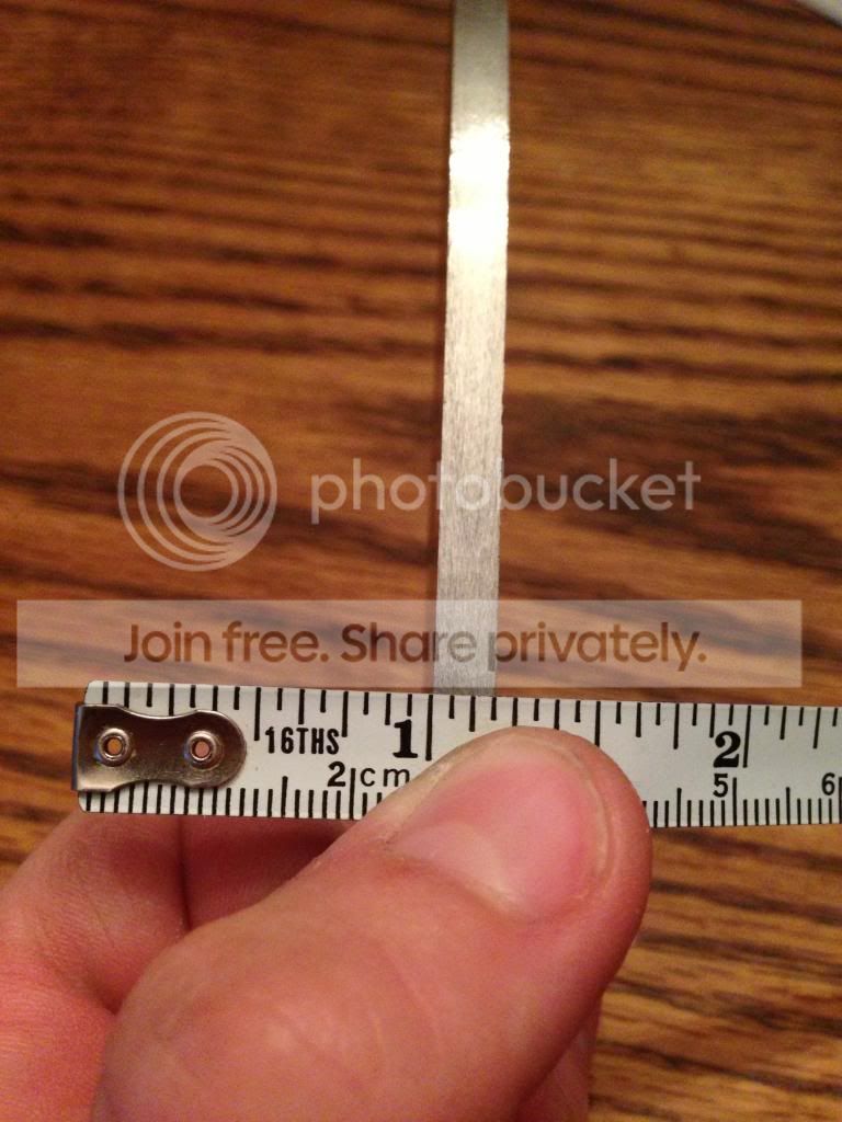

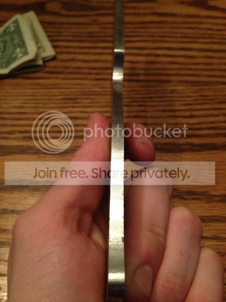

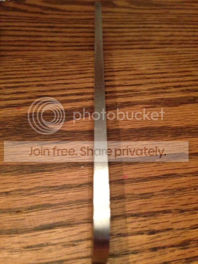

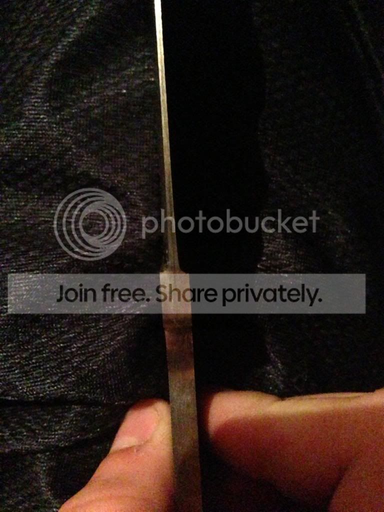

The steel has an ever so slight bend in it and I dont necessarily have to tools to flatten it. What do you suggest I do?
Wooden mock-up

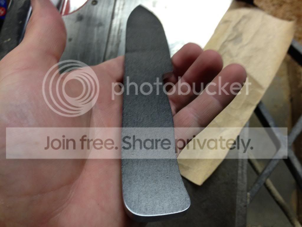

10" of micarta, rough profile of knife, and the rest of the 18" x 1.5" S90V

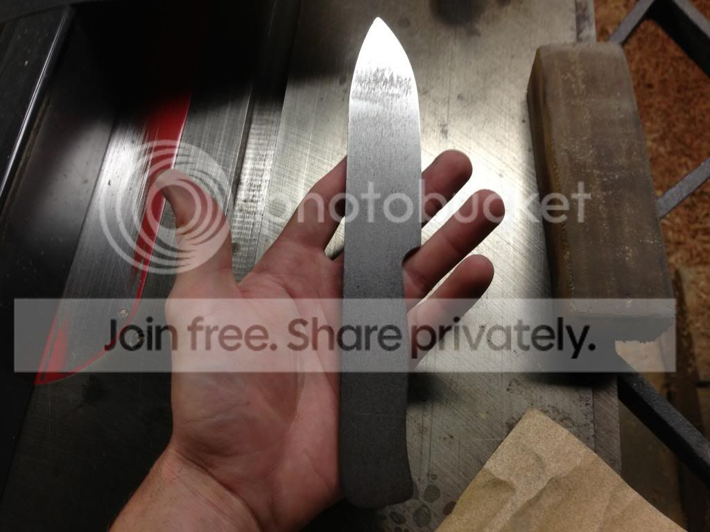

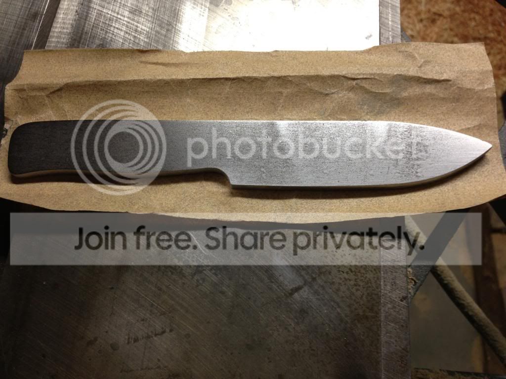

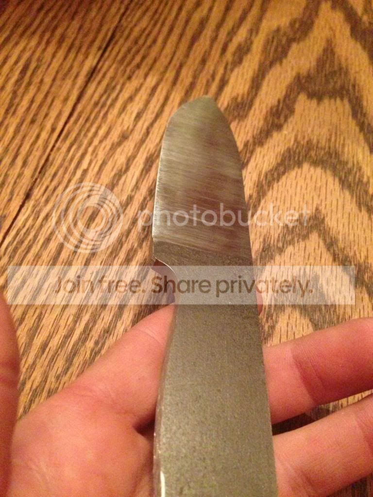

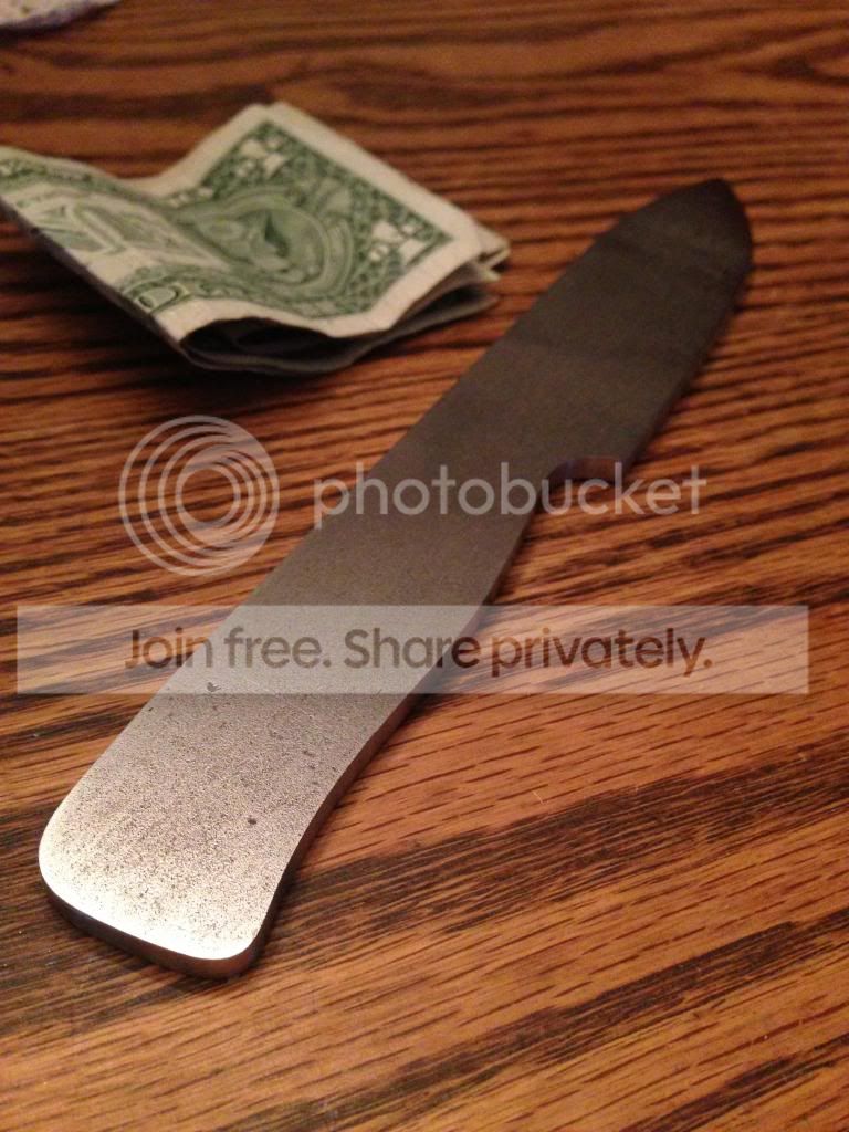

Just about finished with the profile

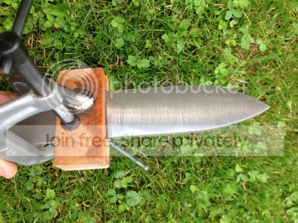

You can use the belt sander to help you do the bevels. Start with course belts. How to make it ease to do is to mount the sander upside down say in a vise, tape the switch so it's always on and use the plug to start and stop it. You might be surprised to see how well it will work. Frank

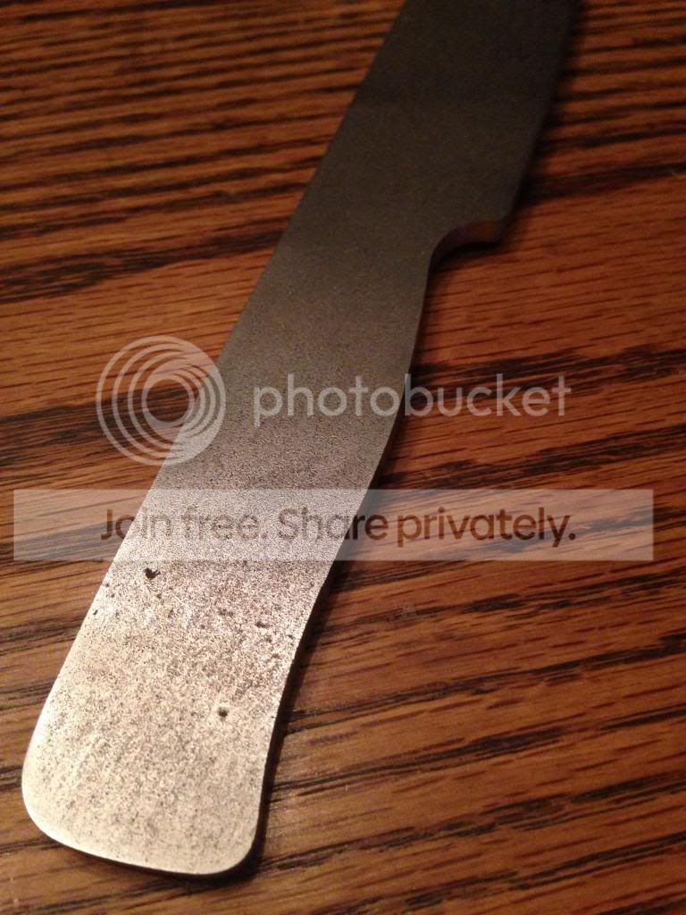

Sounds like a plan, Frank. I guess that's about the best I can do with making the bevels. Ill probably use a file near the end to flatten them up. Have any tips for making a nice, clean and sharp plunge line?
I forgot, for the bend. Place the blade over say two large nails with the heads cut off, place the nails so they are under the blade on each side of the bend, now hit the blade with a hammer, check it, set it up and hit again if necessary. Frank
hmm, interesting tip. I shall try that. Its hardly noticeable now that I cut the 18" piece in half. But whole, It was just slightly noticeable.
I did it without the hammer.
I used a heavy clamp to press the middle down. Same thing.
I like your wooden mock-ups!
You can make nice plunge lines with a chain saw file. Only file as app. half as high as you want the plunge line to go (spine to edge) the rest will come by itself
Thanks, it was an idea suggested by a member hear! Ok, a chain saw file sounds like it would work good

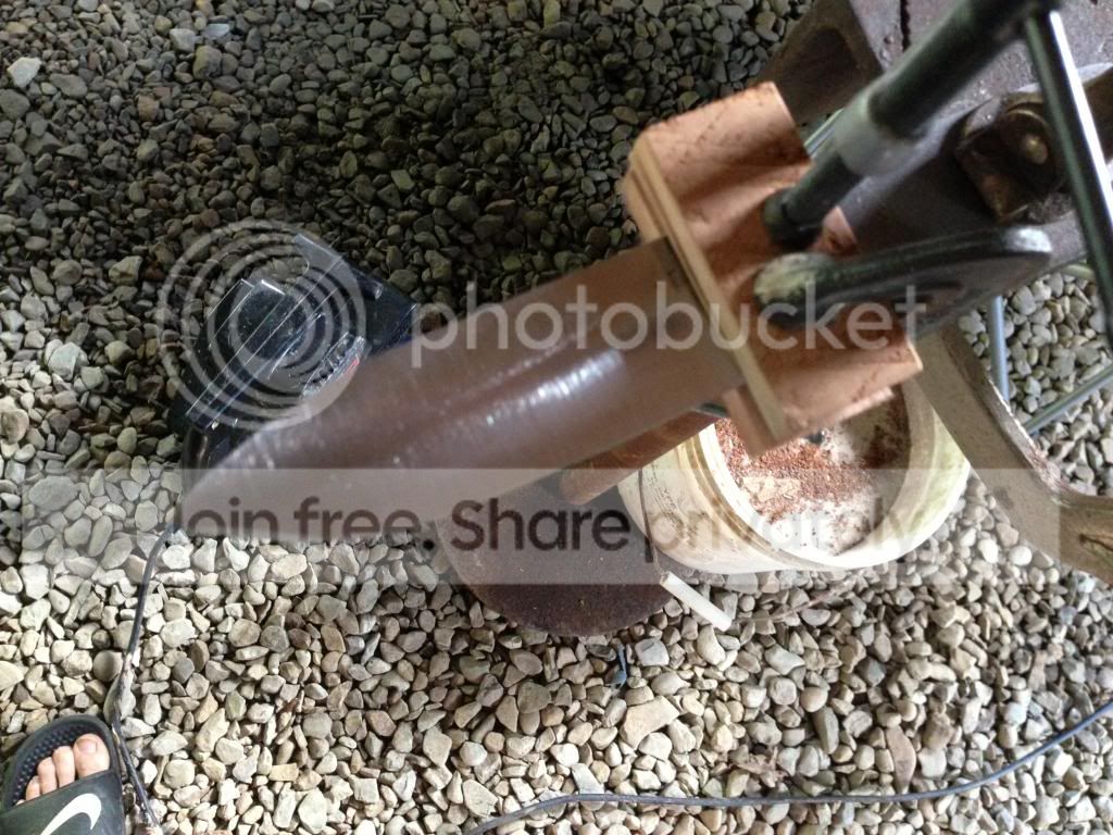

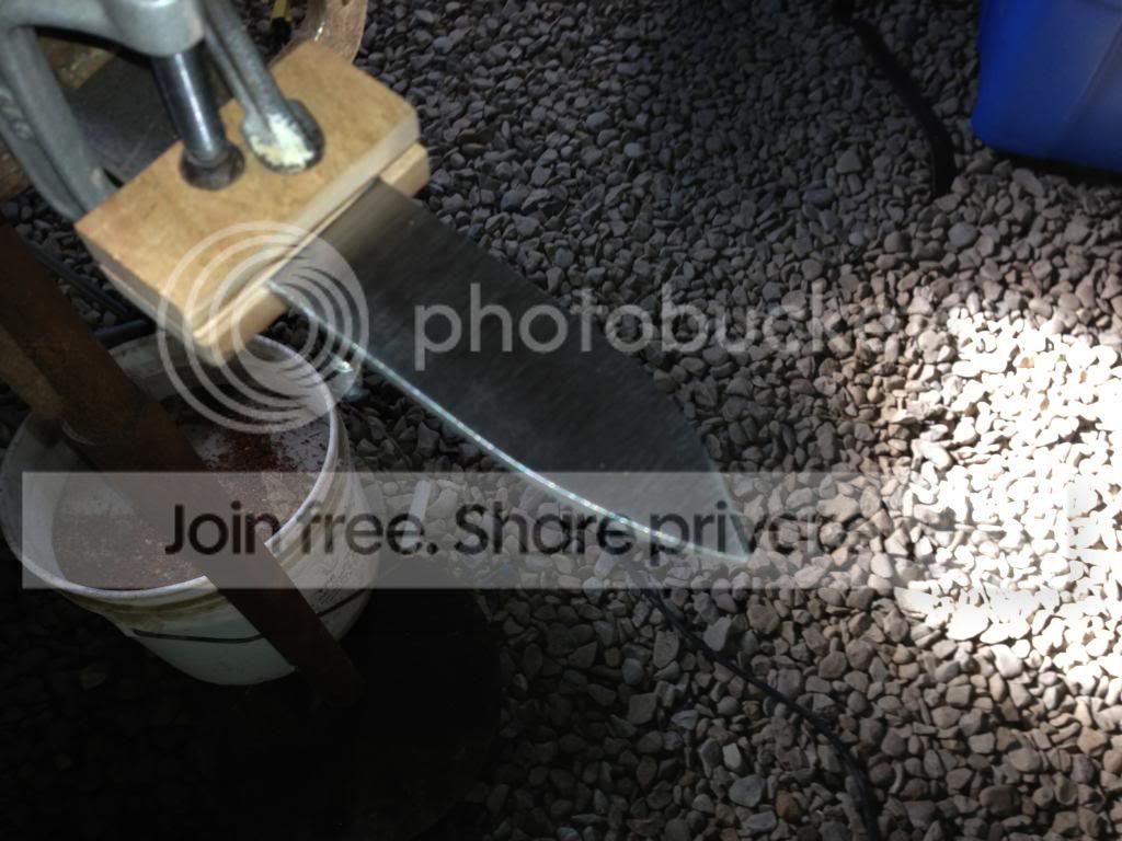

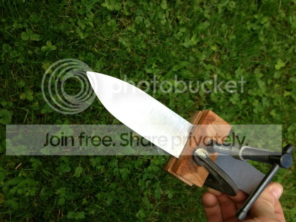

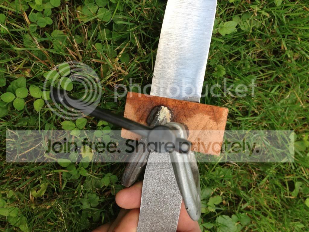

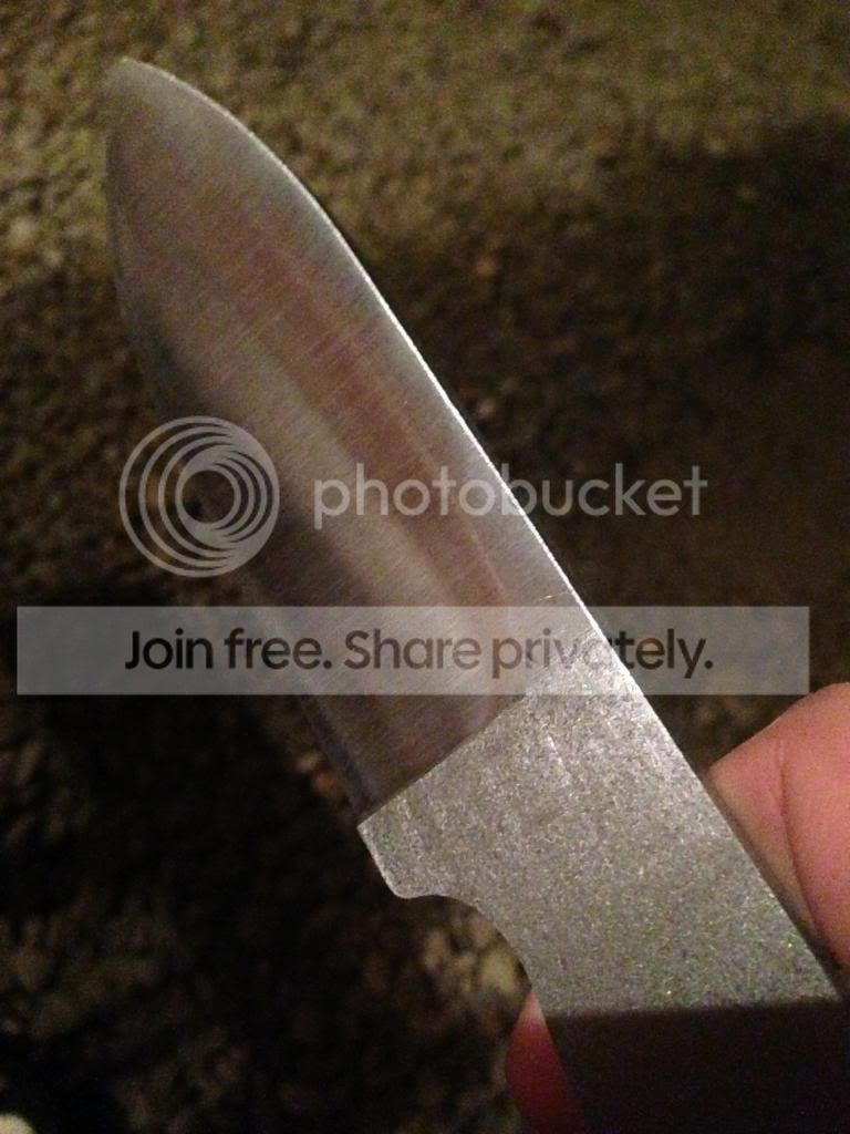

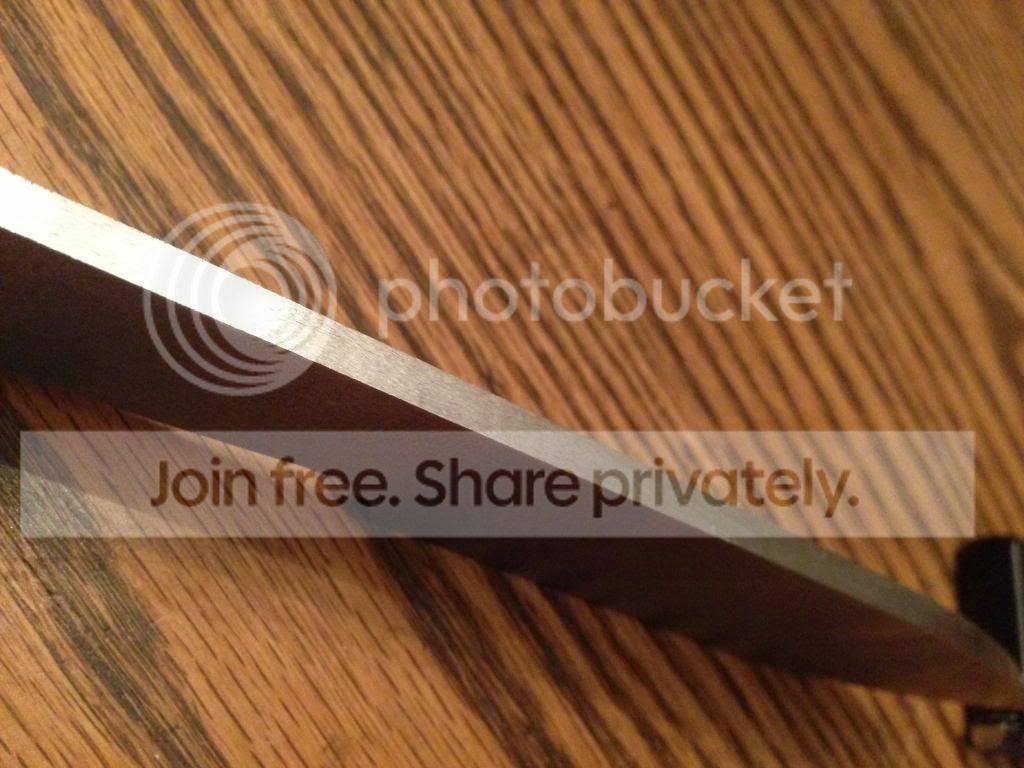

Thanks for the replies, everyone. I bought some more 40 grit 3 x 21 belt for the sander today. Finished about 80% of one of the bevels a few minutes ago. Im now starting in on the other side. I clamped the blade to a stand, as you can see in the pics, instead of putting the sander in a vise. This is working well so far.
If you think that takes forever, trying using files on 1/4" thick stock, last time I buy that thickness ever again.
Sure looks like you've got that under control as best would be expected. . I loaned the one I used from my brother. He knew in advance how I was going to use it even though back then the sanders were way expensive. It told me that a belt sander for grinding was the way to go. After a 4" X 36" and a 6" X 48" I finally got a 2" X 72". Frank

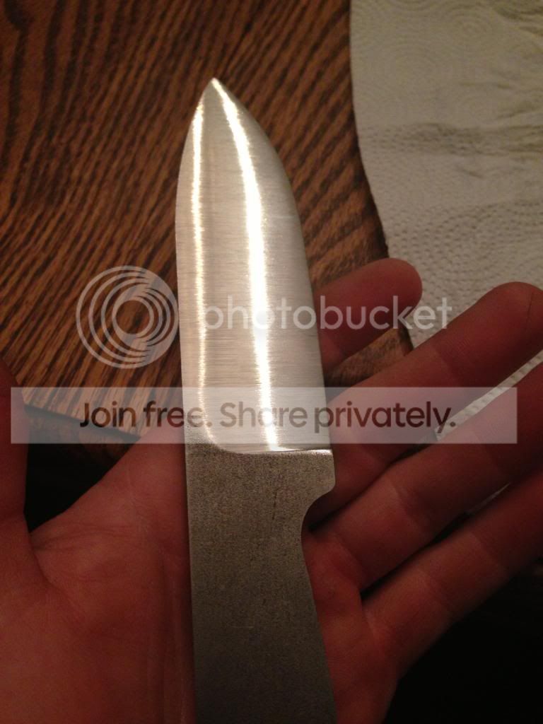

Yeah, as best as to be expected is about right. I had confidence that I might be able to do something decent before I started but I'm surprised at how well the bevel grinding is going. Im just about finished with both sides. I have to fiigure out a way to straighten the plunge lines up a bit. Will be posting pictures shortly. It would be a dream to be working on a 2 x 72 grinder!
A 2x72 grinder is nice, but they can make one heck of a quick oops though.... Irrecoverable oops to boot... It looks like you are doing nice work, sticking to a plan and are going to come out the other side with a nice knife. I have enjoyed watching you design, respond to feedback and progress on to the piece of steel. Looking good!
Thanks a lot, you have given me some great tips, along with other members here. Yeah I cant afford to make any large mistakes, the money and time I have spent would just go to waste.
Im calling it a night, here are a few more pics. Done with the bevels, now I have to try and figure out how im gonna straighten up the plunge lines. Ill do that tomorrow.
