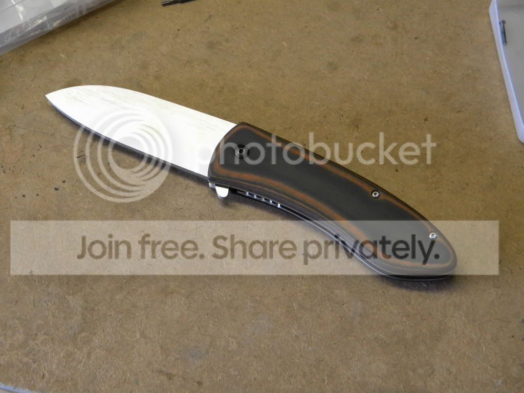

Xander, yes it will have a clip on it. Just need to decide where and how and drill and tap
.Seems like you must have made a few dozen before this one if I didn't know better. It looks great !!! Frank
Very pretty Jon. That thing is smooth and clean. I love the shape. What is the scale material? Looks like a chocolate linen.

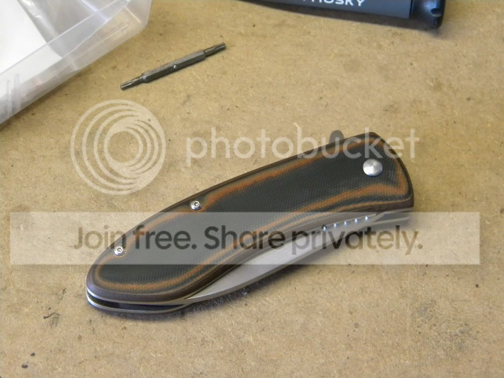

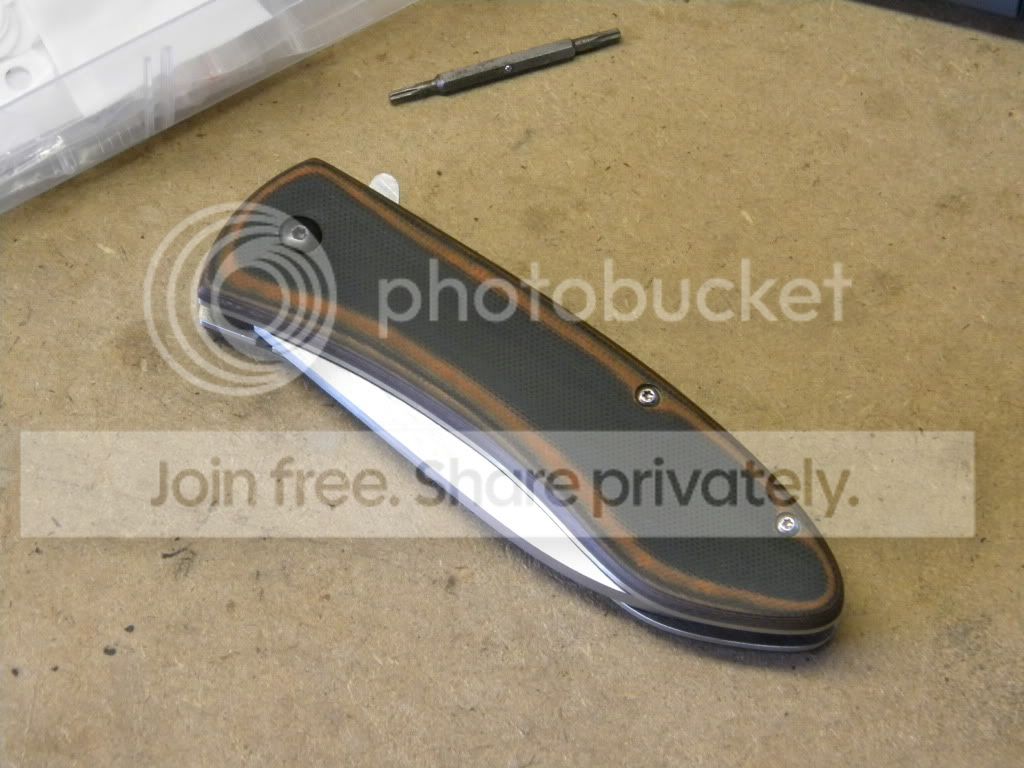

Hey Erik! Thanks buddy. The lighting didn't really make the scales show up all that well. They are actually black and orange tiger strip g-10, but there won't be lots of layering coming through since there's not much contour to them. They're not done yet though, so who knows how things might turn out.......

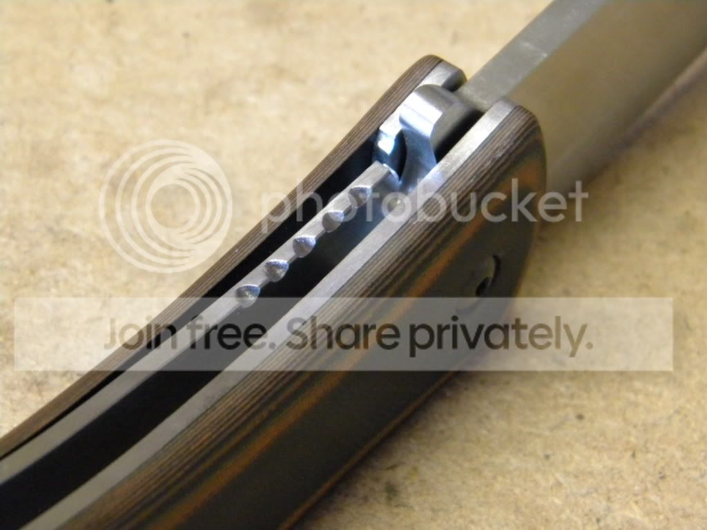

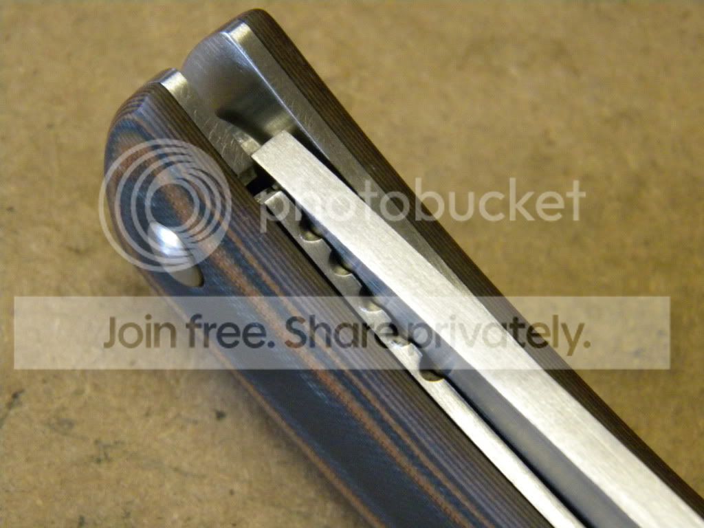

Haven't been able to get the blade hardened yet, so did some other finishing work on the folder until I can get the blade ground. I did the final shaping on the handle slabs, added some jimping to the lockbar, finished the liner profiles to 400 grit, and got the blade all cleaned up and ready for heat treat.
Jonny, that looks amazing! Great work, you never cease to amaze me...
Thanks Ryan!
