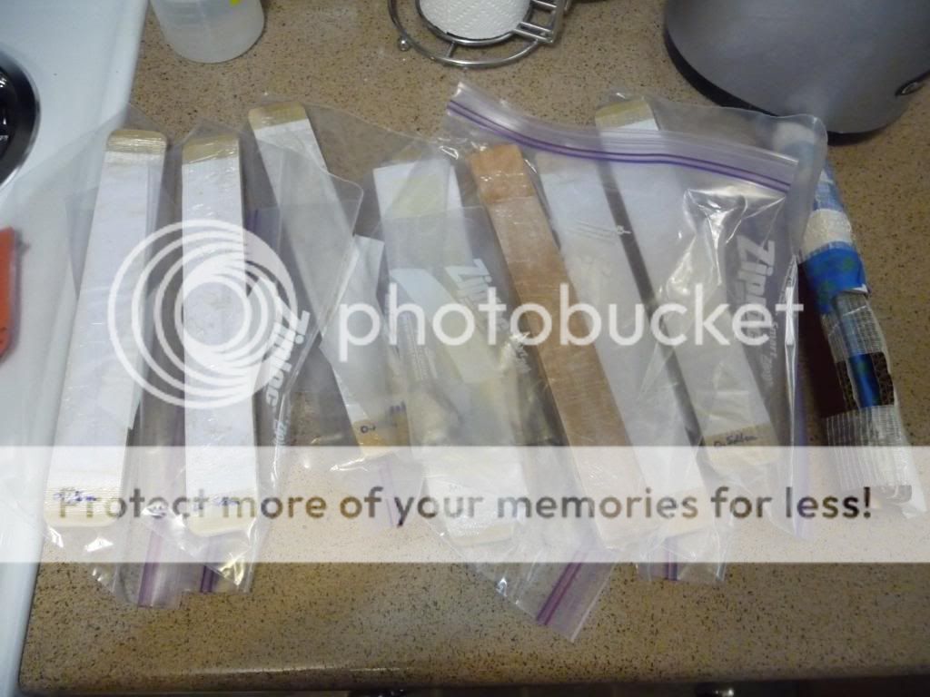

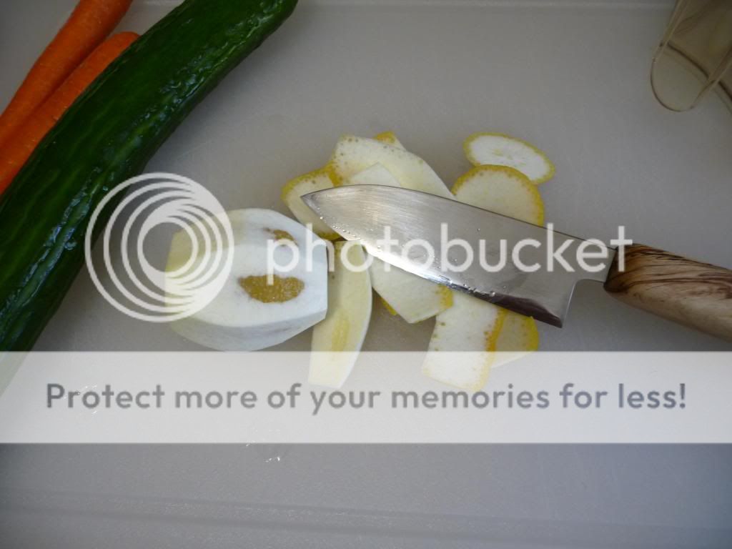

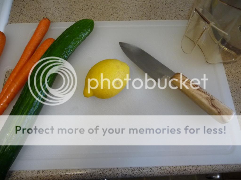

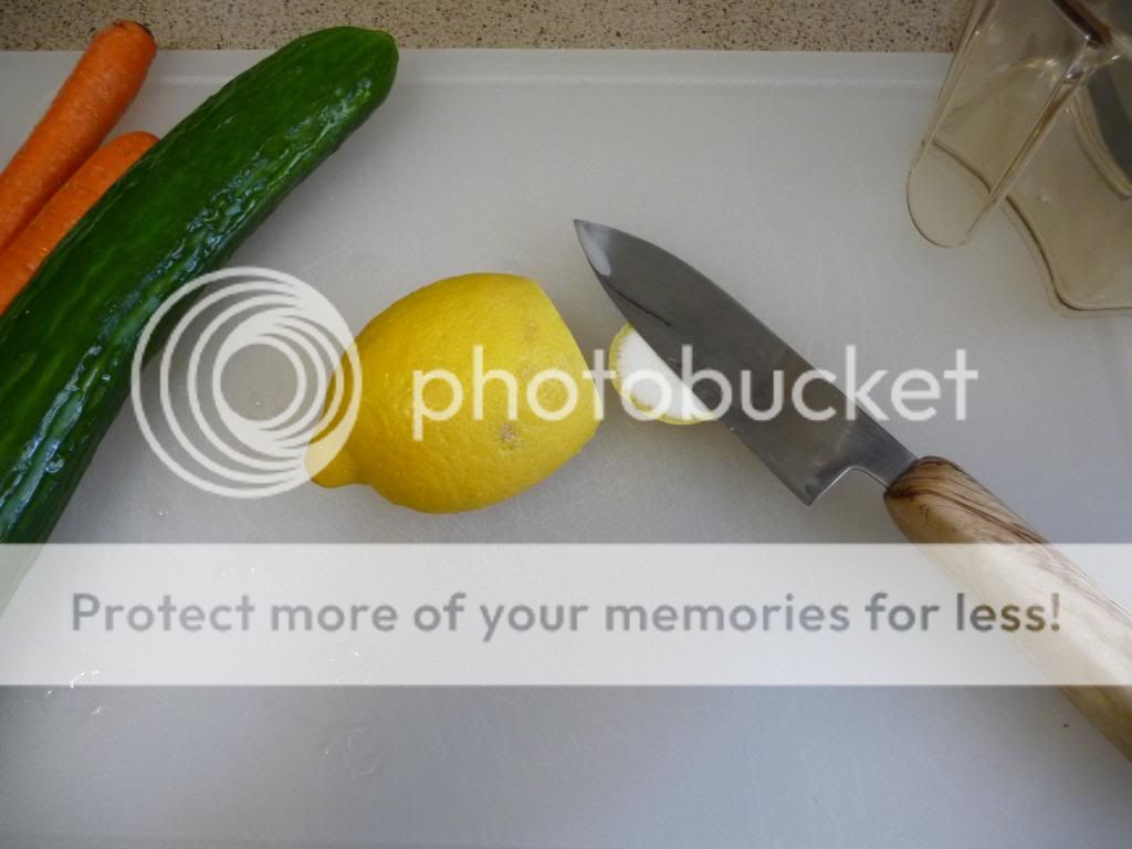

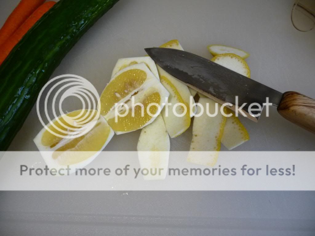

I just got it in the mail, wow. It feels really light in hand which will be really nice for long bouts in the kitchen. I immediately pulled out the cutting board and started cutting. Honestly the sharpest knife I have used. It was insane how it glided through everything. New favorite kitchen knife for sure. They only possible issue is that my fingers are a bit chubby so to chop down to the board they get a little squeeze. I really like the petty design. I was a loooong time petite chef user then switched to nakiri in February with the daily juicing. This is really the best of both with length and belly. I can't get over how easily it slid through stuff though being so sharp and thin. I could only barely feel the lemon seeds. I will need to look up about carbon knives in the kitchen as this is a first. I cleaned it up and dried it well. I am excited to try the balanced strop tonight. I have been using green on balsa for hand stropping for a while now. I used the sharpie trick last night and noticed I need to work on my form though. I don't want to waste the photo paper stops on poor technique. Thanks again Blunt this is a sweet blade!
