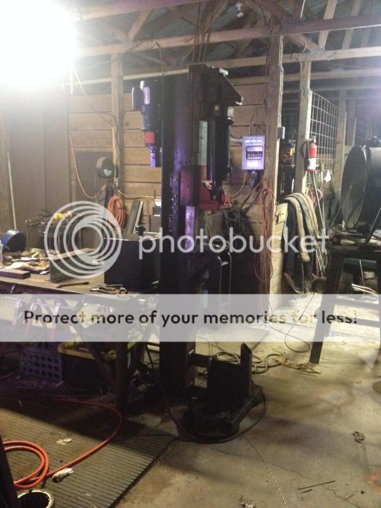

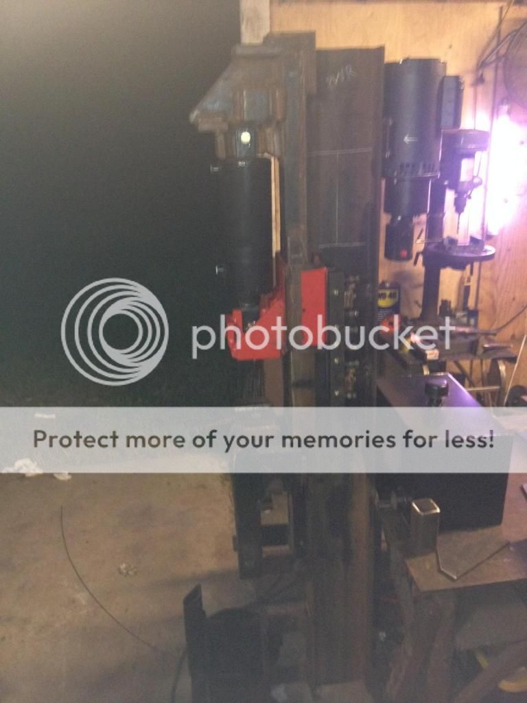

Progress has been steady for the past week. Some pictures of initial mock up. I think that it's current position is actually quite conducive to the shop floor plan.

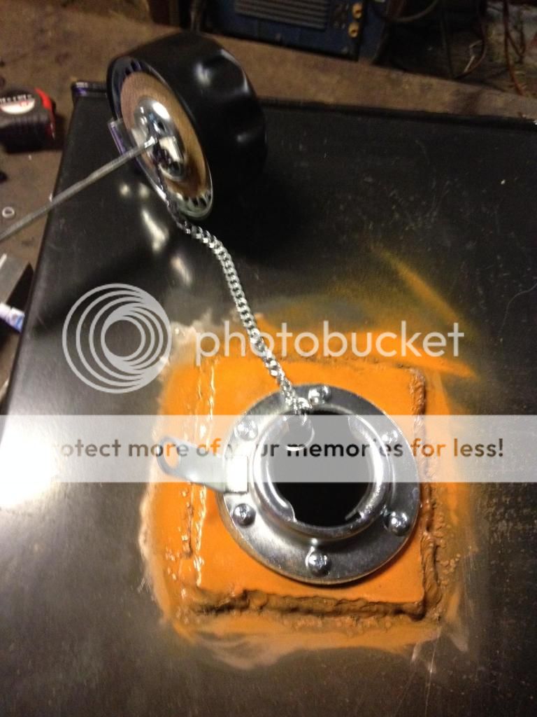

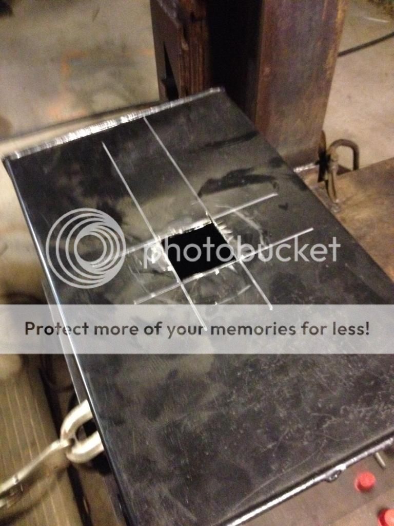

These are additional accessories that I've put in place to keep contamination to a minimum....
Large breather with a finer filter.... It's a 10 micron filter rather than a 40 micron filter which Batson suggests... I have no means of controlling dust particulates in the shop be it that it's open to the elements. It's also a barn that stalls horses, so there's that too... It wasn't plug and play, but I foresee the ends justifying the means....

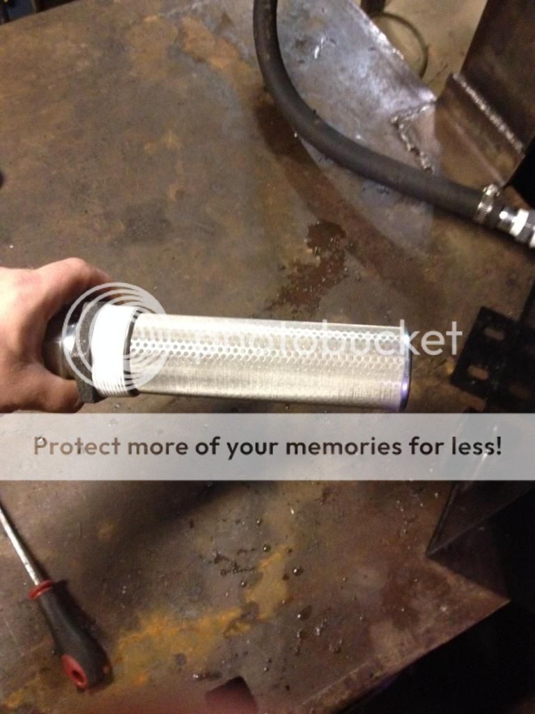

Strainer....
One thing that's of the upmost concern is preventing the contaminants such as weld slag, burrs, shards of drilled steel, and slivers of steel coming off the threads of hydraulic fittings. I'd suggest that when putting everything together you hold these contaminants as a real concern... I went through each fitting with a dental pick, blew out all the hoses, cleaned the tank out twice as many times as I had to. I found a bunch of these little gremlins that would have really done damage had I left it all to chance. A magnet on the tank can only do so much to prevent said damage, so be diligent and meticulous during the initial setup.

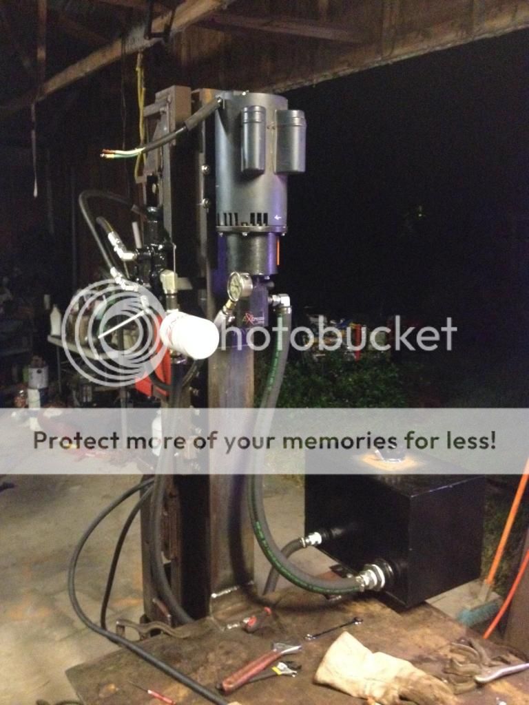

Here is the back of the press all hooked up and ready to go. You can see the foot print isn't too consuming when it comes to taking space on the welding table...
During assembly I did notice that my pump lacked the 1" barbed "in port" and was actually 1/2" NPT thread.... This is not what was advertised on the specs of what I ordered, but if it works... so be it...
Here she is in all her glory... Having overcome a confusing detour of wiring the motor correctly....
Now comes the fun part of troubleshooting...
I will follow this up with a video, but here are the symptoms of the malfunctions... Please feel free to chime in if you have any idea....
