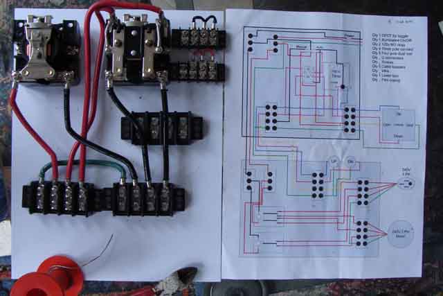

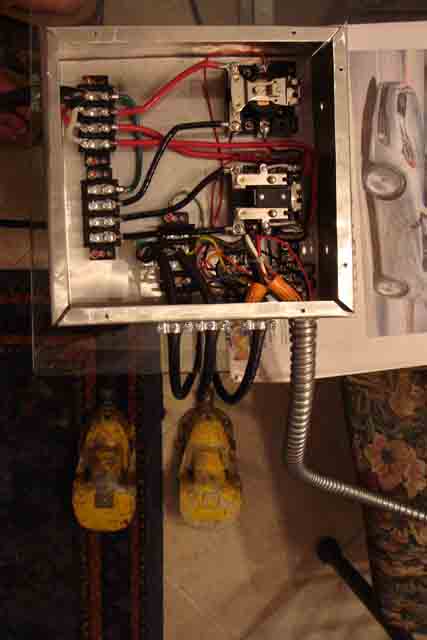

Started in on the electronics that will control the press. Here are some of the basics I wanted to handle when designing the controls.
1. Want main power switch to power control box.
2. Need ability to turn the press on or off with Start/Stop push buttons.
3. Ability to switch between Manual and Automatic mode, controlled by foot pedals.
This picture shows my wiring schematic on the right. On the left is the start of the switching that will turn the 3 phase motor on and off. These components will be housed in their own box directly under the press.

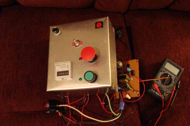

Wires, wires, wires... Here I've fabricated a box to hold the electrical components that will control the press function. Upper right is the main control box power switch, upper left is a fuse holder, center toggle will switch between manual and automatic mode, lower right is the obvious off/on buttons, lower left is the timer that will control ram reciprocation timing when in automatic mode.

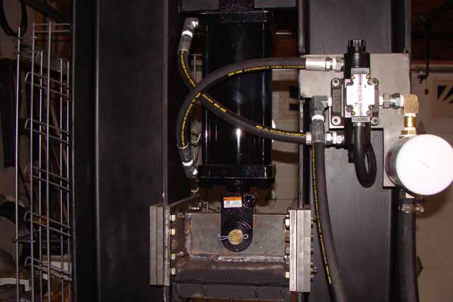

Last pic shows the hydraulic solenoid on the back of the press, all wired up. Now just need to finish the control boxes.
Eric

Well have been gone for two weeks on business so had a few hours to progress since the last time I posted.

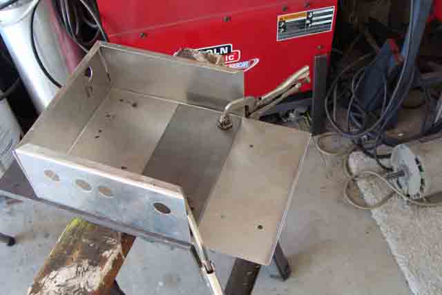

Laid out controller box on piece of sheet metal. Drilled all holes and now folding to shape.

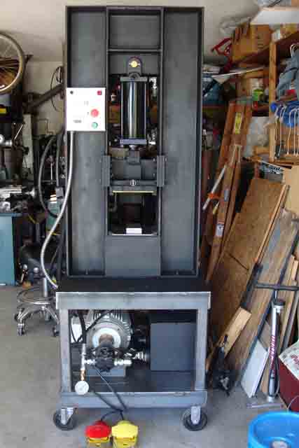

Relays to control switching for 3 phase power all mounted. Foot pedals connected and working.

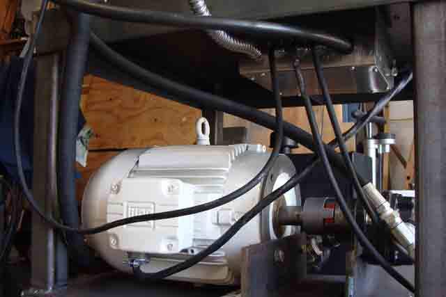

Control box mounted under press frame.

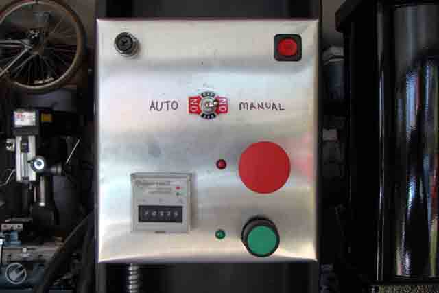

Close up of main control box.
All electronics hooked up and working. Just need to add hydraulic fluid and test operation.

Whenever I'm at this stage in a project I always expect SOMETHING to pop up-some litle thing that needs to be fiddled with.
When I started mine for the first time I found out really quick that my solenoid valve had a 'closed center' spool in it (rather than an "open center" that allows the fluid to pass through the valve when 'idling'.) My 7.5 HP 3500 RPM motor roared to life then "BANG" stopped instantly with a big "crack sound."
Everything was fine, but I had to wait a week or so for the right spool. :(:p

It's WORKING! :thumbup::cool::thumbup:
Got it filled with hydraulic fluid this evening. Both automatic mode and manual mode worked first time! Man am I excited!!! :D:D:D
