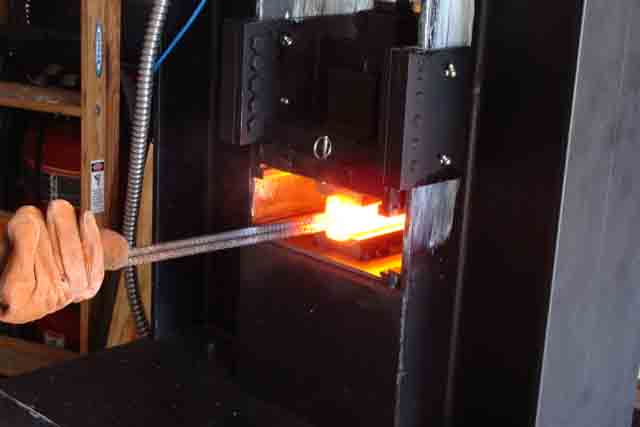

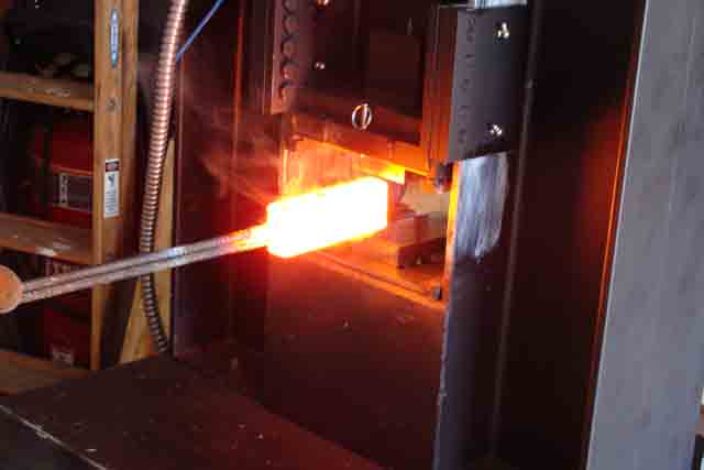

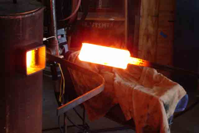

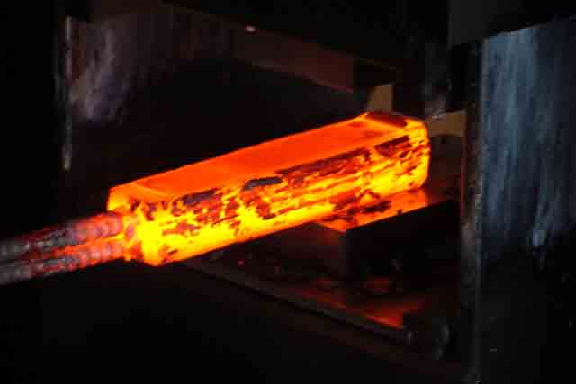

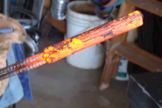

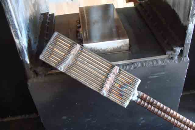

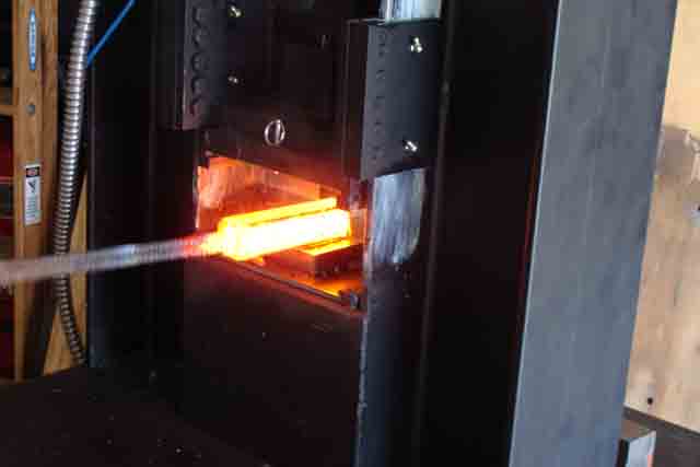

Got to weld up my first Damascus billet today. 1080 and 15N20. Only had my large dies ready so just set the weld. Let the billet cool and welded up the drawing dies but did not have time to draw out yet. Press worked fantastic! Here are some pics...
This is a pic of the billet welded up. Used a TIG welder with no filler rod. No contamination from unwanted metal...
Coming out of the forge at 2300F.
This last pic came out funny as my son had a hard time finding the button on the camera and my hand started really feeling the heat of the rod through the glove. I think I was just starting to say a choice word before switching to the other hand... :eek: :D :thumbup:
