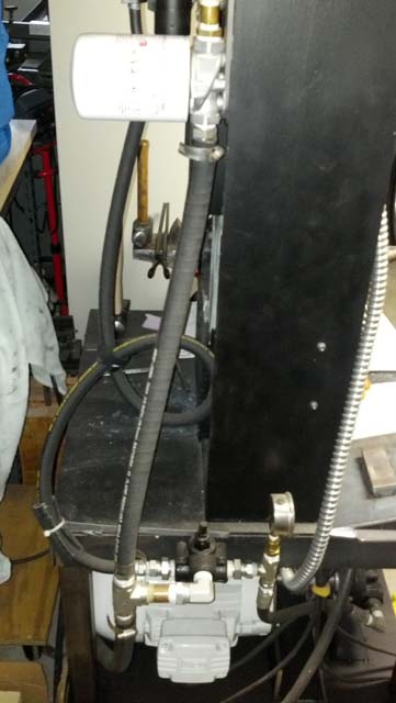

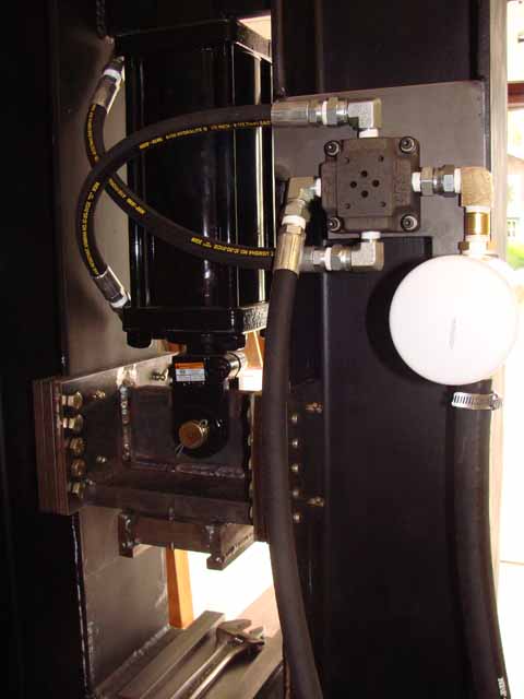

Can you explain the filter routing to me?
In this photo, it looks like you are running full pressure through the filter?
Hello Numbers,
The port the filter is hooked up to is the low pressure exit from the valve block. As you can see just below the filter I am using a standard hose clamp and a low pressure hose. High pressure could not handle this setup. The return from the filter dumps directly into the hydraulic fluid tank return. Let me know if I can answer any more questions for you.

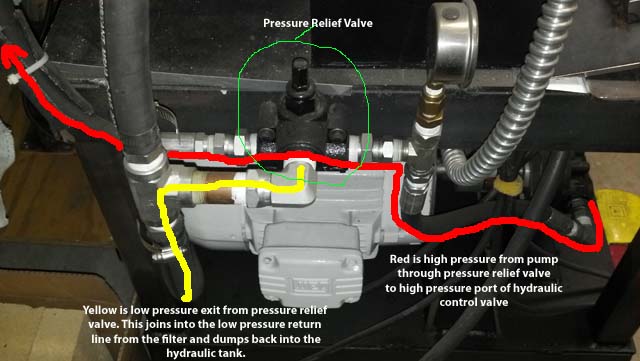

I have had a few people send me messages asking about my pressure relief valve plumbing. Here are some pictures of that setup. Let me know if there is any part of this that is not clear. The stem at the top of the pressure relief valve allows you to dump part of your high pressure out an exit port. By adjusting this stem and watching your pressure gauge, you can achieve the desired pressure.
Is that valve on your PDF file ?
The parts list
No it was not on my original parts list. In post 78 I talk about discovering that a pressure relief valve is needed in my setup. When reading Baston's book, it talked about pressure relief as part of the hydraulic control valve. Well, the electronic control valves I chose did not have pressure relief adjustments. This is the valve I ended up getting --> 3/4" NPT 30 GPM 1500-3000 PSI RELIEF VALVE RV-2H --> http://www.surpluscenter.com/item.asp?item=9-6135-75-H&catname=hydraulic
