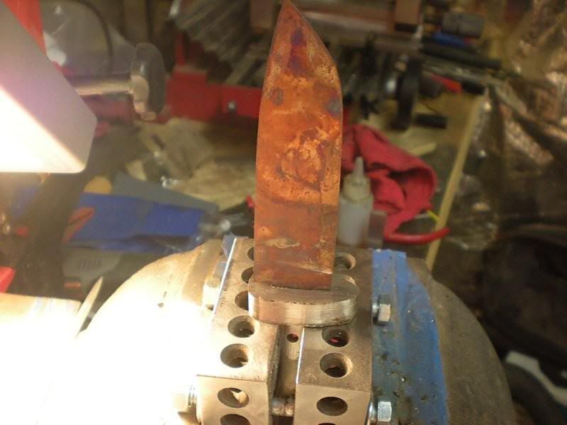

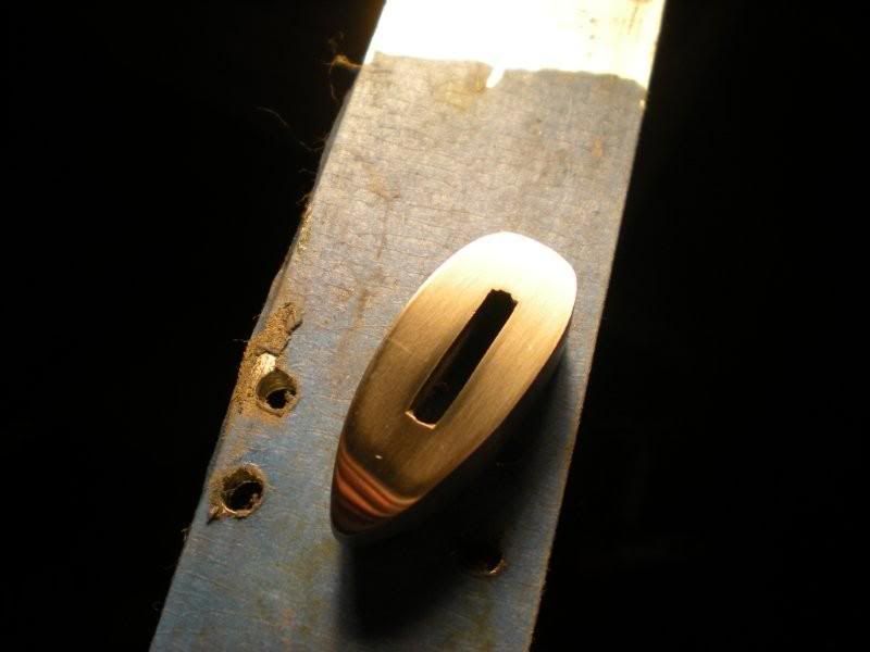

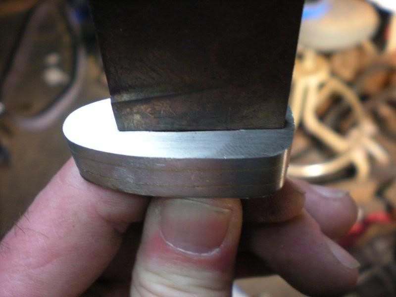

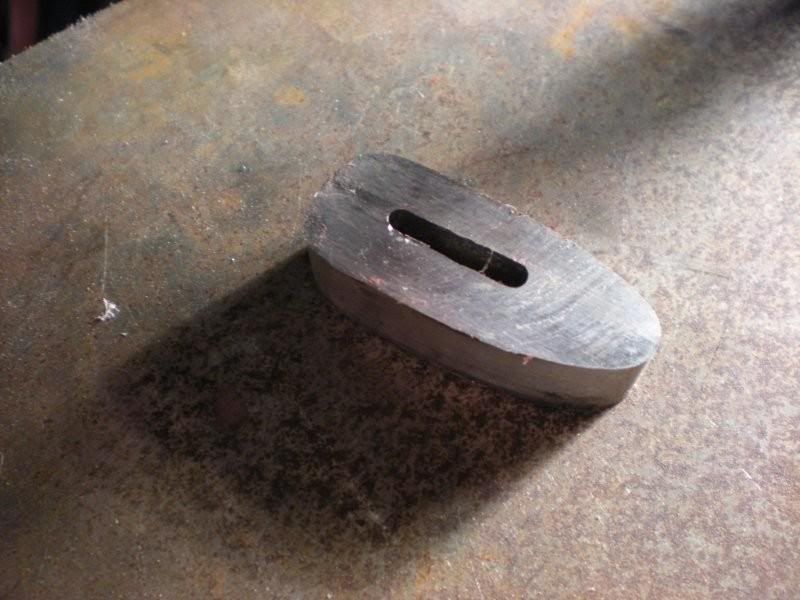

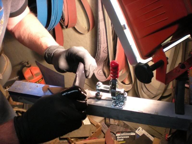

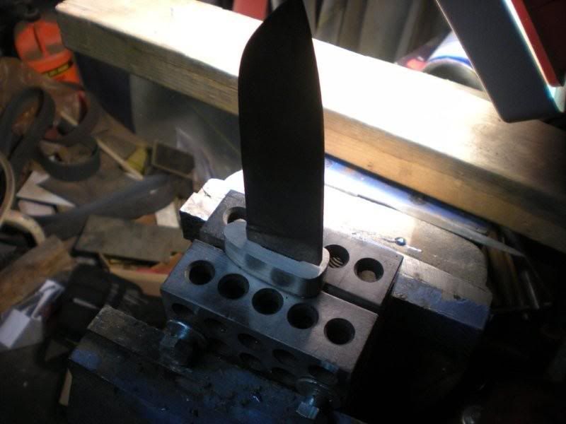

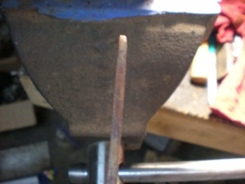

This is great! Looks like it's coming along very well!

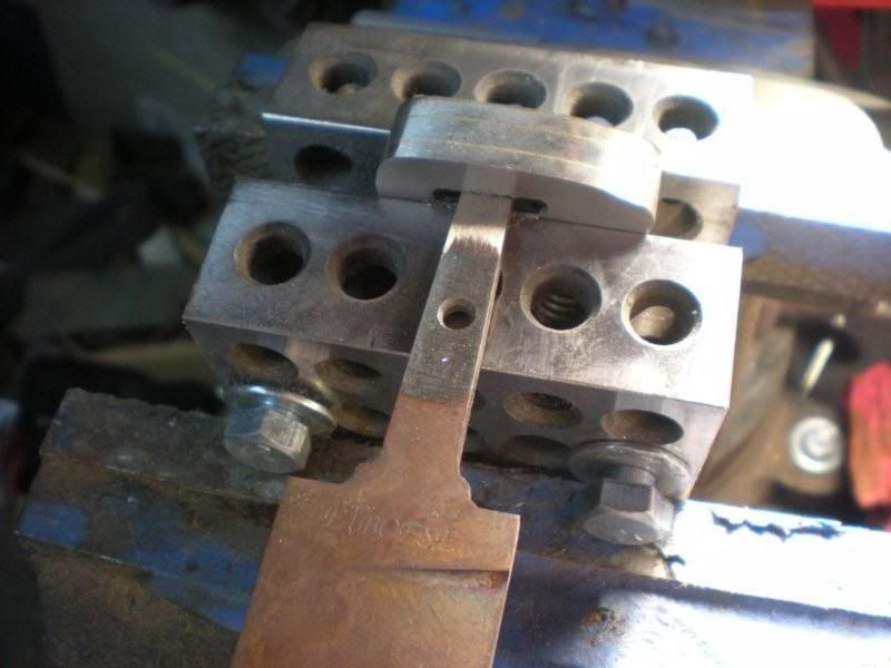

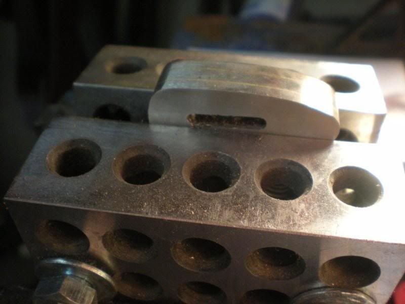

FWIW- It's MUCH easier to fit the guard and THEN shape it. If you fit the guard, then you can use your ricasso as a foundation to lay-out your guard... to ensure it's symmetrical off each side and such. It's also much easier to fixture a rectangular piece of material for drilling / milling / filing... than a rounded one.
I used to do it this way as well, but looking back, it's akin to building a house and then trying to set it on a foundation. It's easier to start from the ground up. IMHO
Just some free advice, and we know what that's worth![]()
I'll have you know Mr. Burgess, I'm having that printed up on a T-shirt!!!!![]()
"Just being good is not enough....... when you're a jerk a$$ knife god. Nick Wheeler Custom Knives" That'd be freaking AWESOME on a tee shirt.

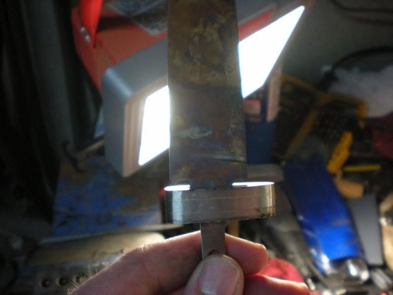

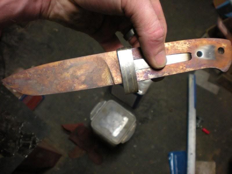

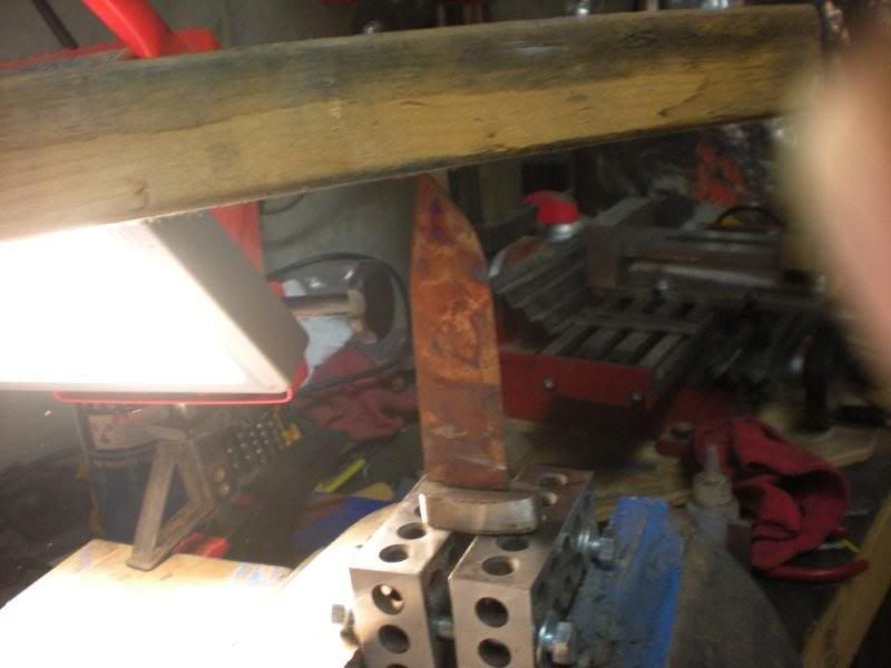

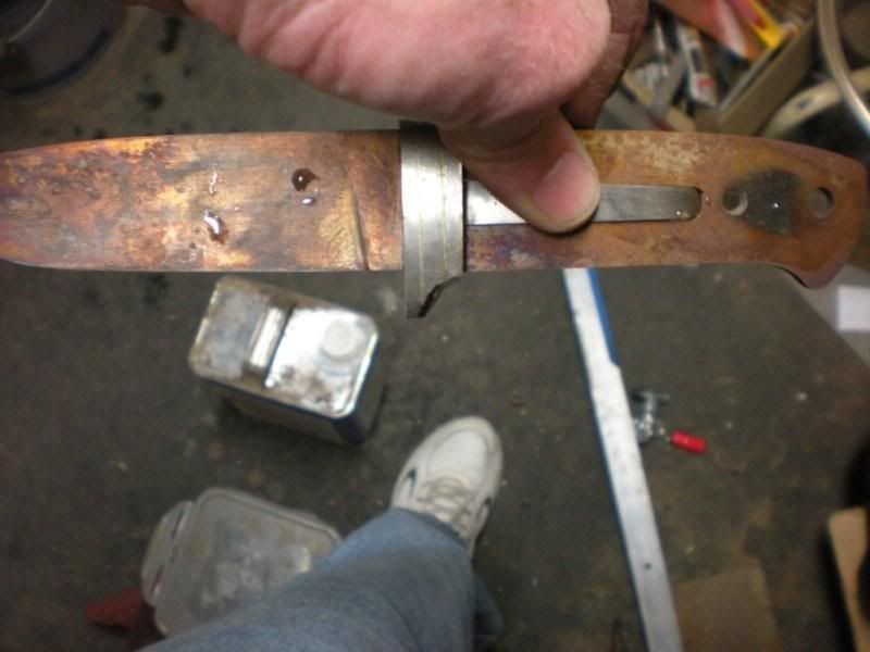

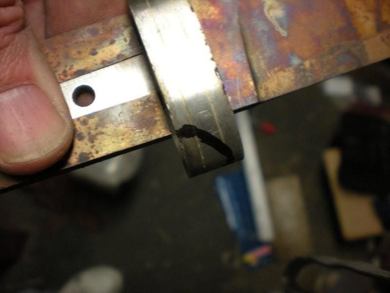

I think it may have been caused by soaking it at 1950° for 30 min then quenched with N2 down to room temperature and then cryo'ed at -300° for 4 hours. If that didn't do it, then the 2 or 3 cycles of 980-1020° tempering may have done it.Damn, Erik! Did you throw that blade into the salt water bucket, drizzle acid on it, and then toss it in the humidor since you last posted?Upon closer inspection, is that just oxidation from tempering and shop lighting?
