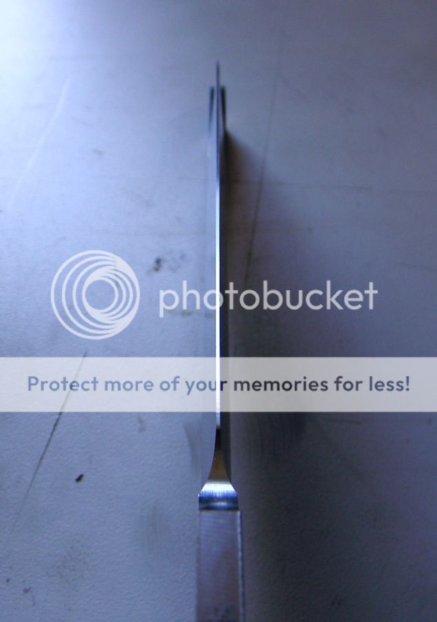

This is the knife I’ll be making:
1.jpg~original

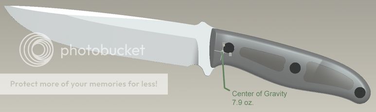

It is a 6” fighter in the same family as my 8” shiv. This will be new pattern.
I won't delve into the design process here because I’ve covered that topic before and this thread is really just more about pictures.
After a design is developed a computer model is made because 3D data is just about a prerequisite for 3D milling.

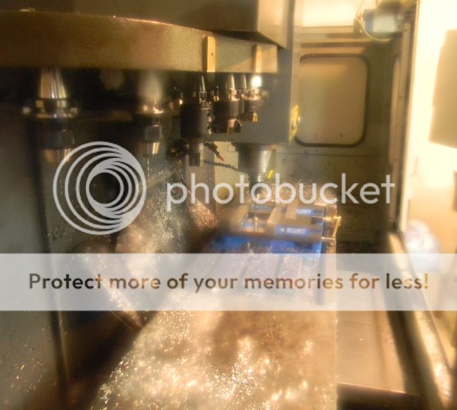

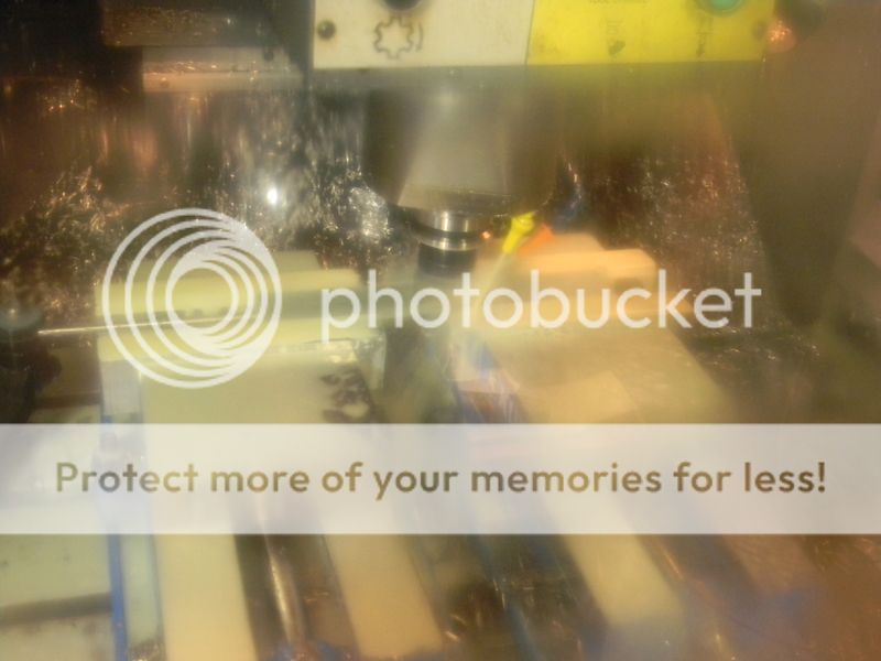

This is being machined in an old vertical machining center. These have carousels loaded with cutting tools, in this case on a chain, that get touched off and can then be called out in a program and used to cut a work piece. I’m mostly using drills, endmills and facemills in this project.
3.jpg~original

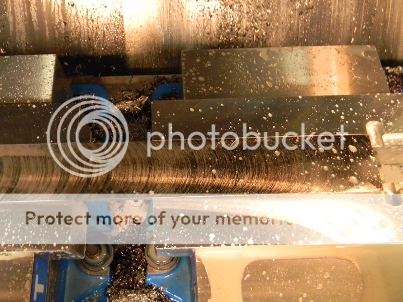

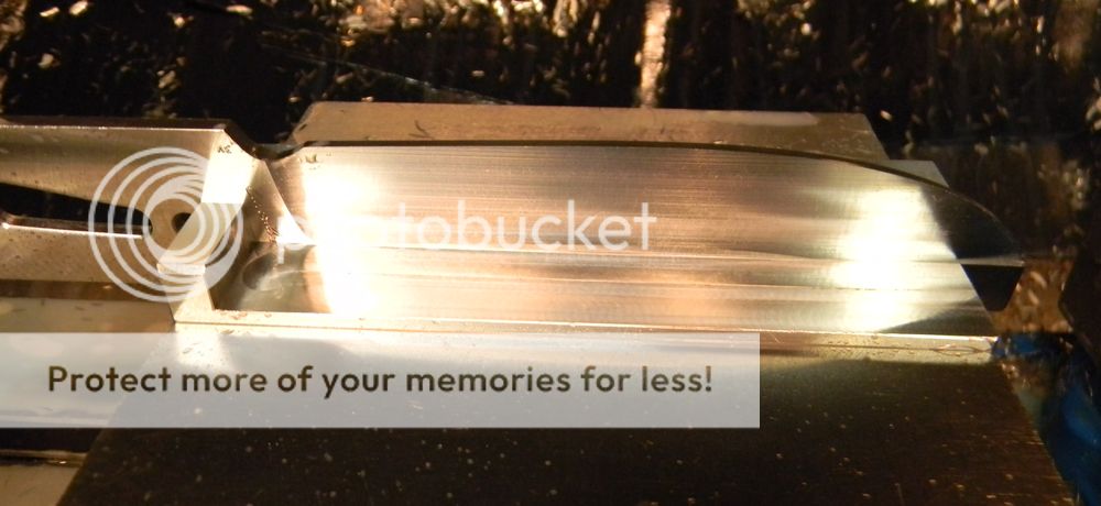

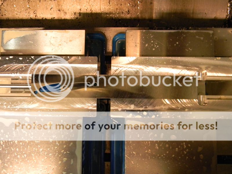

Roughing down the top of a work piece with a small inserted facemill
4.jpg~original
This removes the mill scale and major surface flaws and gets the material flatter and closer to net shape.

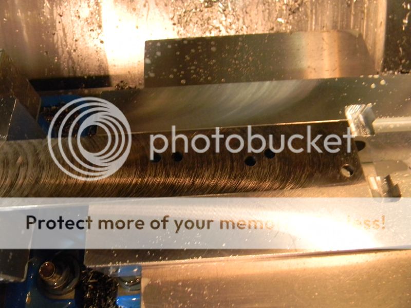

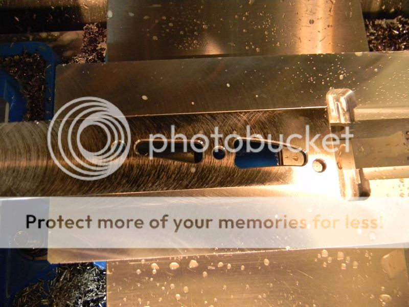

Some holes drilled
6.jpg~original

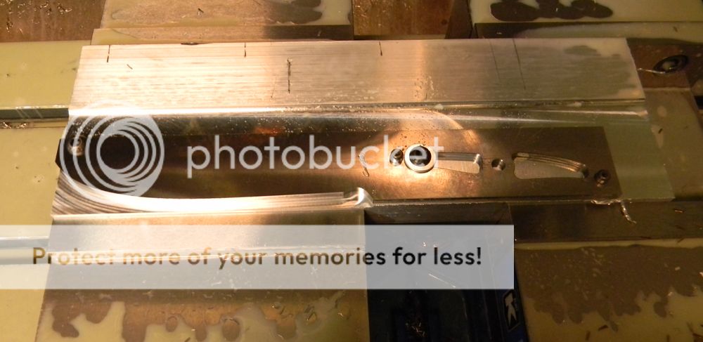

Some pockets milled out
7.jpg~original
Running a finish pass across the top
8.jpg~original

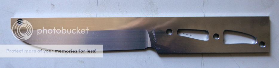

This is CPM 3V here and it is a bear to finish.
9.jpg~original

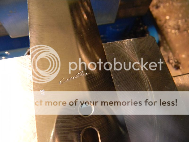

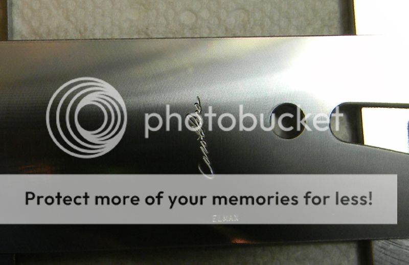

Then I engrave my signature and the steel type
10.jpg~original

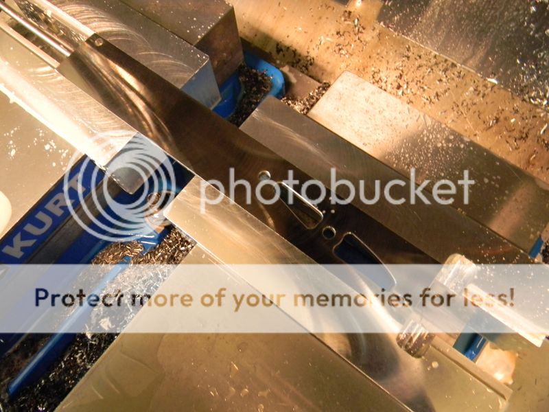

And flip it over and finish out side 2
11.jpg~original
While I was at it I ran some ELMAX too. It finishes out very clean, but it is abrasive on tooling.
12.jpg~original

Before I can mill the bevels the first step is to cut the profile of the cutting edge.
This is a simple one-time-use fixture to hold the blank so I can make that cut.
13.jpg~original
This is a fast operation but it still takes a while to run all of these
14.jpg~original
Cutting the belly on a knife blank.
[video=youtube_share;2O7WBCXoRUs]http://youtu.be/2O7WBCXoRUs[/video]
This is ELMAX being pealed off dry with a 3/8" stubby at 41 IPM and 3800 RPM.
ELMAX is a very high carbon high alloy stainless steel. It is abrasive and it work hardens badly, so a high chip load maximizes the number of parts you can get out of a cutter. This cutter was good for 45 parts.
It is a bit counter intuitive, but modern cutting tools last longer in applications like this if they can be run dry, without coolant. The coating is more abrasion resistant when hot and coolant creates thermal shock issues. This isn't a particularly smooth sounding cut, but the cutter held up half a day like this. Considering the material being cut, that is good cutter life.

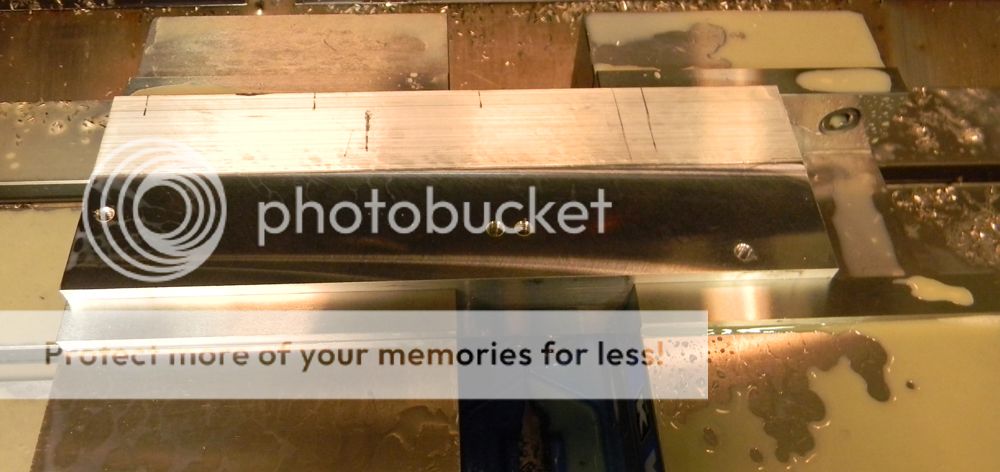

This is the part I get asked about the most: milling bevels.

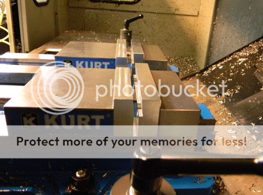

There are several ways to go about doing this including standing the blade edge up and surface milling it and laying it down almost flat and face milling then grinding it, but for this design the best approach is to stand it up at an angle and cut it with the side of an endmill.
Angled soft jaws here:
15.jpg~original
Holding two blades at an angle
16.jpg~original
The milling process. Video, if you're curious :
[video=youtube_share;1nQo7ZQMJxo]http://youtu.be/1nQo7ZQMJxo[/video]

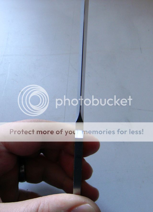

freshly cut bevel
17.jpg~original
18.jpg~original
1_elmax.jpg~original
2_elmax.jpg~original

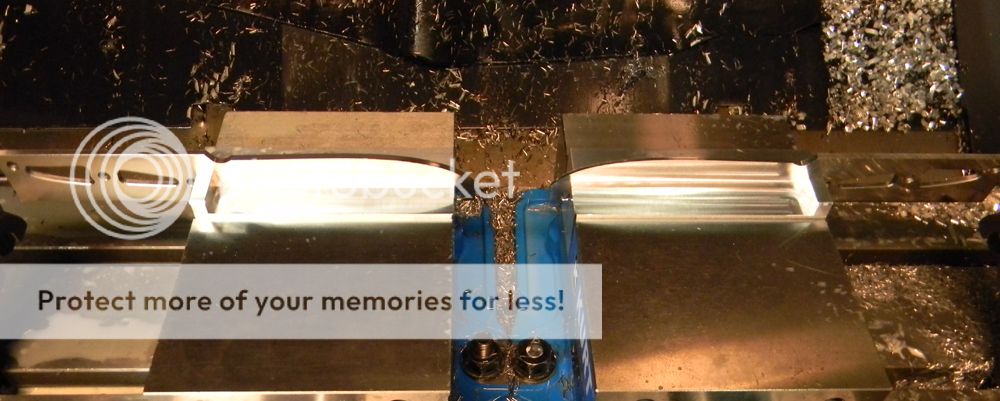

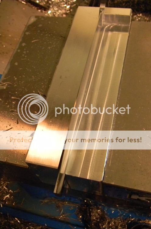

This is why I take this approach:
19.jpg~original
20.jpg~original
The plunge is perfectly symmetric, the edge is perfectly straight and centered and exactly the thickness I intended. Don't get me wrong, I'm not saying that my way is better or that I think I'm a better knifemaker because of it. I'm saying that, for my goals and priorities, there is literally no better way to do this.
