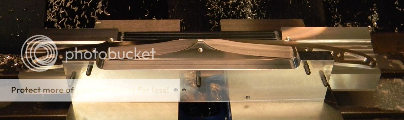

Okay, the bevels are all cut and its time to finish the profile. This is exciting to me because it starts to look and feel like a knife.

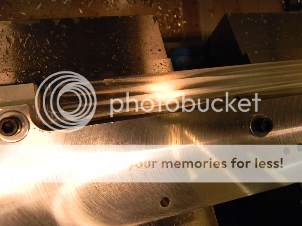

A fixture designed to sandwich the blank. It holds the part up clear of the swarf so I don't re cut chips and so I can run the end of the cutter down below the cut.
21.jpg~original

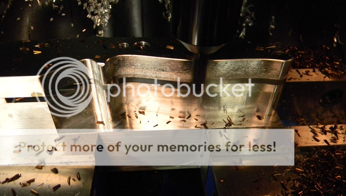

This is pealing 1/8" per pass, full depth, on Elmax at 36 IPM and 3600 RPM.
22.jpg~original

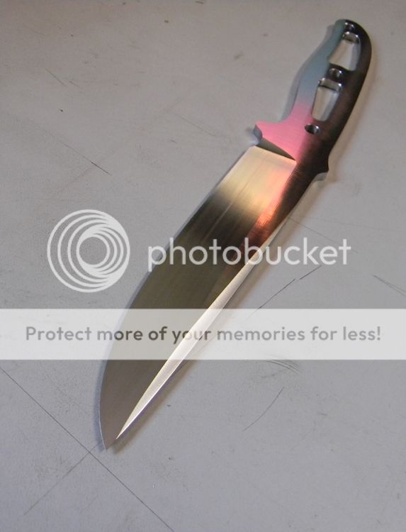

It still needs the clip cut, but a person could mistake that for a knife.
23.jpg~original
This is posted by request. It's the full cut, rough and finish from the beginning without editing. It's a little dull...
[video=youtube_share;igVlgQWcFVc]http://youtu.be/igVlgQWcFVc[/video]
I slow it down when I get close to the final part shape and move at a craw when finishing so the Old Grey Pig can keep up.
I'm roughing dry because the cutter holds up better that way. I turn on the coolant for the finish pass because I'm moving pretty slow and not throwing chips very well so the coolant prevents re cutting fines.

I did a similar WIP thread here in Shoptalk about a year ago. This particular WIP was created over in the C&H forum where I was hoping to show some of those guys how I work, but it got moved over here. It's a little redundant here I think. Oh well *shrug*.
Now that they have moved this thread here I feel a little silly finishing it. You guys here already know how I make knives so it seems a little pointless. However I did finish photographing the steel milling process yesterday so I may as well post it. This was never really intended to be a "how-to" thread, the target audience for this had been the custom forum.

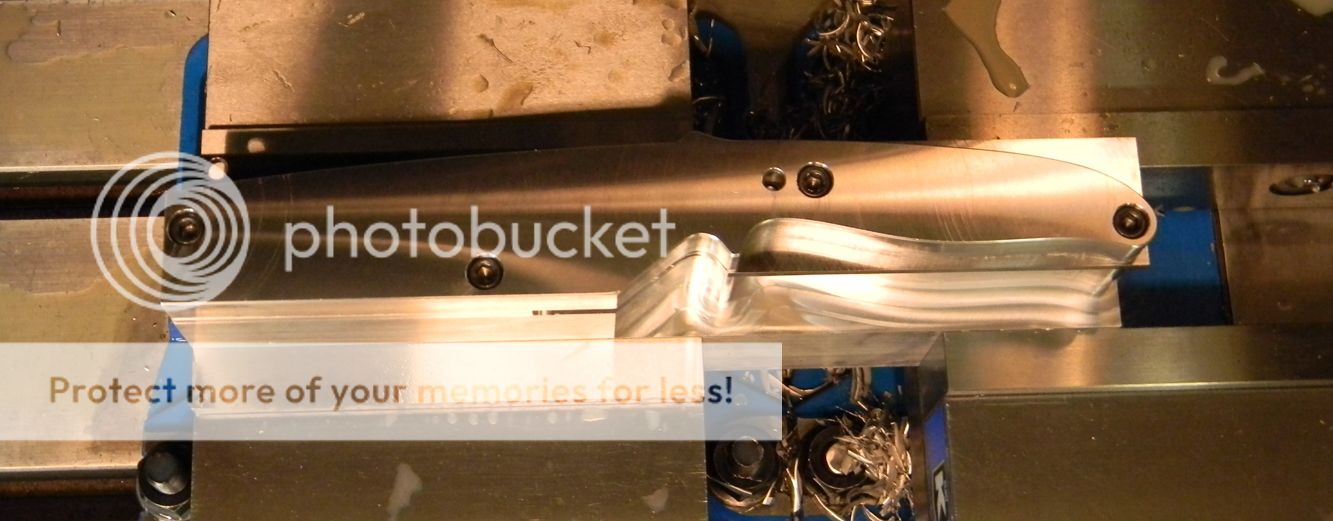

A fixture to hold the blade while milling the clip.
24.jpg~original

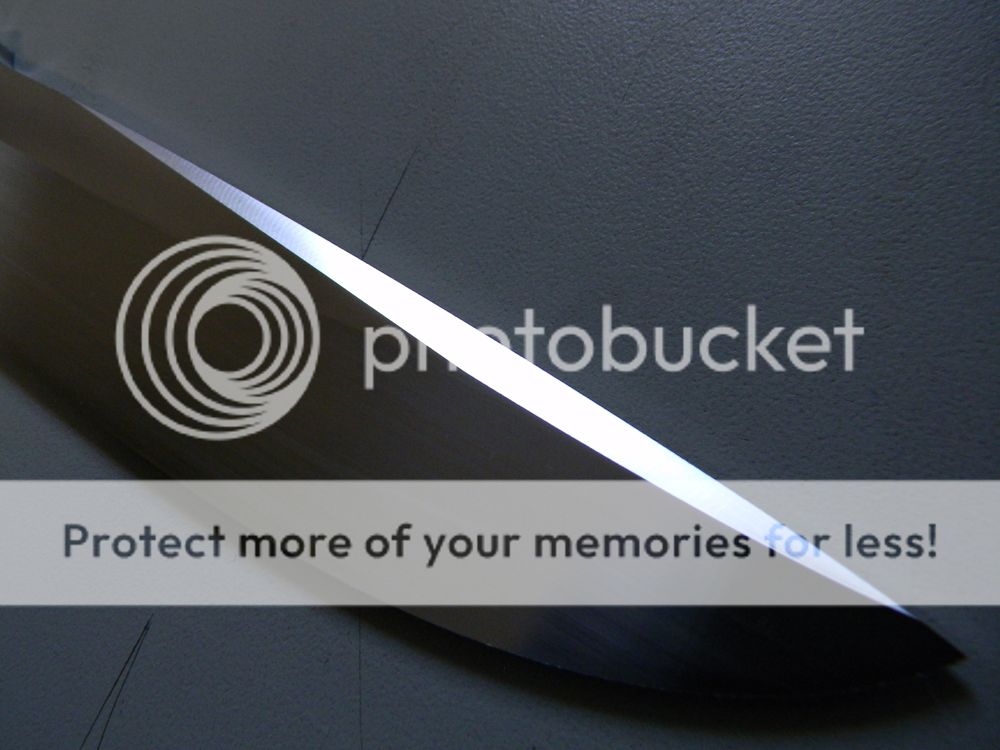

Detail shot of the area to be cut
25.jpg~original
Cut
26.jpg~original

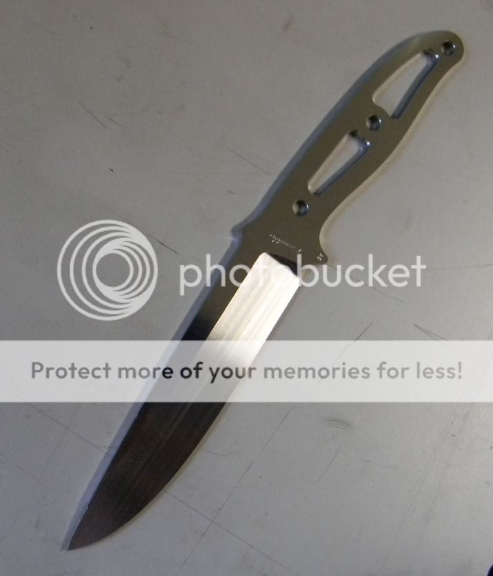

The finished clip
27.jpg~original
29.jpg~original
And the finished milled blade ready for heat treat and tumble.
28.jpg~original
