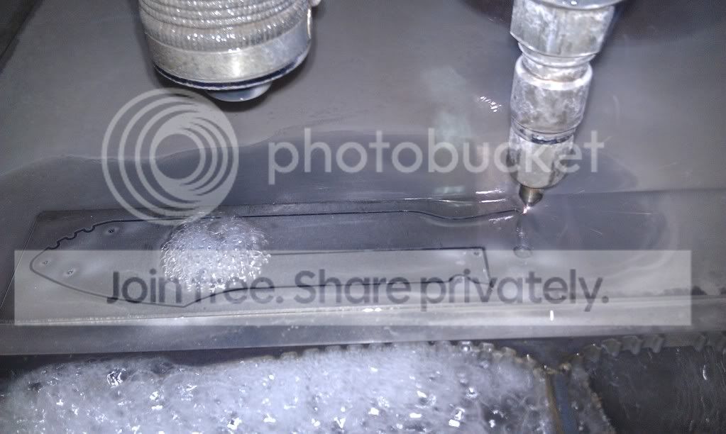

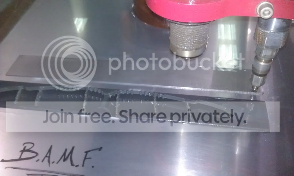

Well the water jet cutting is all done. I should get the parts back in the mail by Thursday. Here are some more pictures.
