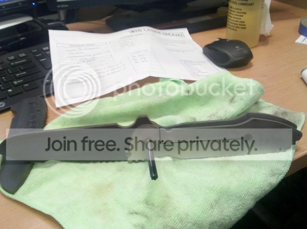

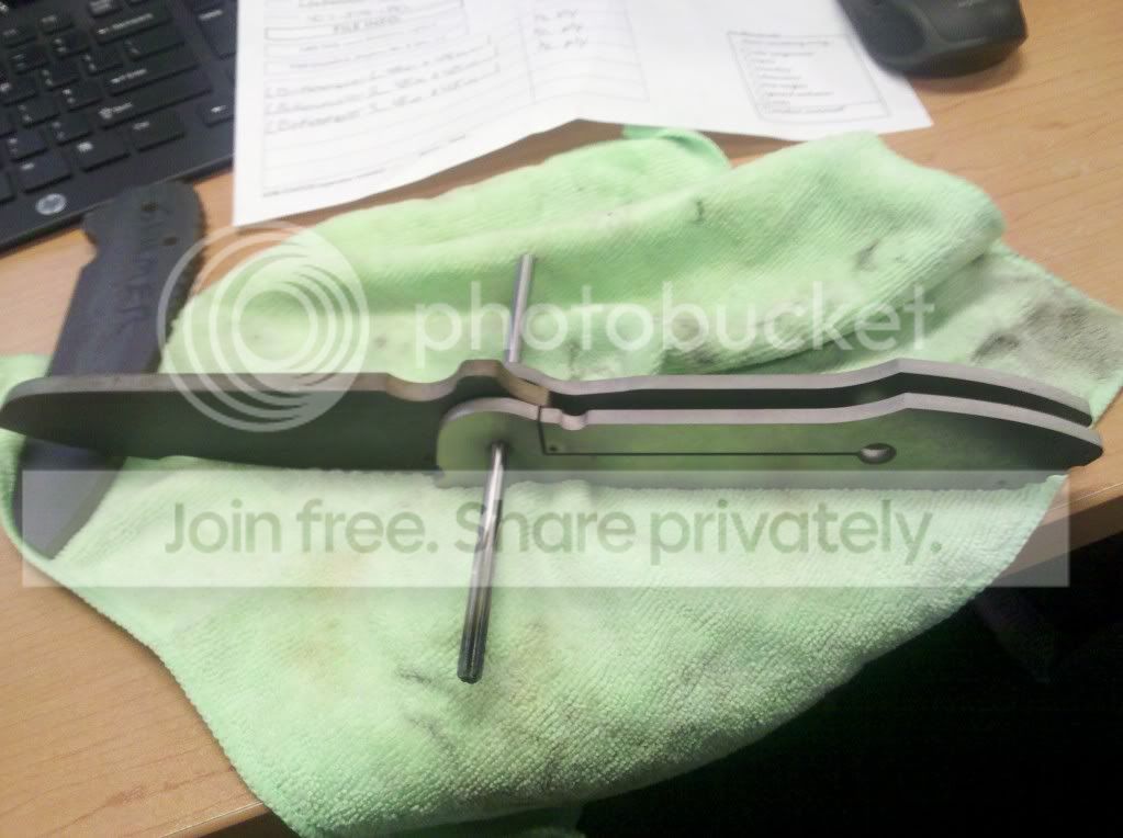

The water jet parts came in today! They look perfect, all dimensions are just a hair undersized just how i like it. I'll get the holes reamed true this weekend and counter-bore the blade for the bearings.

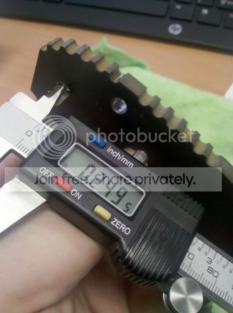

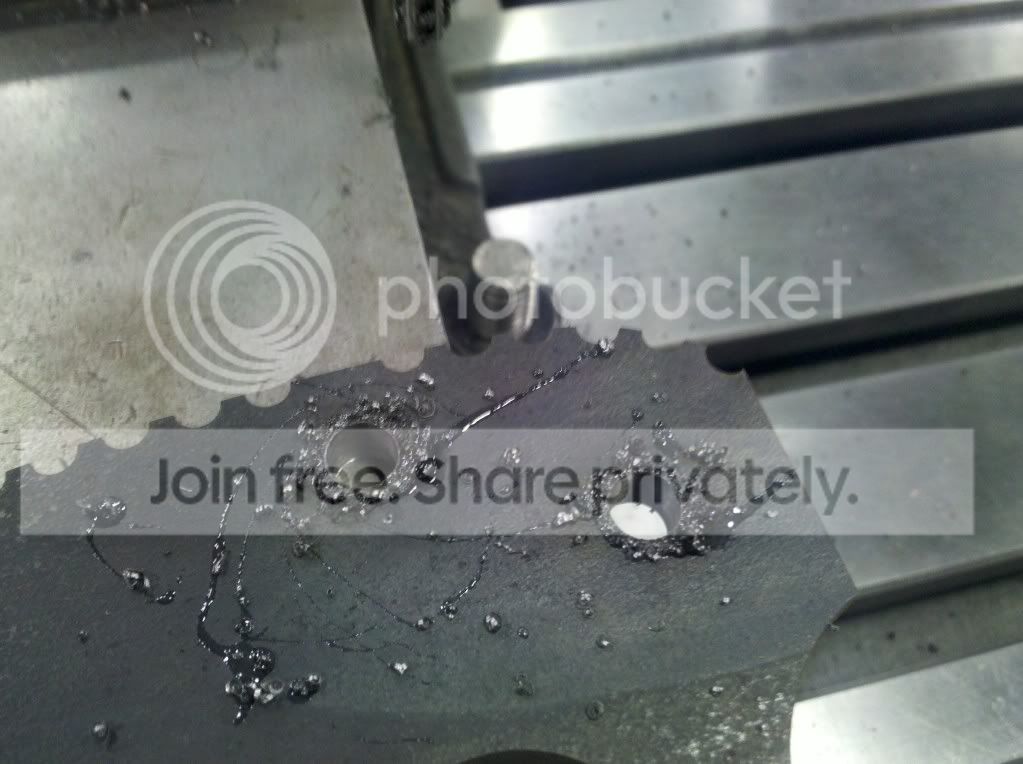

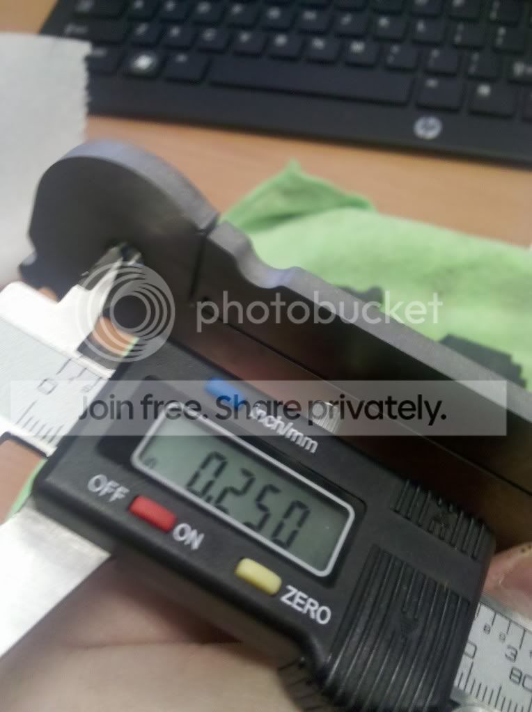

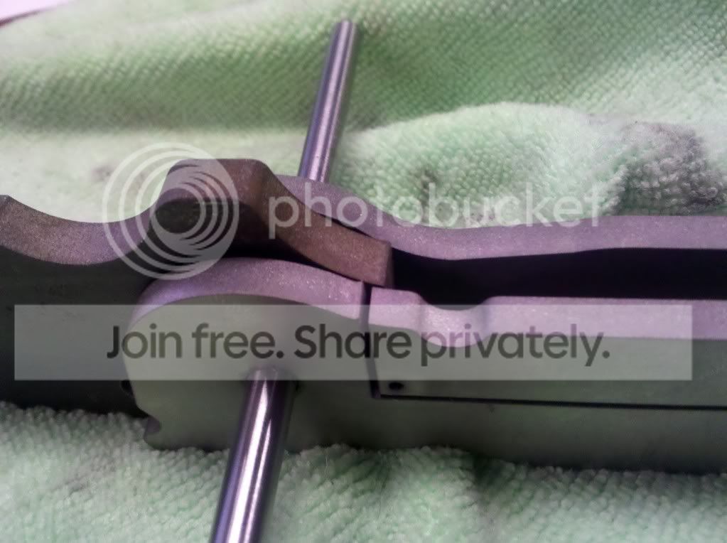

OK so an update! Got out my .249 cobalt reamer and reamed the pivots and thumb stud holes on both the blade and slabs. 5160 machined like butter but the .190 Ti was a real slow process. I went ahead and ordered an undersize .249 solid carbide reamer so the production models go a lot easier. Checked my work with the trusty caliper and its perfect! .2495 on the blade and the slabs opened up a hair to .25" dead.
Next I'll counter bore the pockets for the bearing system... stay tuned.
