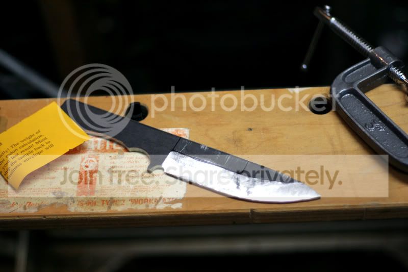

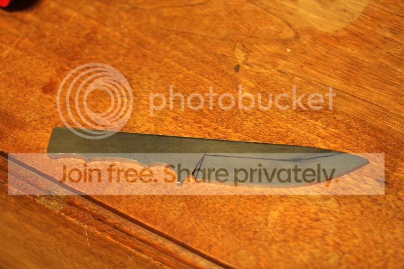

Many thanks to Kevin for hooking me up with a chunk of 1080 (or is it 1084?). I don't really know why I chose this type of knife, honestly I don't even know what "type" it is. I just saw something similar online and though it would be a good first attempt. I bought a few Nicholson files from Menard's (10" half round bastard, 8" medium mill file, and a 8" medium round file) and used a drill and a hacksaw to get the general shape before carving into it with the files.
Let me know what you think.
Home brewed beer + Home brewed Knives = Awesome

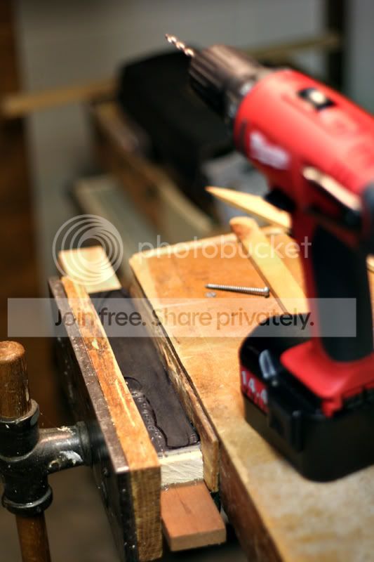

Doing some drilling and then hacksawing. Do most people use band saws for this? I know I killed my drill bit so I need to get a carbide one or something.

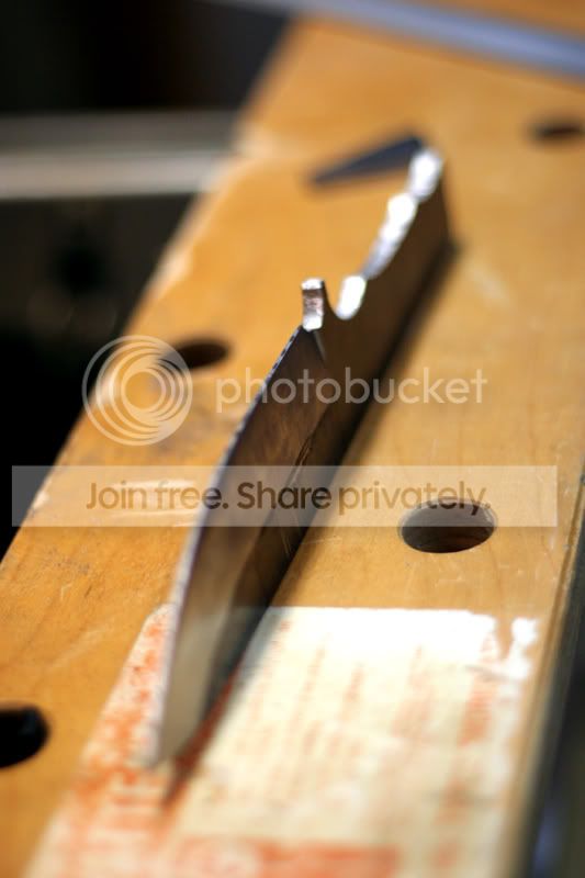

General cut out shape. At this point I decided the blade was too curved. I don't know why I planned it out like that at the beginning but it didn't look right.

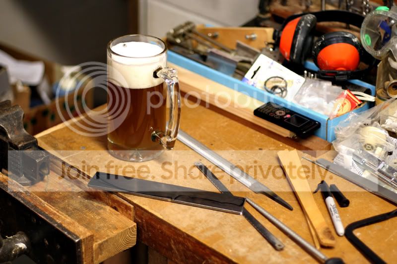

Final basic shape.
Tomorrow will be finding sandpaper to smooth things out and attempt to cut the bevel (is that the right word) for the blade. Kevin recommended finding a pieces of hard angle iron or something like that around 7/32" or 1/4" and place it behind the blade so the file can rest on top of it for an even angled bevel. Well see what happens.

I would leave more steel at the bottom of the handle near the butt, and "drop" the top of it. A handle that straight is uncomfortable in my opinion. Other than that, I like your design.
Maybe I'm alone, but I liked the original slightly curved edge better. I find that type of edge slices and whittles very nicely. To each their own! :)

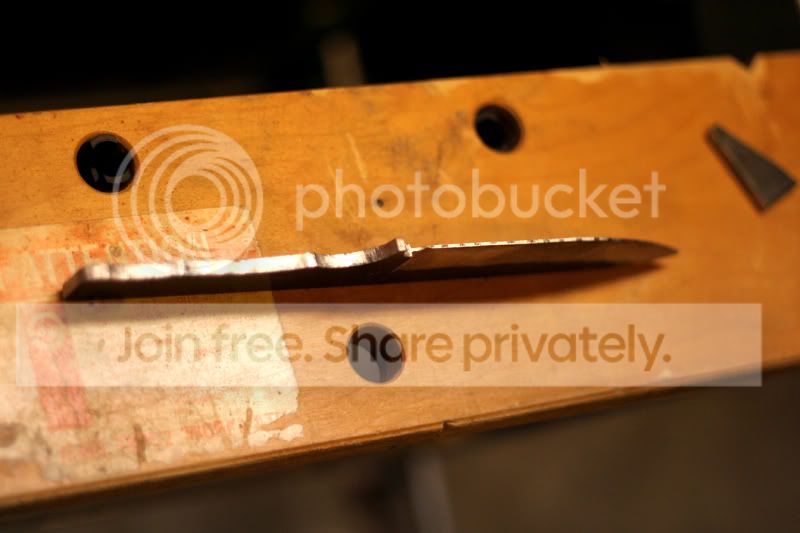

Oh man, I've been beveling for an hour and a half and kind of have one side done. Doing this all by hand is no easy task. I'm taking a break for hot ham and cheese. Pictures to follow shortly!
(Tettnanger hops is what is in the wheat)

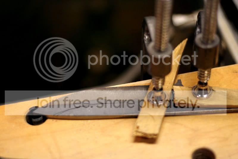

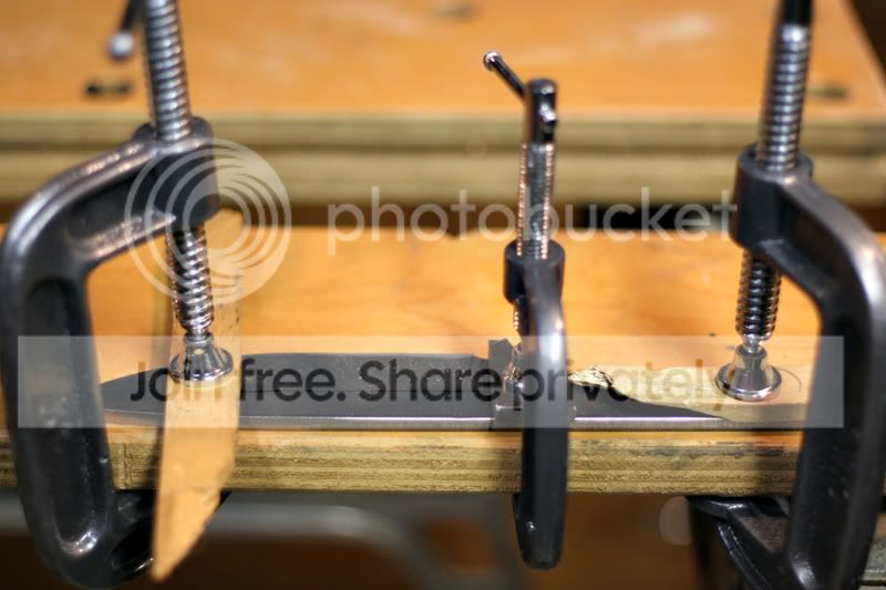

I'm done for the night. Got the basic shape for both sides done. I still need to step down to a less rough file and do some sandpapering, but its coming along. I can see why people use belt sanders. Its pretty hard to get an even edge freehanding it.
Keep at it, and try to keep the bevels even all the way along the edge to the tip. It doesn't get any easier to fix if you wait till later... ask me how I know. ;) :o
I would love to know how. Getting it even is one thing that wasn't working exactly right.
Draw filing is your friend here....Trust me, it's not easier to stay even with a grinder, it just allows you to screw up faster ;)
Clamp the blade with the point facing out towards you. Take a single-cut file (bastard at first, mill after that) and hold the tang in your left hand and the other end in your right, like a drawknife or spokeshave. Pull the file evenly across the bevel from plunge to tip, keep your angle even through the stroke. Make sure to clean the swarf from your file every few strokes. The file will only cut on the pull stroke, not the push. This is the reason for having the tang to your left. If it was to the right you'd be cutting while pushing which is harder to control and can lead to injury if you slip and stab yourself on your new knife ;)
This will help you to get things flat. If you want to see how you're doing for flatness, paint your bevels with dykem or a black magic marker and then make a few strokes with the file. You'll see the highs get cleared off and the lows remain. Keep using this as you work until you flatten out the humps. Then move to a finer file, than to sandpaper.
