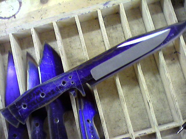

Got all the blades drilled, chamfered, and ready for grinding the bevels tomorrow. Oh yeah!
I didn't have time to take good pictures with a decent camera because I was busting my ass to get done. Here are some quick pics I snapped with my phone.
Here you can see they are all drilled and chamferred. Also we grind what we refer to as "the 45's" on the blade blanks. That's an approximately 45 degree angle we grind at the edge first with an old belt. The reason we do this is because we grind edge up and the sharp 90 degree angle of the steel would knock too much of the grit off the belt right off the bat and wear them out quicker. This way, we greatly extend the life of a belt.
Next is grinding the bevels till they're ready for heat treat. The trick to this is that you want them ground enough that you don't have to work on them forever when you're doing your finish grinding, but you also can't do them too thin or the edge could warp during the heat treat process. I do mine pretty damn thin these days. I've checked for what thickness other makers grind their edges to before heat treat and before they put the final edge on the knife. Surprisingly, Andy and I both grind our blades down to the same thickness for heat treat that a lot of other popular knifemakers do when they're ready for the final edge. We be makin' some slicers yo. The grind height is going to come up a little further when I'm doing the finish grinds, but not by much. These Bush Operator XL's are going to be some STOUT knives, but still able to slice like a champ. Here you can see how high the grind came up, about halfway, before heat treat. Also, you can also see how thin I grind the blades before heat treat.
