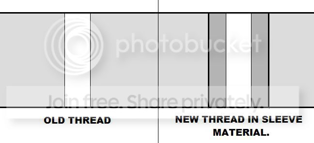

if it did strip out you could just drill it out a decent amount more to accommodate a sleeve with a harder/more wear resistant material...I've done this on old equipment like this a few times, in one case I drilled and sleeved plus made a new bolt in a more common size. Like your issue we could not find a tap with the same pitch and size anywhere to attempt a repair and a thread file wasn't going to work.

Robert, your talking like a helocoil?
no, I'm talking a sleeve of new material...you can thread the new sleeve in for extra strength but the stuff i've done was press fit as their was no shock load or stress going on the sleeved area. Helicoils i'm not really fond of except when working with aluminum.
here is a basic diagram of what I mean, if any shock is going onto that bolt I would have run a coarse thread on the sleeve and tapped out the drilled hole with that same thread and once in place put a few peens to keep it in place or silver solder into the sleeves thread.
Many ways to get the job done.
