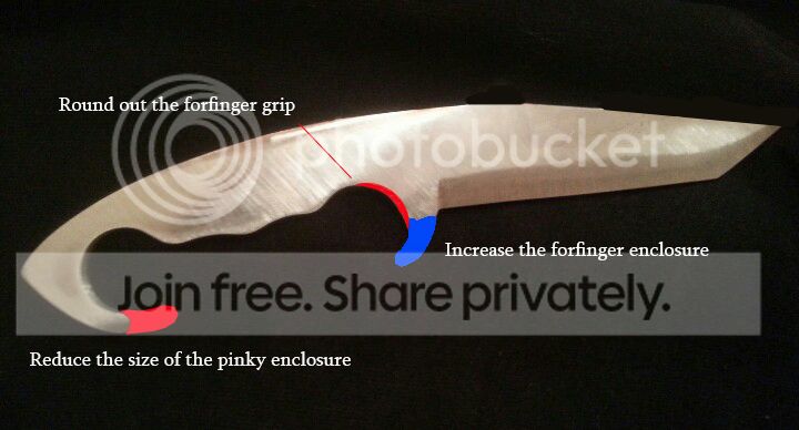

Here is the blade roughed out. 3/16" 1095 blade steel, will have micarta scales and a flat grind with about an inch of serrations and a nearly sharp top edge. (Ignore the minor cutting in, that's not there to stay by any means...) Sheath will be modular and a kydex and aluminum combination with blade-tech MOLLE-loks. He specified the finger grooves as well as the glass breaker type tip. Will be differentially hardened by me, and may ask for a little advice when it gets to that point. Final finish will be black oxide coated...

Hello,
Ok so I am posting an edited picture describing my design changes. I am not a fan of having fingers enclosed for obvious reasons, especially in a tactical knife but I think the changes are a happy medium. I also am a big fan of the Tanto style blade so I like that about this design. I also added a little more metal to the forfinger partial inclosure. I am still very new to knife making so if my suggestions are off or don't make sense, could you please explain why?
What if they used it as a glass breaker and smashed the pommel into something hard, wouldn't their ring finger slide right into that pointy little tail that's covering the pinky?
I like it better with a dorsal fin (glass breaker, or whatever it was). I do like the extended forefinger enclosure.
"Dorsal fin" is there because he rides the spine with his thumb during certain blade forward techniques. Index finger is not extended like that mainly for sheath retention and easy of draw reasons that will make more sense when I post the sheath. Added area on the back of the blade near the tip maximises frontal area giving it a spear like effect... I can go thinner and keep the permanent wound channel... (sorry, but remember what it is intended to do...) Believe it or not, we did a few trial runs with tac gloves on before settling at that much pinky / index coverage. Remember the knife is used both ways... Fingers in our hard shell entry gloves are pretty well protected.
Sorry if none of this makes any sense. I appreciate the input but the design is set. My concerns will probably be with just how hard is hard enough in the glass breaker region and the blade itself. I would prefer the finger guard to break away rsther than bend and crush a finger so I would think full hard in that area.
Sheath is going to be basically a kydex and aluminum sandwich with level one retention. It will have a kydex protrusion that engages the guard area (blade side guard, not the pinky one.) The dorsal fin and extended spine of the blade also assist in the way the knife settles into the sheath. I hope to do a skeletonized demo here during my long weekend and see what everyone thinks. We are basically trying to see if this is something that anyone else would want or if it falls just into his specific niche desires. Like I said, we swapped about 100 designs, drawn, cardboard, wood and even aluminum before he stuck to this... picky picky picky... lol.
Thanks for the input. If I keep making these, or even make more, that is something I will look into. I like your design changes if applied to bare handed use, and they certainly look nice and slick.
