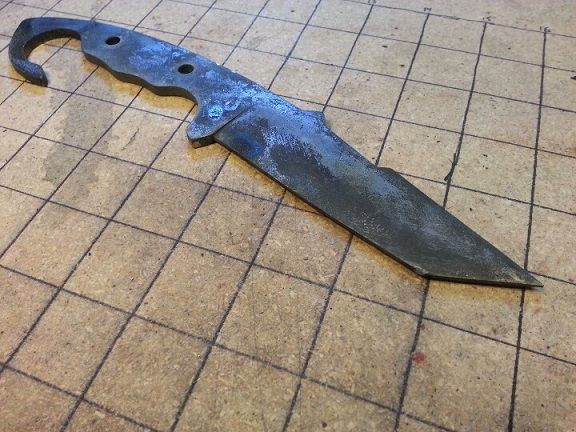

WIP tactical knife for a buddy...
When communicating by text it is always a good idea to assume the other person didnt mean any offense, rudeness or sarcasm ;)
Just thinking on those non-standard uses that these kinds of knives often get...have you considered a hammer surface somewhere on the knife? For use to both bash things and to get bashed to help pre-levering penetration. I imagine there would be a trade off with the glass breaker tho. Im not suggesting you should - just wondering if its worth considering in future designs.
That would be nice to have... If I could fatten up some area there on the hilt, maybe some sort of integral guardish type thing, it might work. I don't know what the balance trade-off would be. It would probably add some time to making it. I had looked at some of the screw-in glass-breaker replacement tips out there for benchmade and whatnot and nearly added one to the 1/4 pry-tool I carry on my vest... which gets used as a hammer almost as much as it does a pry-tool... lol.

Here it is fresh out of the HT water quench... That's right, I quenched 1095 in warmish water and chanced the warping. I was shooting for a good even, through and through and as deep as possible HT so went that route. In its first of three draw sequences at 500. It finally has the flat grinds on it as well, so NOW you can feel free to comment on the bevels, lol.
I left the pommel alone at this point, and will most likely come back in with localized heat (torch) and HT the pommel to high RC hardness. I would prefer it to be brittle in this particular area to some degree, as I am shooting for it snapping and not bending and trapping a little finger in the hole. This was the advice gleaned from two other very knowledgeable sources, and they seemed to concur.
The grinds are long and flat, and retain the thickness of the sping (3/16") all the way to the tip, The tip has been left intentionally thick and not ground to its final angle (as in relation to the edge of the blade, or vertically speaking) as I don't want to burn up the tip at any point in the process. It will be taken to final point by hand, as I do with most of my blades...
The micarta scales are coming along, and will be held in place with 3/8x1/4" Chicago screw type fasteners (though they are a grade 8 iteration sourced locally and will be black oxide coated.) Everything will be able to be easily disassembled, sheath included, for proper cleaning and decontamination. CS/CN powder and whatnot has a tendency to get in every little crack and come back to visit at the most inopportune times... lol. The sheath is also coming along and will be able to be mounted in a variety of configurations.

Well crap... Been working with 1095 for a bit now and thought it was fairly predictable.... lol. Never too old to learn humility I guess.
Anyway, after tempering I get to the bench to start a little more work. Then I notice the slightest, I mean absolute hair of a bend in the tang... Dammmitalltohellenback!
Anyway, fired up the forge, straightened her out, normalized it, etc. Now its finally heat treated and tempered, straight as an arrow... (this time I checked in between!)

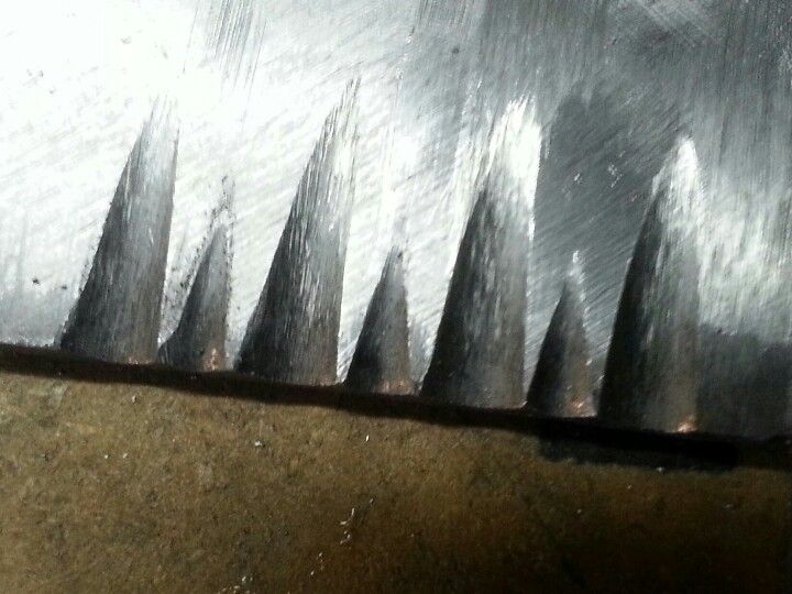

I am in the process of adding the required serrations to the blade... Just a little input if you all don't mind. I have cut in one side, and wondering if I should do both sides with the serration cuts or one. I don't particularly like serrations (well at least partial serrations) myself, although I do know how handy they can be.
I have not seen a whole lot of serrations cut from both sides, however it isn't all that hard to do, just reducing the angle of incidence between the two sides. The reason for asking and even wondering is purely aesthetic. I know it would work just as well (maybe better?) from one side. It is an alternating pattern of small and large serrations cuts at this point... And they are VERY rough at this point as well... It is going to have a very unique blade treatment once it is done that will highlight the serration cuts BTW.
I would do serrations on one side only. I would do ripper teeth on both sides. Those look more like ripper teeth so far.
Don't have anything constructive to add, but that is one serious knife! Gonna be a sweet one.
They may be a bit misleading at the moment... there is more grind up the bevel than will be there shortly. There is a little more material to remove as I am trying for a bit of a unique transition. The actual serration will only be minor intrusion past the blade edge. About 1/16" at most on the larger cuts, 1/32" on the smaller. I can see where you are coming from and may go that route. It would fit the overall aggressive look of the knife...
