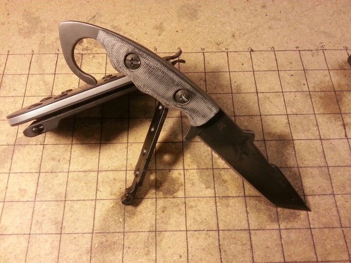

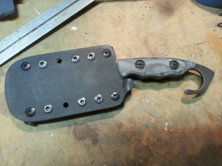

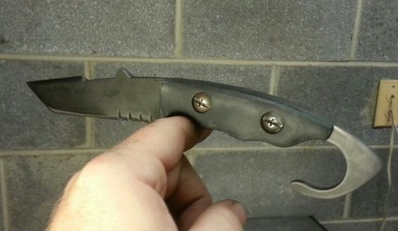

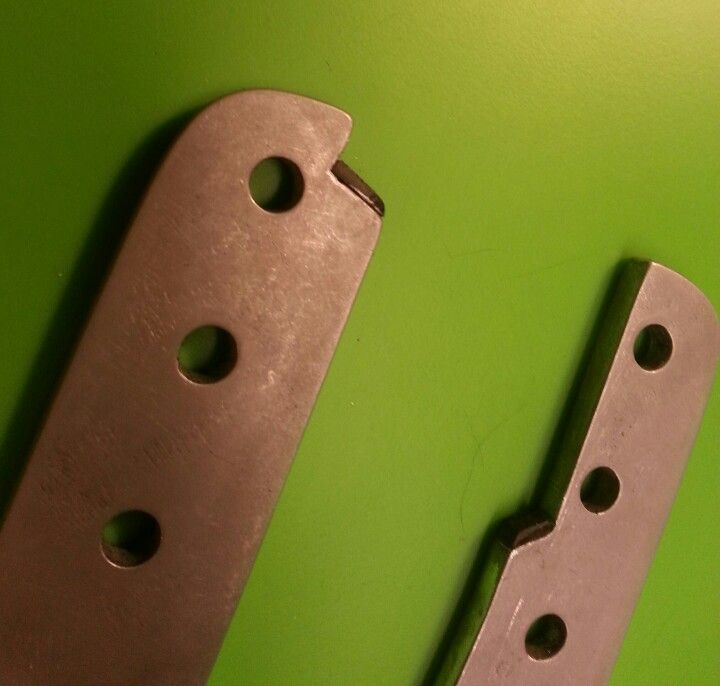

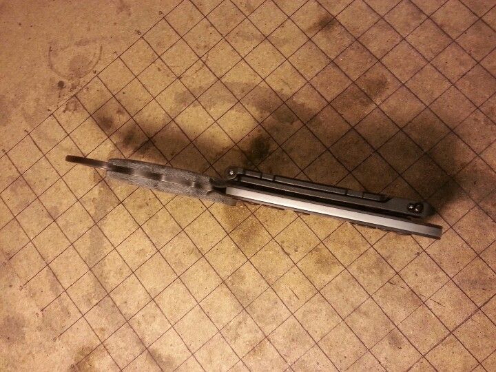

It's getting there slowly. My free time to work on it has been slim lately. Here is a picture of some of the sheath fitment work provided it attaches ok. Ignore the weird colorations and stuff, some of it is smeared sharpie, some is tumbler crud (wd-40 and metal bits...). It is probably apparent what I'm shooting for. It is basically an aluminum center section with kydex sides. It uses blade-tech MOLLE locks and the holes are spaced to allow a variety of carry options. The sheath indexes on the spine for the most part. I made sure the areas where the tip of the knife and the lower angle of the blade edge dont ride on the aluminum. That said, this is very soft aluminum by most standards but very flexible. The kydex will be fit in typical fashion to lock the knife in.
The rough scales are also in this pic. They are black/grey canvas micarta and completely removeable. I am rounding over the edges of the tang where it meets the scales in the event the scales are ever swapped with paracord.
As stated previously the focal points for the sheath were easy decon/able to fully disassemble the whole mess, and also variable mounting positions.

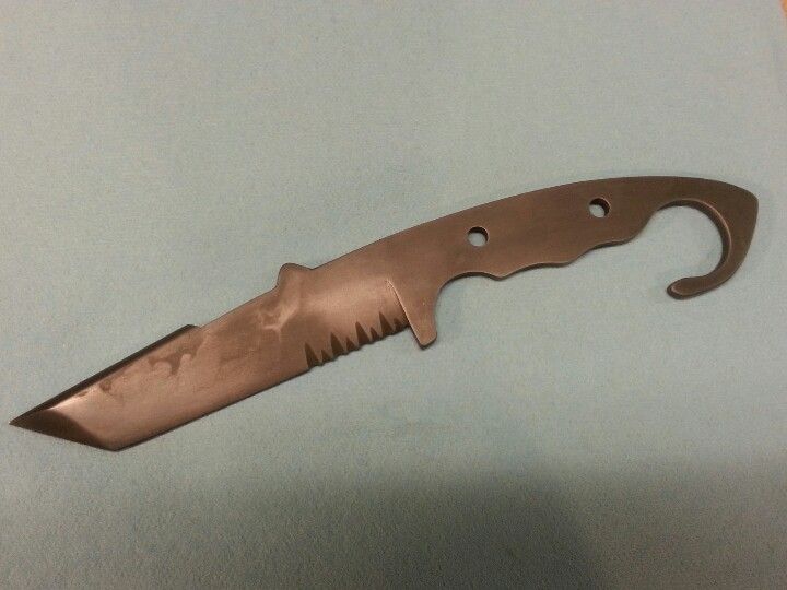

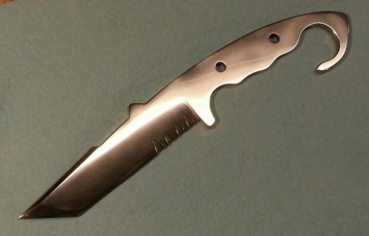

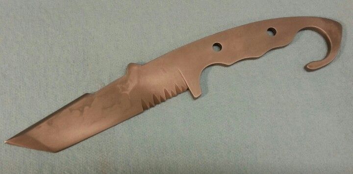

For anyone still following this at this slow pace, here is the blade finished to 320 grit all over and s couple of areas like the plunges and the rear hook finished to 600 grit and cleaned up. As you can see, the serrations up the bevel are much shorter after final grinding. They still need to be finalized but I will do so after the final edge is established.

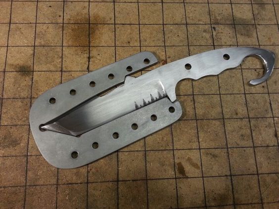

The aluminum core of the sheath is nearly finished except for a little protective material on the blade contact surfaces to keep from smacking aluminum upon reinsertion. The finish is a media tumbled finish and may be chemically blackened prior to assembly depending on how bad the color sticks out...
Here is a pic, similar to the one above just a little more to go

I have $0.14 worth of unasked for advice ;) It might just be the lighting, but the finish on the inside of the pinky lug looks kinda' funky. Even if it's not (:foot:) I have an easy way to finish areas like that---
You can rough it in with either carbide burrs or a small drum sander and a rotary tool.
Then to smooth it out and true it up... put the blade in your vise so the hook/lug is pointed down toward you. Take shop cloth and rip it into strips that are only 1/8" wide.... then "shoe-shine" away. You can put a perfectly smooth radius inside, and easily take it up to a mirror polish if you want, using this technique.
The key is ripping the shop roll narrow. If you try to do it with the shop roll even 1/2" wide, it will just dig in on the outer edges. That will take longer and never give you as smooth of a surface.
You can also use sandpaper, but you'll have to stick Gorilla tape on the back side and then slice it into narrow strips. :)

Thanks Nick, it is in fact the lighting. I did exactly what you describe to true it up and round it out... :)
That area and the plunge are 600-800 finish so they are really shiny, as opposed to the rest of the blade which is at 320 in that pic. I will try to take a pic tomorrow evening as everything is at a clean unidirectional 800 grit now. My shop lighting sucks for pics, but is great for work. I have three portable lights that are on flexy stalks with CFL bulbs in them as well as GE Reveal bulbs in fixtures above the work areas. Then I have two long florescent lights above and at an angle to my work areas, I can get zero shadow with them all on. I try to use the GE Reveal bulbs for pics, but use my cell phone camera for these so it doesn't show up as the best pics ever... Haven't broken out the SLR for this knife just yet.
I will admit it took a few tries to come up with a good way to get the inside radius, the angle and radius of the glass breaker, and the rounding of the edges of the tip of the hook to all look symmetrical. Cartridge rolls in different grits roughed it in basically at little angles, then a soft arbor on the rotary helped me blend those angles. Then I broke out the shop roll and cut into strips and did exactly what you described. I too discovered that anything wider than about a 1/4 of an inch does start to eat on the edges of the abrasive as you follow the radius. I have one of those 360 vises and use it all the time for this kind of stuff, easy to get the angles I need...
I may be going too far with the finishing on it as it is getting black oxide coated anyway, and will be etched prior to that, but my plan is to go to a smooth 2000 before etching it. I want the etch deep enough to hold the oxide coating and resist scratching, as well as ensure a reflection free surface, but still smooth enough to really show the detail in the angles and everything. I am a little concerned about wear on the sides of the blade from repeated insertion and removal from the sheath, but don't really want to line the kydex with alcontara as I usually do for holsters. It seems to hold contaminants, and it is needed to do meth lab duty as well, so will have to be decon'd quite frequently. I am afraid the alcontara would make wet decon nearly impossible.

I might have missed it, but what's the purpose of the aluminum spacer in the sheath?
It makes it a three piece sheath. The outer layers are kydex and there are the typical tabs at the top that lock it in. Being made this way, the knife and sheath can be easily decontaminated and can also be configured to ride on MOLLE gear in a variety of angles. Meth lab service and chemical agents are used a lot by us and complete decon is sometimes difficult. I used aluminum in the same width as the blade for a nice uniform fit. And aluminum because it is stronger than the alrernative. It makes a nice solid click when its all together and inserted in the sheath, and this positive notification that it was in the sheath was a requirement. We also tend to place both guns and other weapons (sticks, knives, tasers) back in the holster/sheath with a little 'enthusiasm' at times and the aluminum should also hold up to this well.

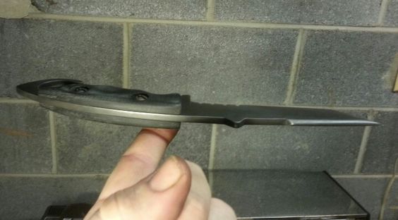

Here is a crappy picture of the knife in the sheath as it looks from the front. This was again during sheath fitment, however gives a good idea of the finished product.
And here it is side-on. The scales will be just a smidge thinner when completely done. The taper at the rear will be more acute, and the edges a little bit more round. Again, the edges of the tang are rounded as are the edges of the scales so they will not appear completely flush. I left the edge of the tang just a tiny bit above the edge of the scales to give a nice uniform appearance. I think I mentioned it at some point, but I left the edges rounded over in case he every wants to cord wrap the handle instead of using the scales.
FWIW the Blade-Tech MOLLE attachments come with rubber spacers. They are on the sheath in these pics, and probably will be when mounted to an entry vest to keep the knife out away from the body armor, but without those being used the sheath is nice and tight up to whatever it is mounted to. I have also made a couple of belt loops that can be used with the sheath.

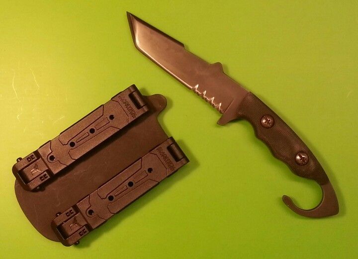

Well, I was going to wait until tomorrow, until after the actual photo shoot was over, to post anything. But, I couldn't wait... IT'S FINISHED!!
I would like to say a HUGE thank you to everyone who provided feedback, kind words, and suggestions along the way, it is much appreciated.
I won't be undertaking another build with this much R&D for a while. It flat sucks to cut, grind, etc etc etc blanks out for the sole purpose of destroying them. I understand why it needs to be done, especially with a knife that absolutely cannot fail, but man it sucks because you see each one as a possible finished knife... Sorta like killing 3 turkeys just to have a little taste test so you know the 4th one will be fit for Thanksgiving...
I apologize ahead of time, as always, cell phone pics again... Sorry, I am breaking out the real camera tomorrow to take some pics with the entry gear and whatnot. I am planning on making a short video too demonstrating some of the unique features as they relate to manipulation of the knife.
Anyone following this thread knows the knife specifics, so here's the payoff. I did a couple of little things, there was a little bit of refinishing that was done since the last photos. We decided the visible hamon, while cool to knife nuts, might not be understood by the rest of those I want to market this thing to. Therefore I subdued it a bit more. It is still slightly visible, just not as much as before, and appears more like a finishing technique than a hamon. I sanded away the factory texture from the kydex and smoothed it out with a little heat. I have found in the past with some holster applications that this makes for a neat looking and feeling surface on the kydex.

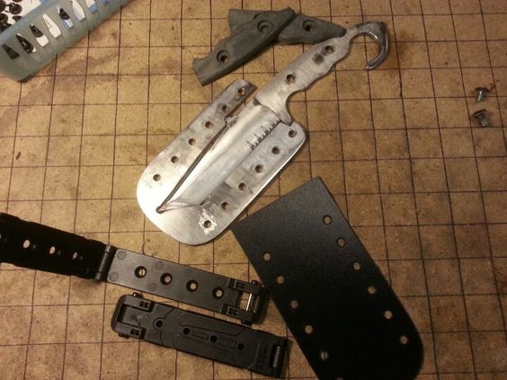

I had been asked about the knife riding against the aluminum inside the sheath. My plan was to buffer that somehow when we started out. I ended up using kydex as a contact buffer on all the areas that contact the aluminum. This includes the 'dorsal fin' as it has been referred to :), and the heel/guard. I also included a thin bit of kydex to contact the raised false edge spine and the front edge (kissaki I reckon).
Below is a picture of everything completely stripped. Everything is hand made by me and bespoke to this application aside from the Gen 3 Blade-Tech MOLLE-Loks (which I would highly recommend to anyone attaching anything to MOLLE platforms.)
